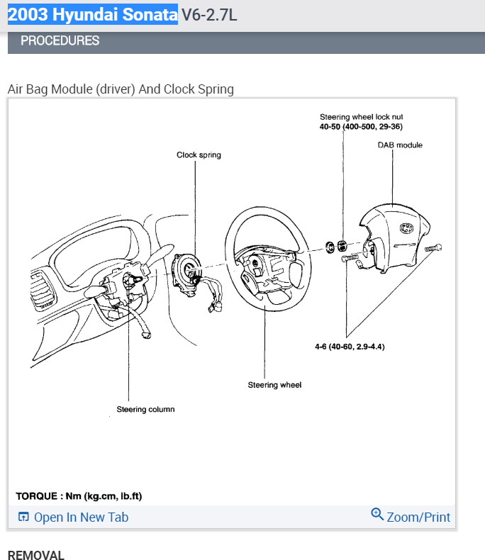

9 times out of 10 it is the steering wheel clock spring that has gone out. but to be sure lets run down this video which shows how to get the codes to confirm that failure.
https://youtu.be/gnSGfEqrf_w

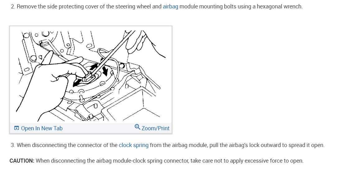

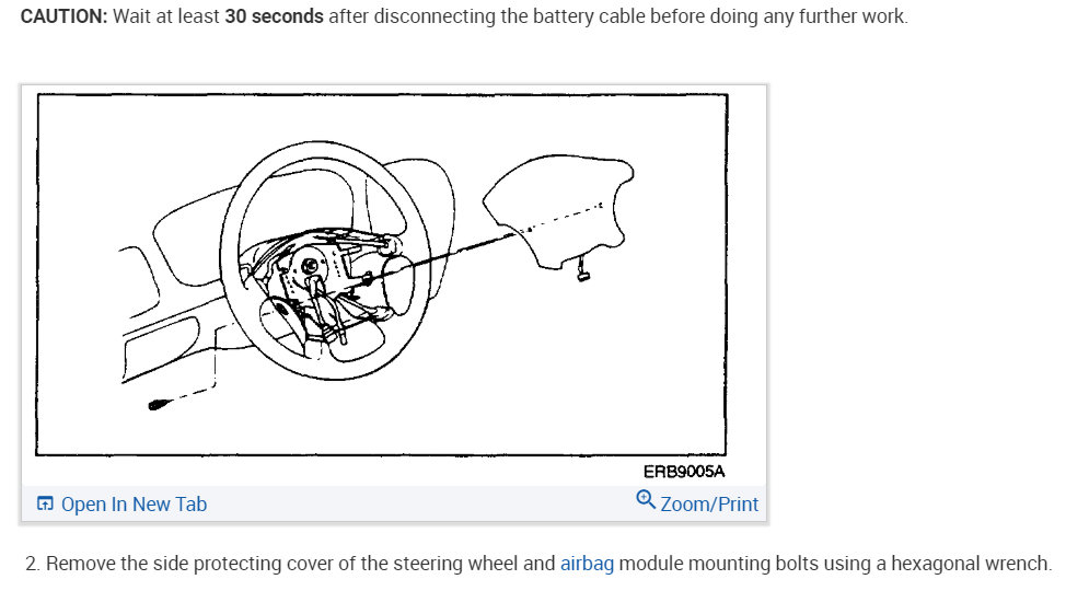

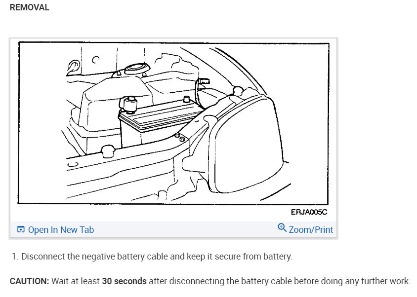

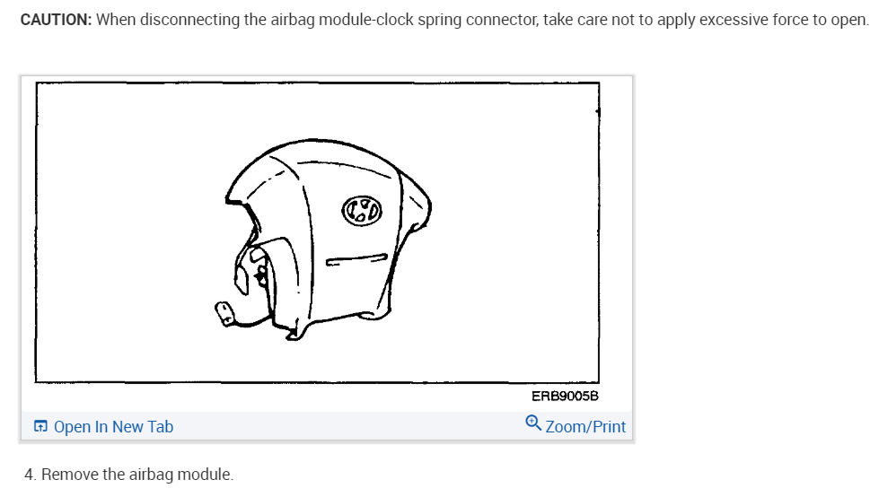

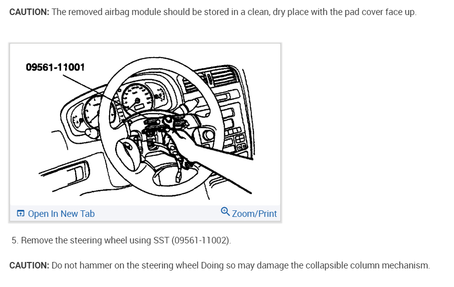

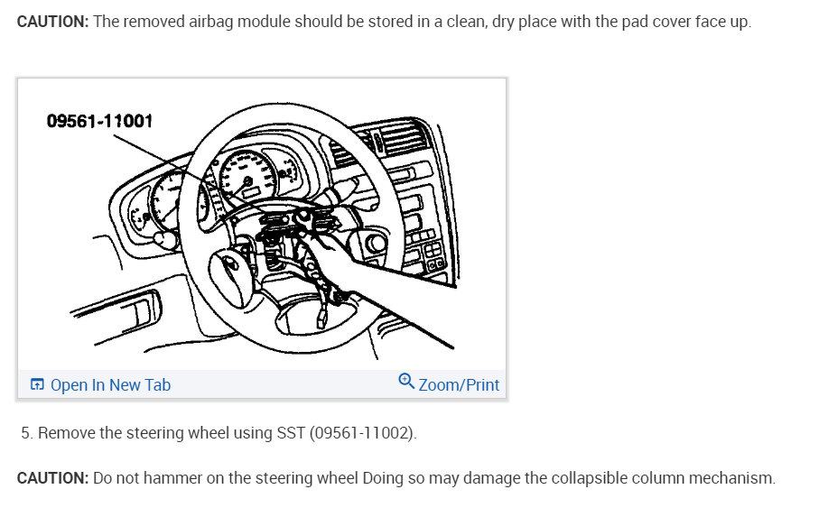

Here is a guide to walk you through the clock spring repair and diagrams below to show you on your car:
https://www.2carpros.com/articles/steering-wheel-clock-spring-removal
