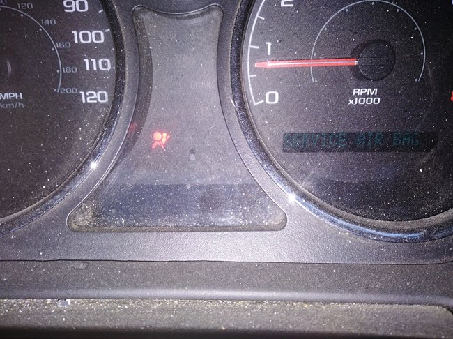

This is what shows on my dash.
*ignore the little yellow U with the ! in the middle. It just means I paid $4.00 four a tire gauge vs paying $300.00. for sensors to be put in the tires.
Dec 4, 2019 at 4:21 AM
Can you upload a picture of what you see?

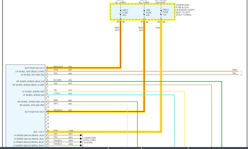

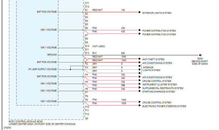

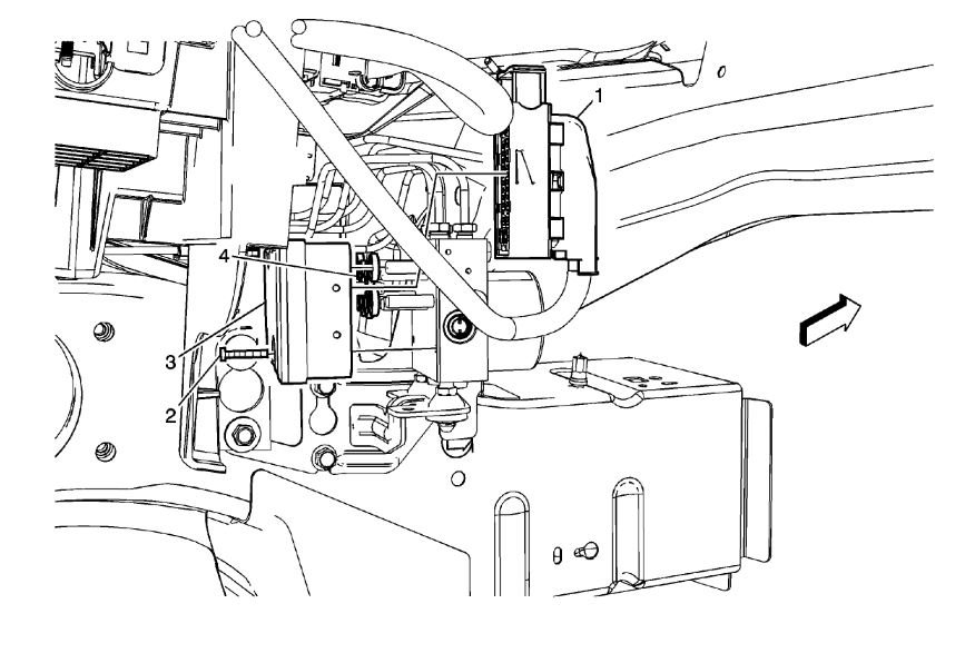

Okay if you have no codes, and I hope their scanner can read ABS codes, then you need to verify powers to the module. If you have all 3 powers to the module, then you need a module.
I attached a picture and a diagram for you to view.

Here's a pic of what's showing on my dash.

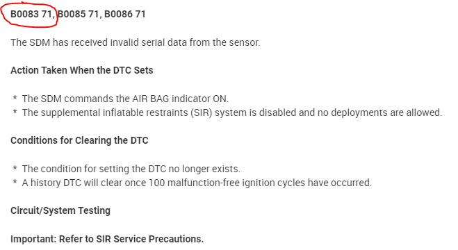

On SRS it says:
B0083-71 (1-1)
Left front impact SENSOR - invalidate data
Dec 16, 2019 at 4:36 AM

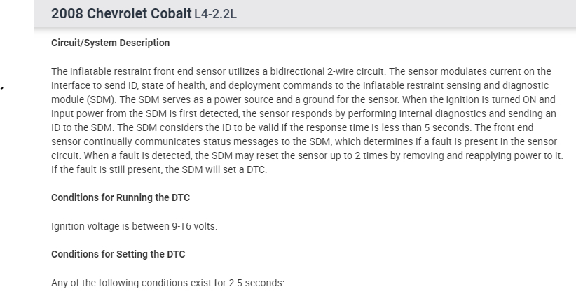

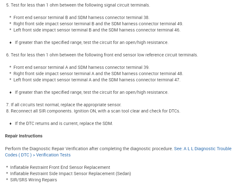

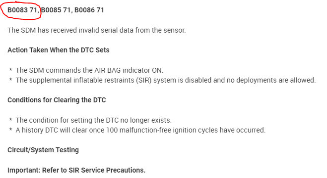

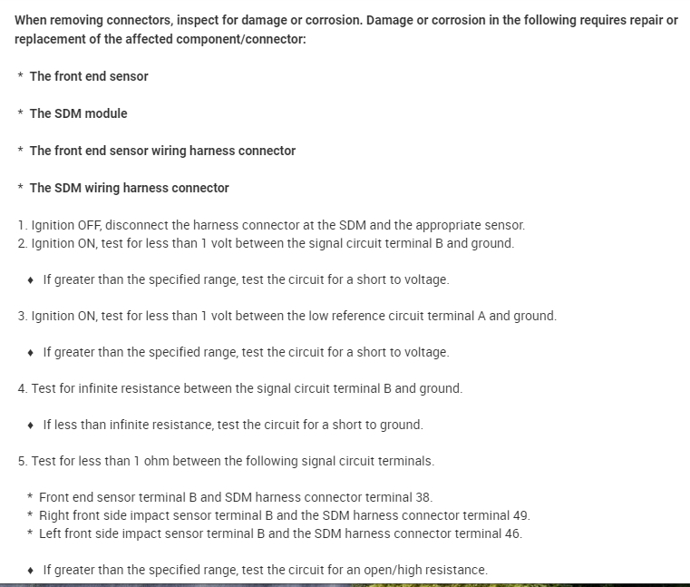

DANNY L
  • 5,648 POSTS
Hello, I'm Danny.

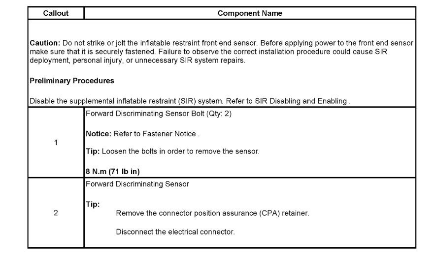

Here is what you will need to do to test diagnose that particular code: This code is relevant to the SRS-SDM (supplemental restraint system-- sensing and diagnostic module) It sounds like you are having an issue with non-communication between the sensor to the module. I've attached step-by-step troubleshooting pictures to diagnose below. Hope this helps and let us know what you find.Thanks again for using 2CarPros.
Dec 16, 2019 at 5:17 AM

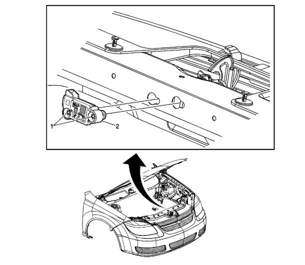

Just to add to Danny's post, the most common issue is the sensor itself. I attached the location and procedure for you.
