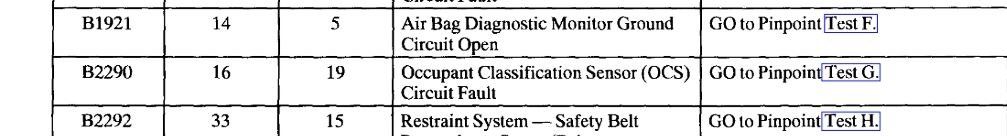

Did you have the actual code checked? You can have it checked for free at a parts store. Once I know the actual code, I can help narrow down the area of failure for you.

The chart below for the flash code and description for you to view.
Normal Operation
The Restraints Control Module (RCM) checks the Occupant Classification Sensor (OCS) circuits for faults. If the RCM detects one of the following faults on any of the OCS circuits, it will store Diagnostic Trouble Code (DTC) B2290 in memory and Flash Lamp Fault Code (LFC) 16 (or higher priority code if one exists) on the air bag indicator.
The OCS system components (seat cushion foam pad, bladder with pressure sensor, and electronic control unit) are calibrated to each other and are serviced as an assembly. The OCS system components are not to be installed separately. If a new OCS system, OCS system component or seat cushion foam pad are needed, a new OCS system service kit (seat cushion foam pad, bladder with pressure sensor, and electronic control unit) must be installed as an assembly.
