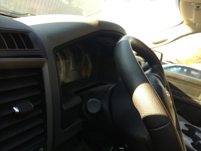

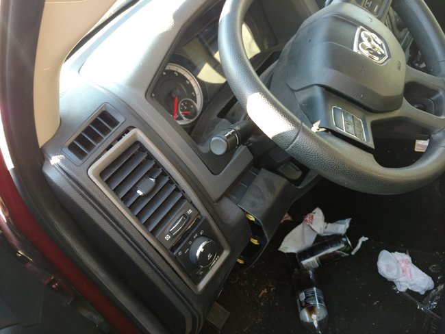

I was recently in an accident, I swerved and went straight into a ditch. Seat belt did not tighten up and the airbag did not deploy. What would be the problem with the seat belt, and could a bad clock spring cause a non deployment of the airbag?

That is what my face did to my steering wheel and column. The body shop working on it said it should have gone off. But no light was on so not the clock spring then?
