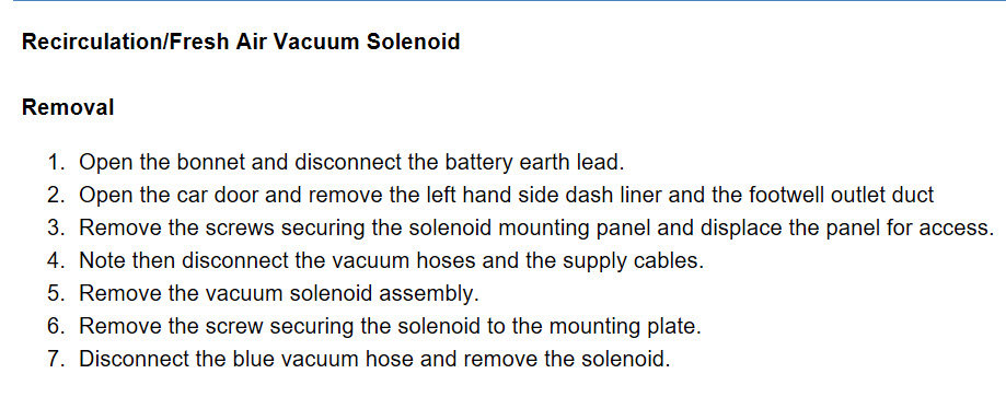

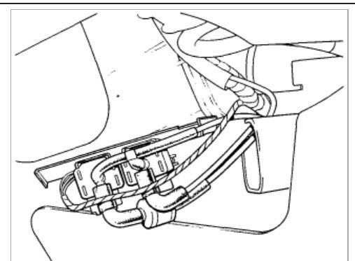

unfortunately we do not have any vacuum diagrams of the heating system. your car does not have a blend door it has a hot water valve in heater hose. I did find a solenoid for recirculate/fresh air which is on pass side here is some instructions and a picture of another solenoid nearby for help as you may find a vacuum line off. See pictures.
