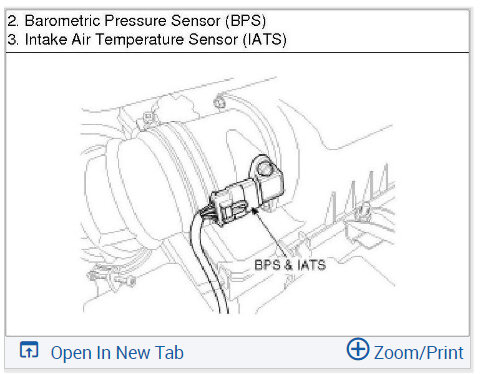

Need to know the location of the Air Temperature Sensor.

The engine air temperature sensor is integrated into the barometric sensor. Here is the location of the sensor. Check out the images (below). Let us know if you need anything else.
