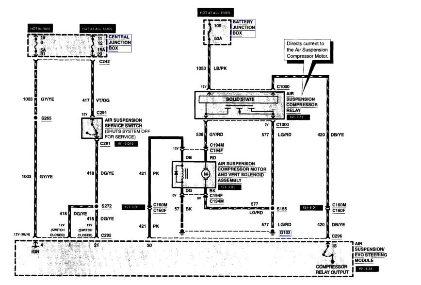

Rear end squatted air compressor pump was coming on then next day never heard it come on not long after check suspension light came on rear end squatted. All fuses are good tried another air compressor pump it will not kick on either, but that pump and the other pump that was on it both compressor pumps only come on if running a wire directly from battery. I tried another compressor pump relay still will not work air suspension switch is on. I do not know what else to do. Would the air compressor pump not come on if the airbags are bad worn out?

I attached a wire diagram for you. Verify power at the fuse listed. It may have failed from the old compressor.

Would the airbag compressor pump come on if the airbags are bad ? Could it be a bad wire loose or wire harness?

The pump should come on whether the bags are blown or not.
Did you verify power?

No, the pump will not come on when hooked up normal. Tried two different pumps even tried another pump relay it was under up near passenger side fog light and headlight. Only time pump comes on is if I run a wire directly from battery, but that way will not raise the rear up should that way raise the rear up? Or does the pump have to be hooked up normal to raise rear up? I just do not understand the picture diagram you sent could it be a bad wire or loose wire if so where. Could any of the black square shaped relays in fuse box relay 1 relay 2 relay 3 relay 4 relay 5 that is located up under dash under steering wheel cause this?

Okay, I read that before. The system needs to hooked up normally for the pump to activate.
Again, did you verify power to the relay in the diagrams I sent you? This is not a parts failure so replacing parts will not solve. You need to check wiring and you start by using a voltmeter or test light and check for voltage.
