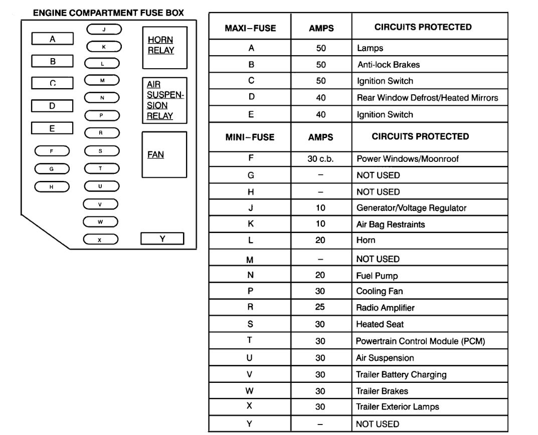

my car keeps blowing the 30 amp fuse for the air ride , it keeps saying check air suspension , and was told by a local parts store that the relay for the air ride needs to be replaced , one person said the relay is on the firewall and other said it is in the fuse box I have looked in the owners manual for the location but cannot find it

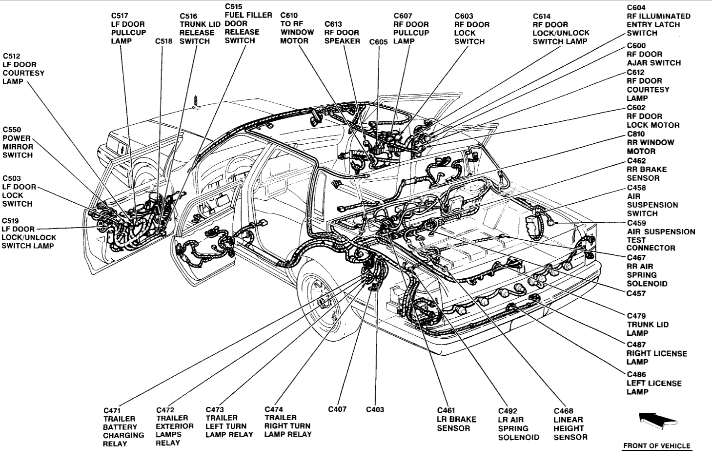

The compressor relay is in the relay center on the passenger side of the engine compartment
See the diagrams below
