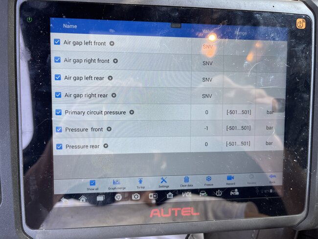

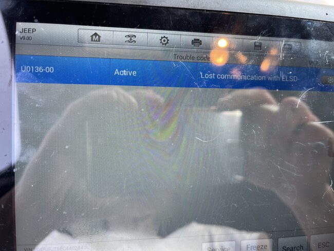

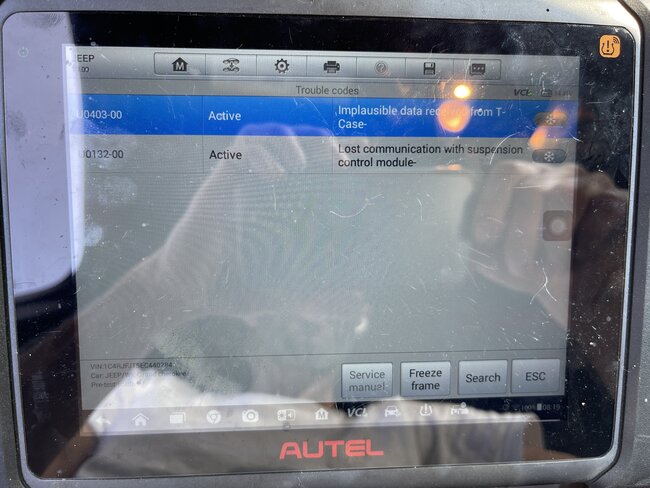

Did a scan. Going under air suspension is not connecting. Going under active dampening says it's not configured. Doing a full scan found few codes. When inactivated the pump to all 4 wheels i hear it run.i checked the fuses and relay up front and looks good. I don't even know if there is any air lift in the system i don't know where the pump is. Maybe a bad/weak pump? Cause it looks like all 4 struts are down at sane level. Also noticed that the buttons do not light up when I press to raise or lower the car. Even the light that should light up when its in park is not on.

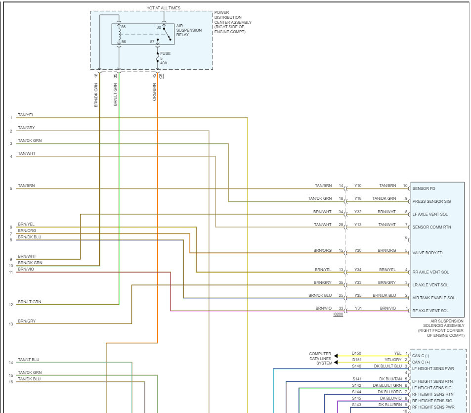

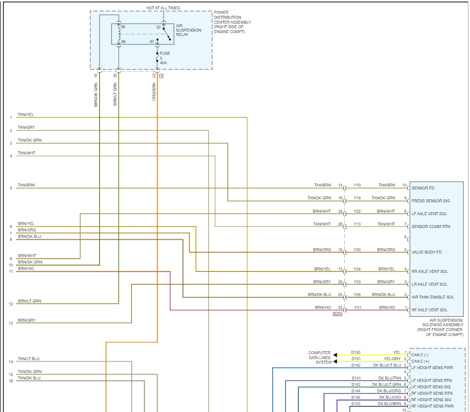

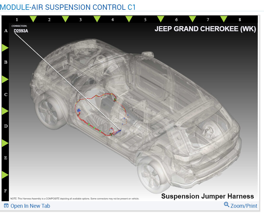

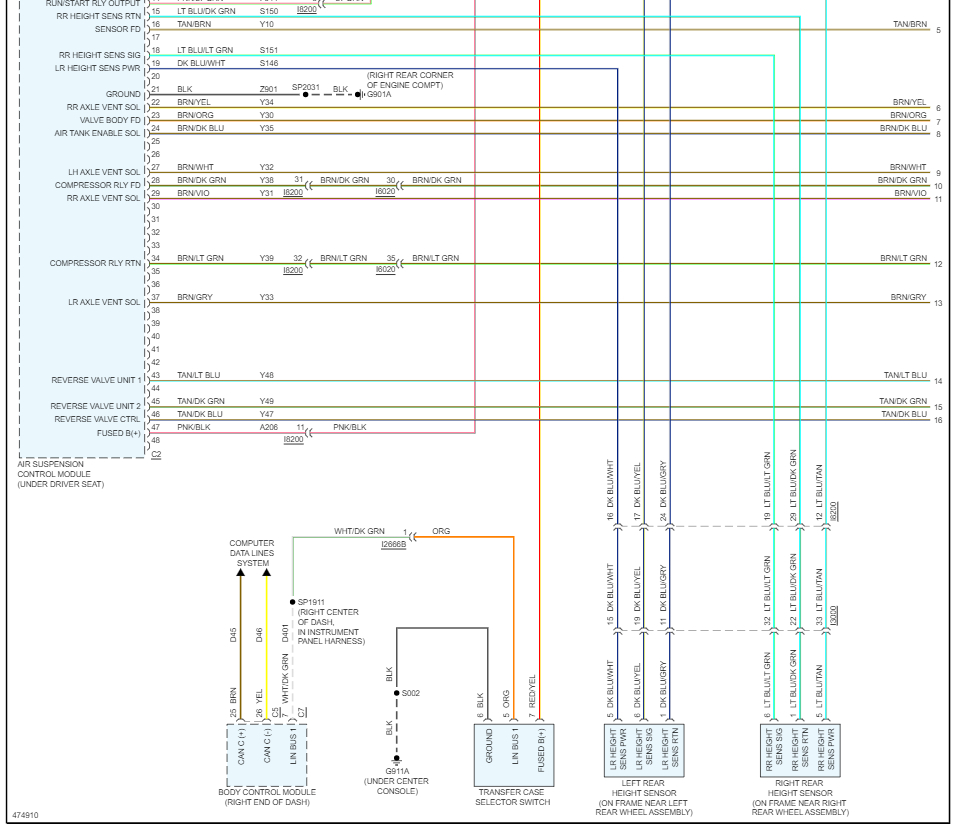

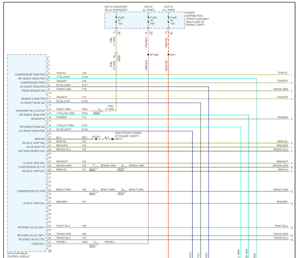

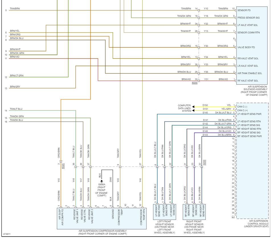

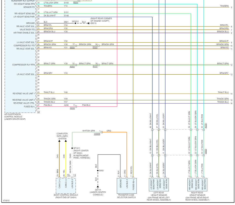

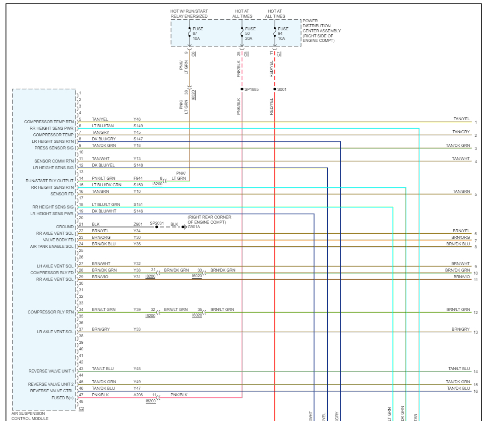

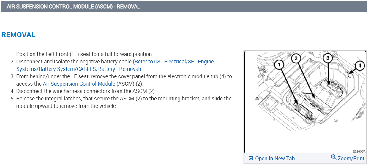

Yes, please check the fuses first, also there is a relay for the suspension control module because it has lost communication. If the fuse and relay are okay, I would swap out the module. Here are the wiring diagrams for the system so you can see how the air suspension works and which fuses to check.

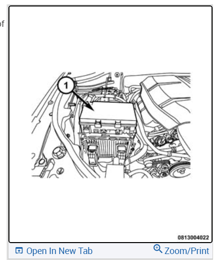

The control relay is under the hood inside the PDC. Check out the images (below). Please let us know how it goes

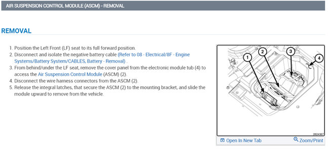

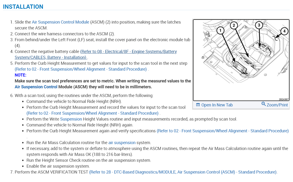

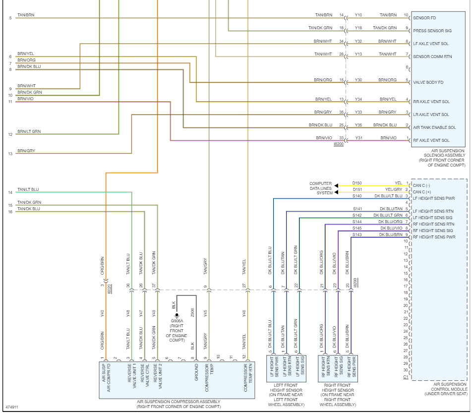

If you put power to the ORG/GRN wire at the compressor it should turn on. Also, the air suspension control module will need a verification test to start working, here is how the job is done.
STANDARD PROCEDURE - ASCM VERIFICATION TEST
PERFORM THE ASCM VERIFICATION TEST
Turn the ignition off.
Disconnect all jumper wires and reconnect all previously disconnected components and connectors.
Turn the ignition on.
With the scan tool, erase DTCs.
Make sure that all accessories are turned off and that the battery is fully charged.
Test drive the vehicle and verify proper operation.
With the scan tool, read the ASCM DTCs.
Are there any DTCs present in the Air Suspension Control Module (ASCM)?
Yes
(Refer to 28 - DTC-Based Diagnostics/MODULE, Air Suspension Control (ASCM) - Diagnosis and Testing) and perform the appropriate diagnostic procedure.
No
Repair is complete.

Does the pink and lt/grn wire at the air suspension control module have power when the key is on?
Oct 5, 2023 at 8:25 AM
BHAMDOC1973
  • 2,008 POSTS
None have anything.
Oct 5, 2023 at 9:24 AM
I forgot to ask you to test for power when the car is running.
Oct 6, 2023 at 9:29 AM
BHAMDOC1973
  • 2,008 POSTS
I checked at the compressor, not at the module.
Oct 6, 2023 at 9:35 AM
Please check the power wire at the module.
Oct 6, 2023 at 9:58 AM
BHAMDOC1973
  • 2,008 POSTS
Pink and light green has power with ignition on.
Oct 7, 2023 at 6:40 AM
Okay, let's also check the pnk/blk wire at the module for power as well. Please let me know.
Oct 7, 2023 at 8:15 AM
BHAMDOC1973
  • 2,008 POSTS
Pink black is ground with ignition on.
Oct 7, 2023 at 8:29 AM
Check fuse #50 in the main fuse panel under the hood.
Oct 8, 2023 at 10:20 AM
BHAMDOC1973
  • 2,008 POSTS
Already done that more than once. It's good.
Oct 8, 2023 at 11:25 AM
Fuse 50 feeds the pnk/blk wire which you said does not have power? Can you look at the wiring diagrams I first sent to see what I am talking about?
Oct 9, 2023 at 8:47 AM
BHAMDOC1973
  • 2,008 POSTS
I did. But it has ground power. And the fuse is okay.
Oct 9, 2023 at 9:01 AM
BHAMDOC1973
  • 2,008 POSTS

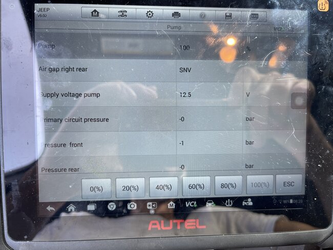

No sorry the fuse is blown.
Oct 9, 2023 at 9:10 AM
BHAMDOC1973
  • 2,008 POSTS
I hear the pump now.
Oct 9, 2023 at 9:15 AM
BHAMDOC1973
  • 2,008 POSTS

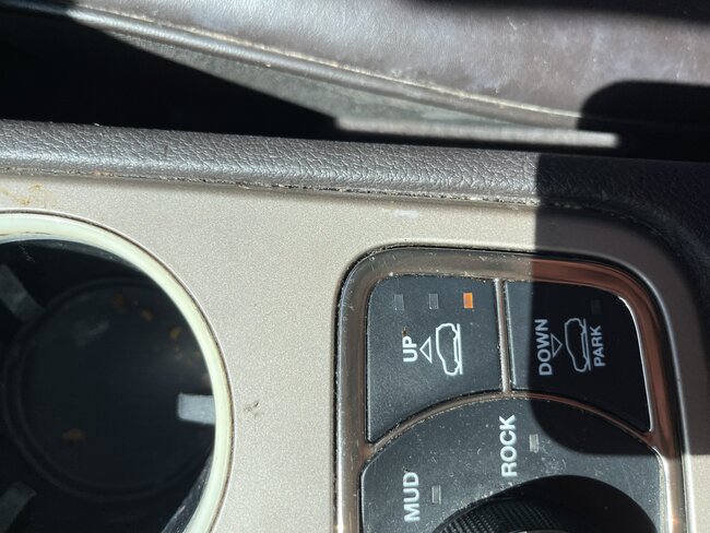

It's gone up. How do i get it to go into the down/park which i guess is what i need to have it on? As in just parked level?
Oct 9, 2023 at 9:19 AM
BHAMDOC1973
  • 2,008 POSTS
Is this where it should be?
