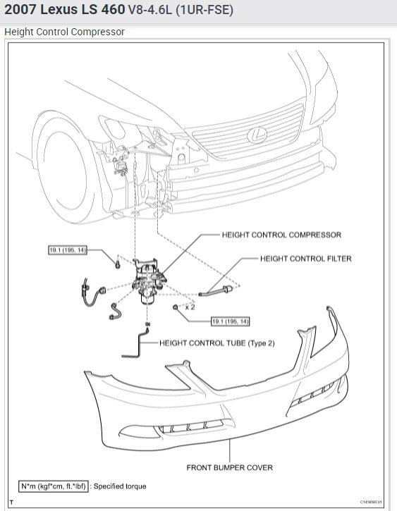

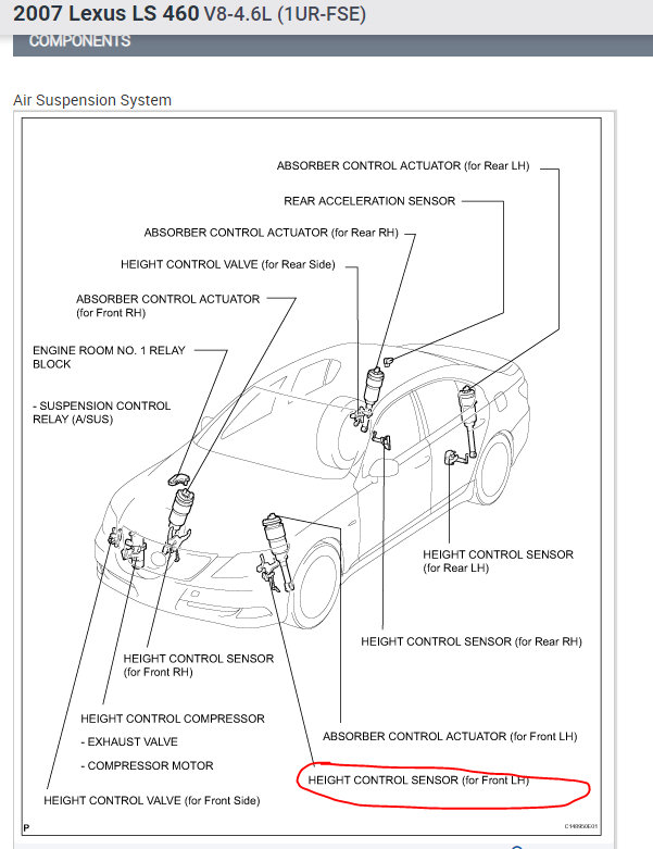

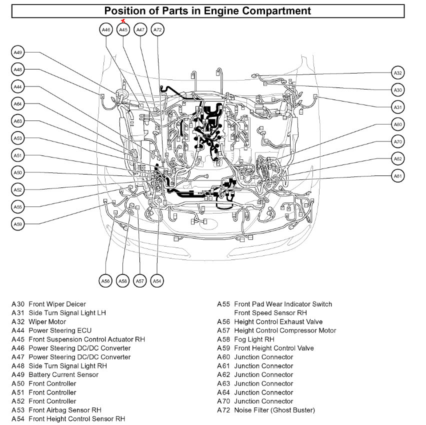

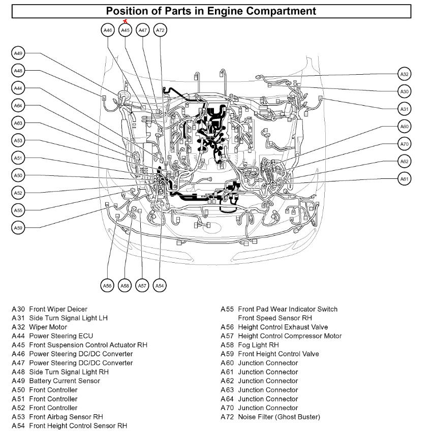

The compressor is inside the front bumper on the passenger side, below the headlight.

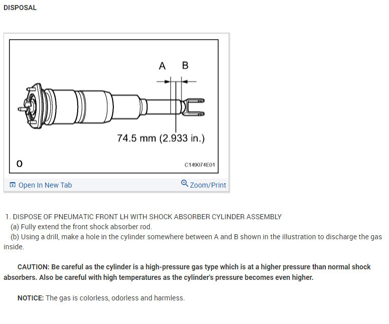

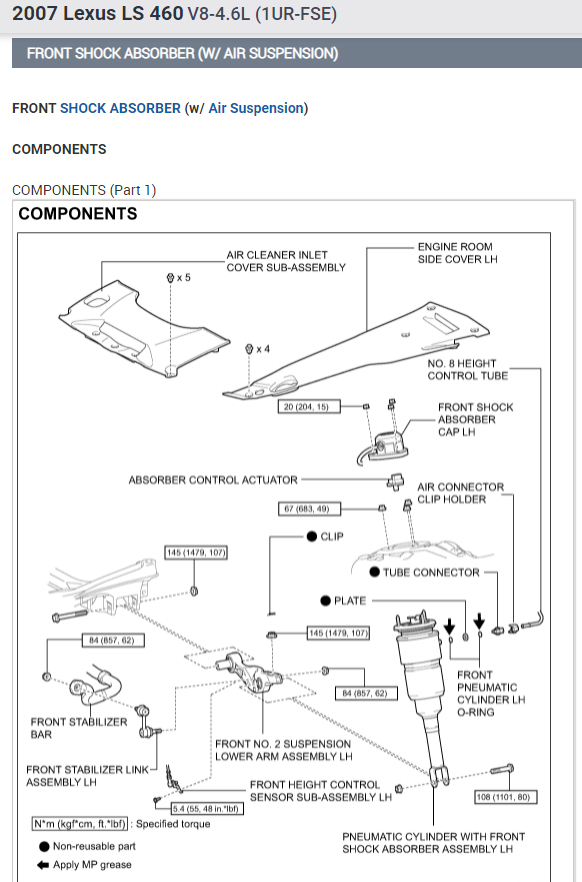

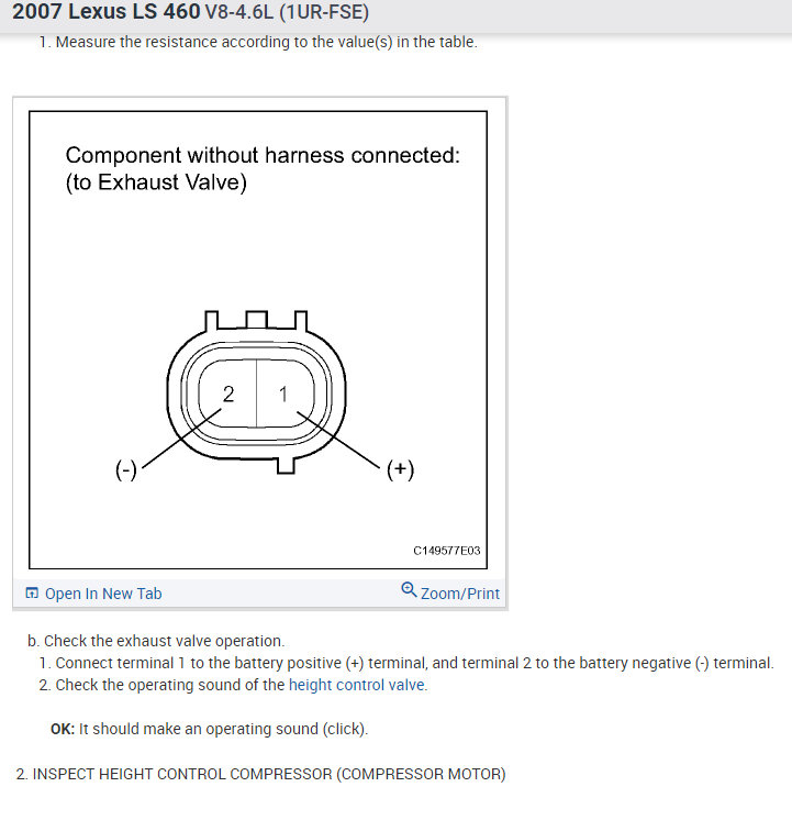

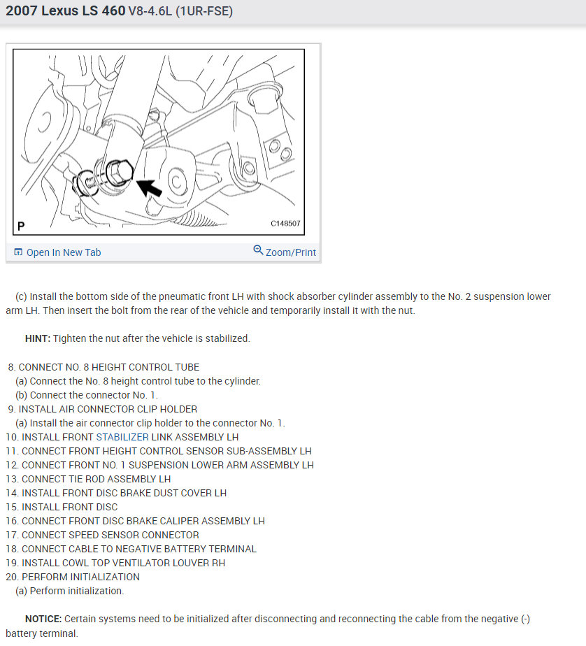

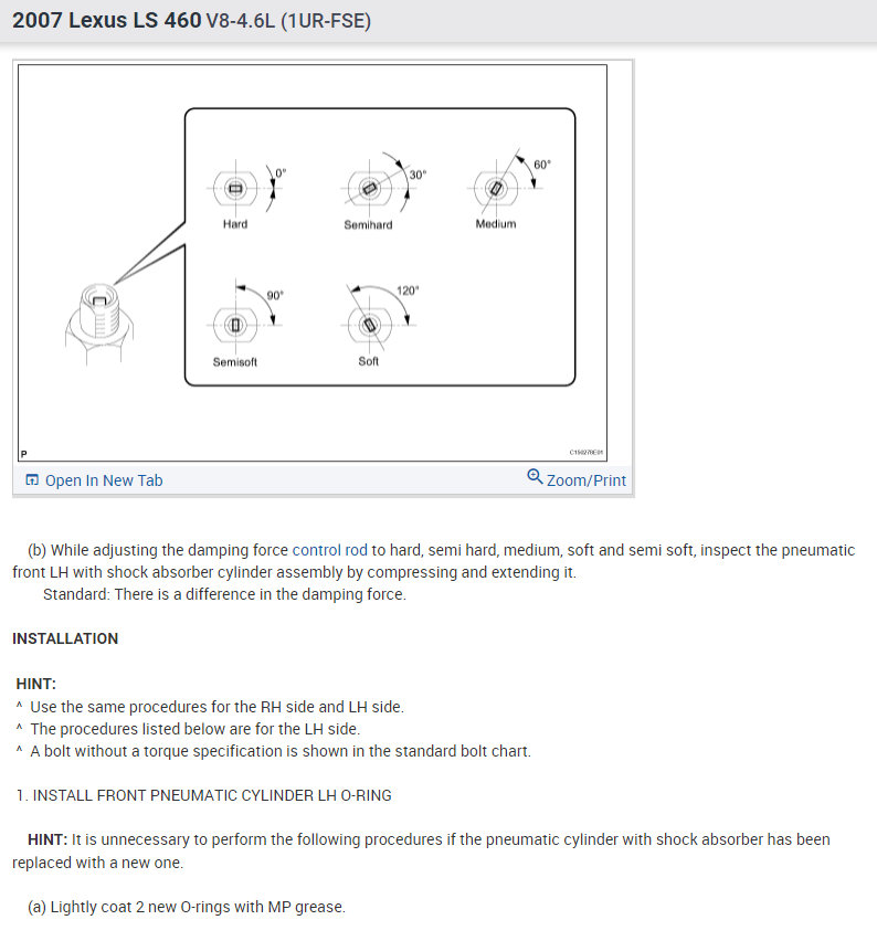

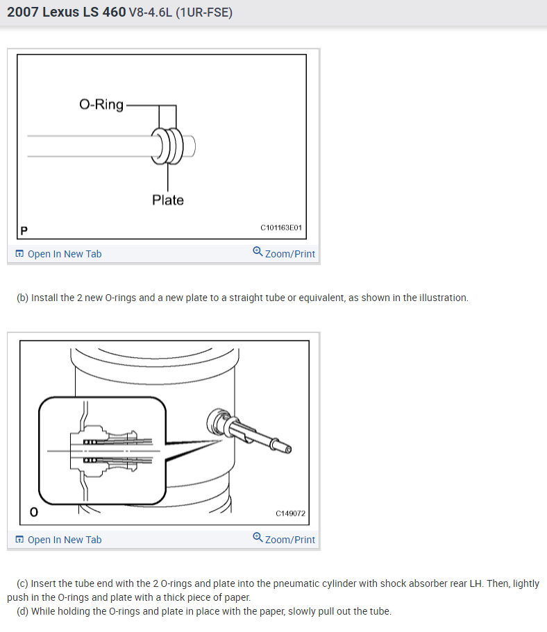

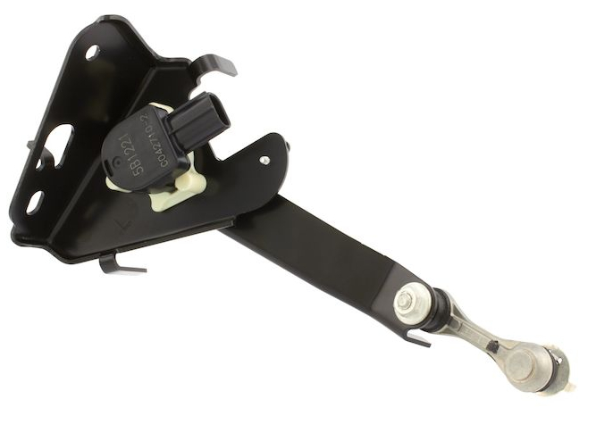

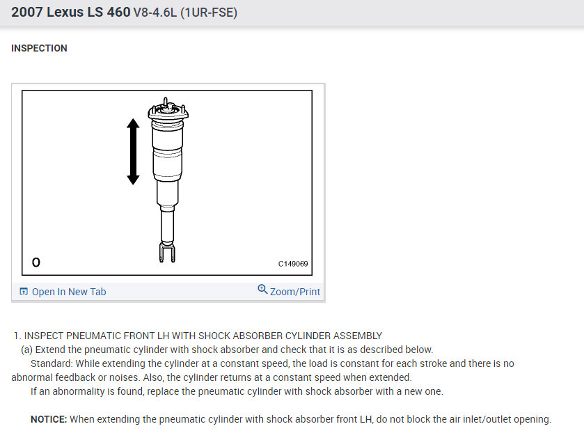

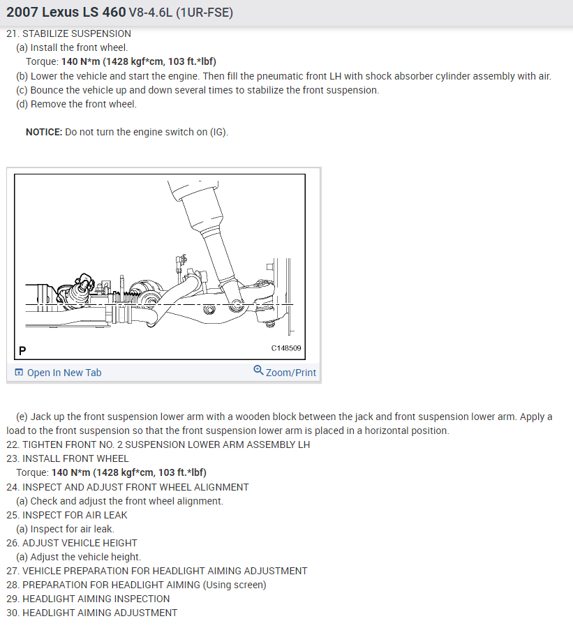

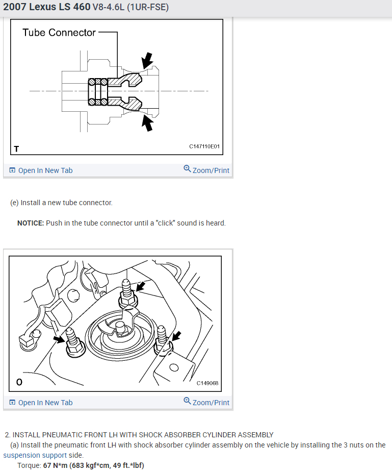

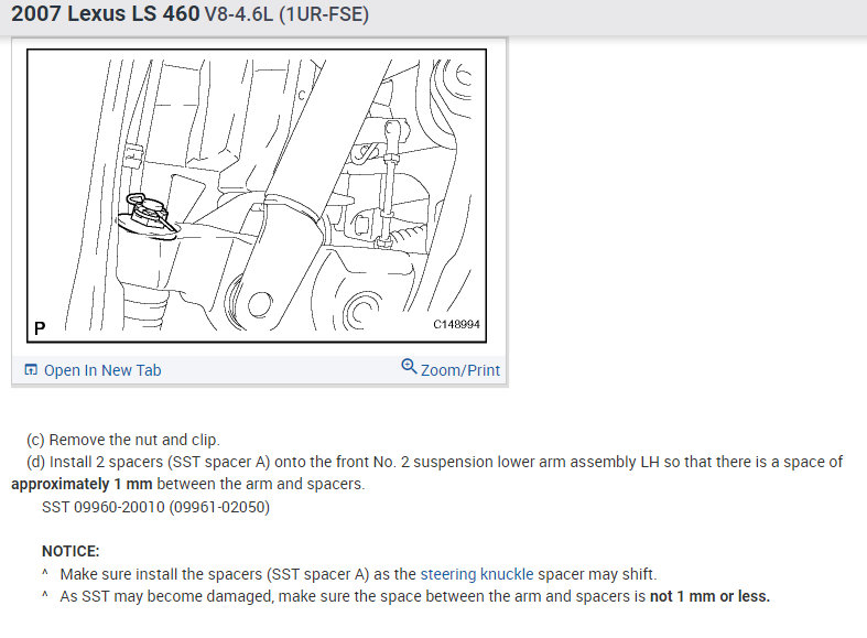

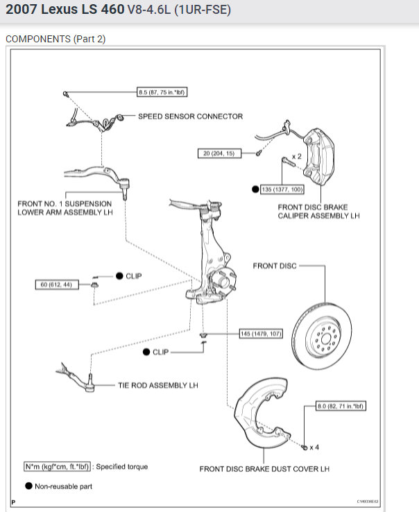

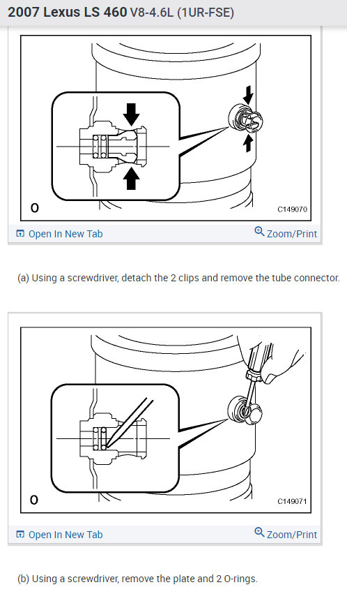

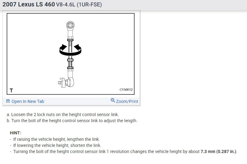

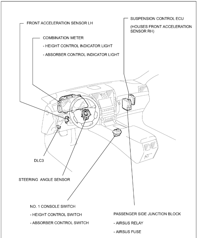

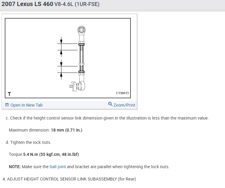

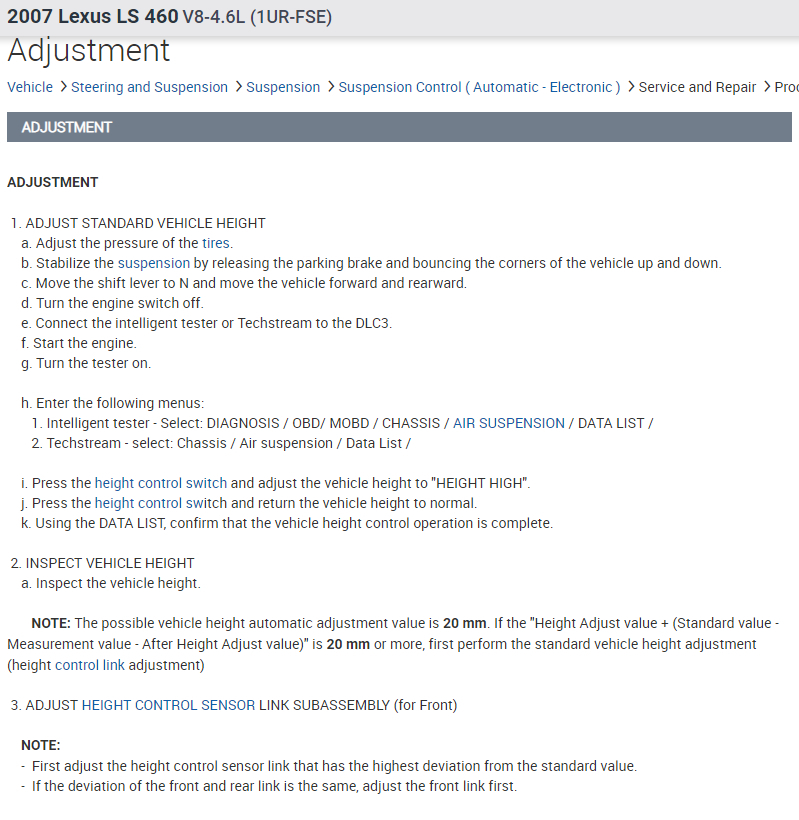

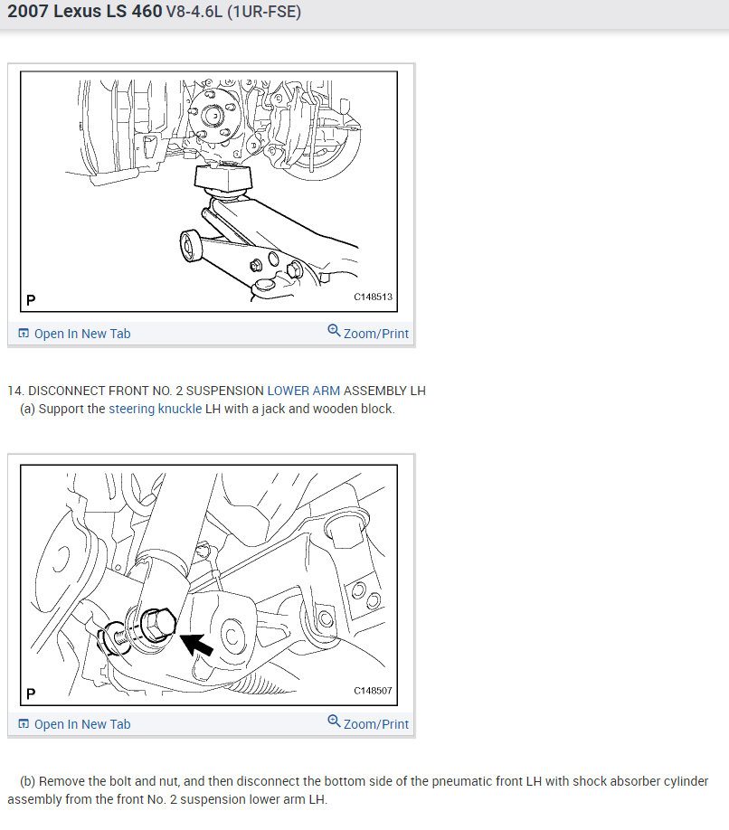

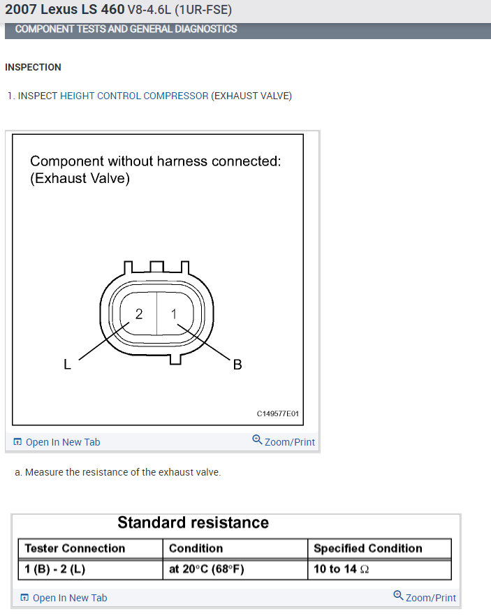

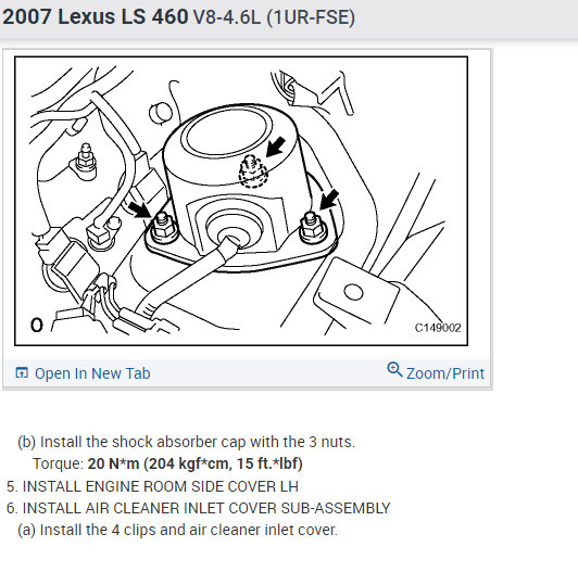

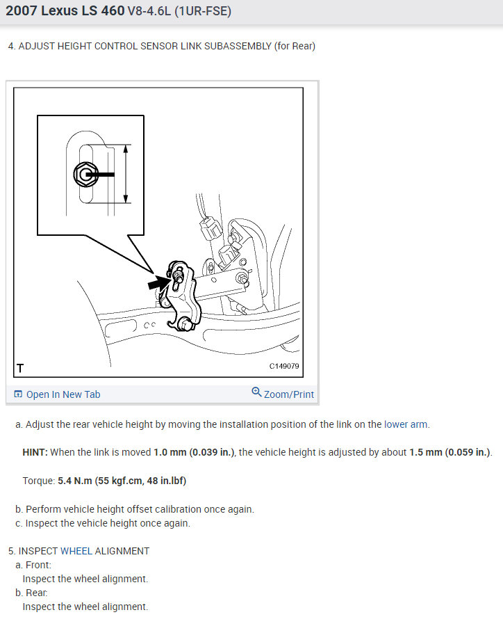

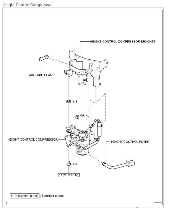

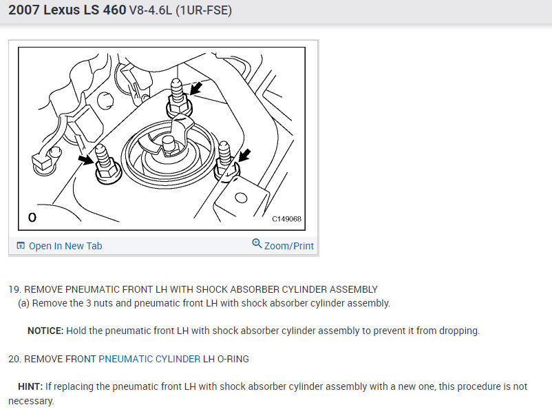

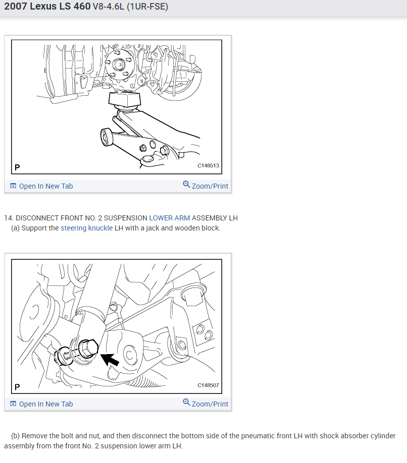

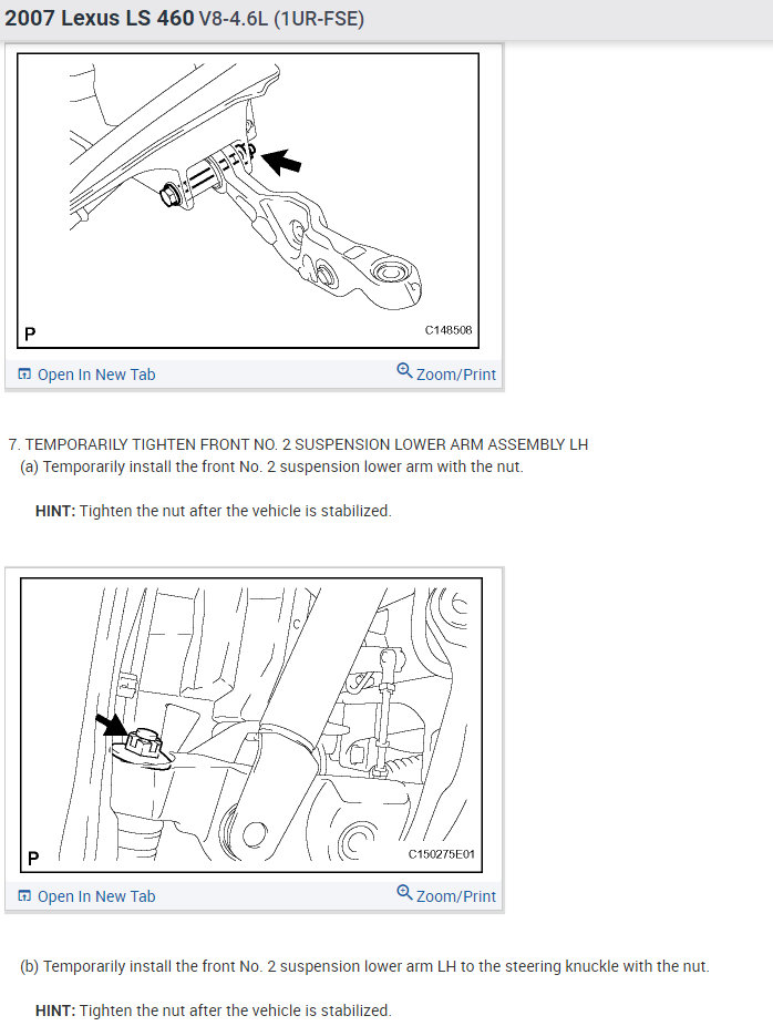

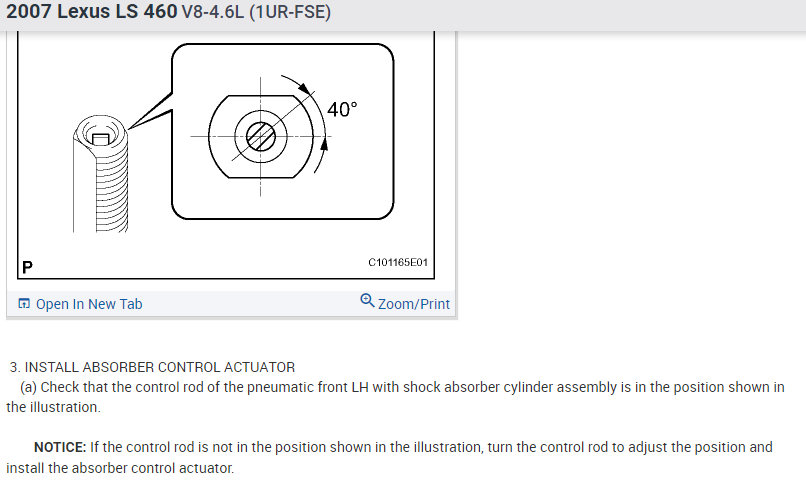

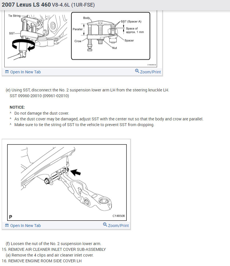

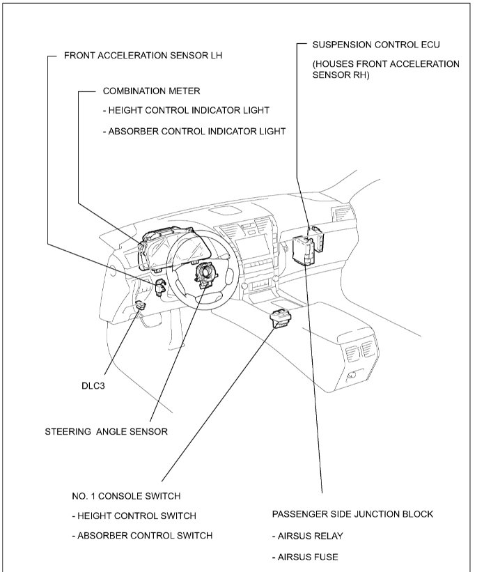

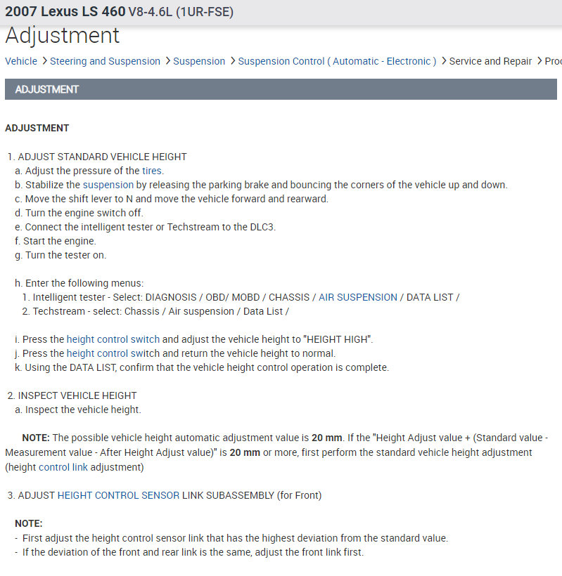

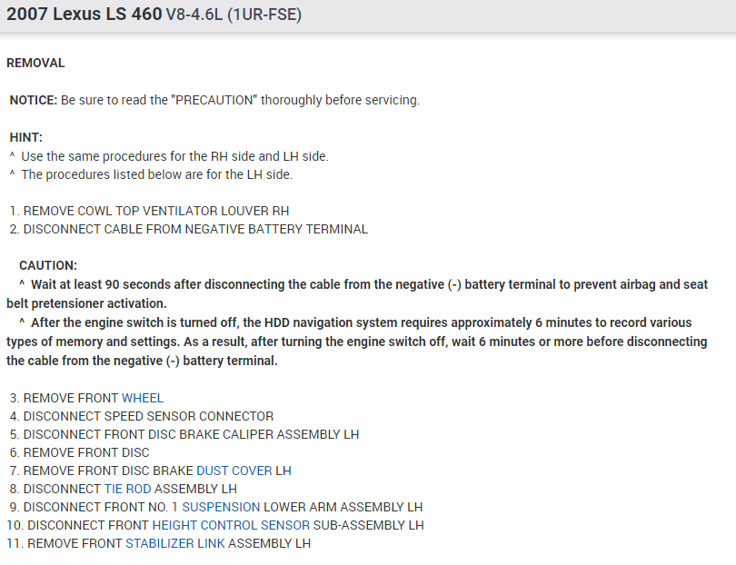

I have attached some diagrams including all the key components for the air ride system.

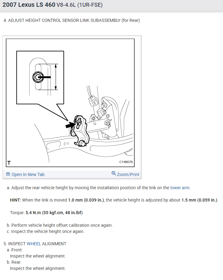

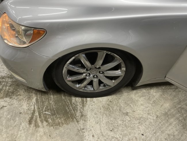

I think the front right is over compensating for the left that way its much higher that it should. See if you can maybe adjust it down.

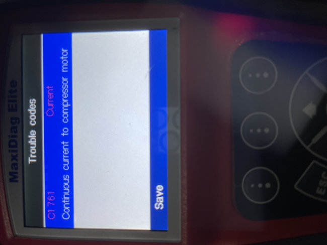

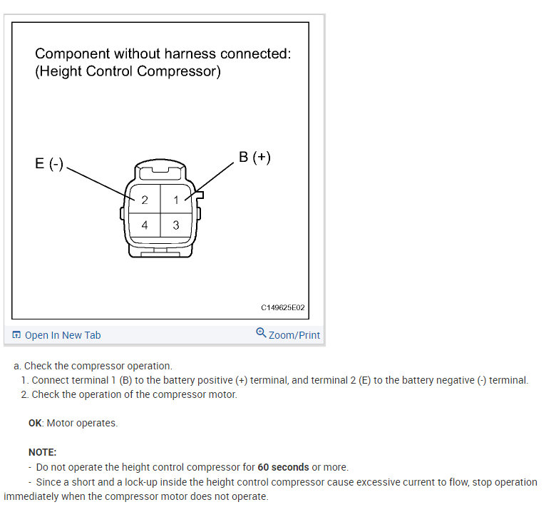

Is you compressor keeps running or does it shut off after the suspension at a certain height?
