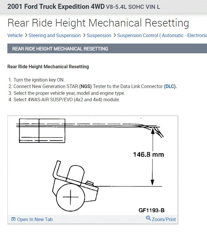

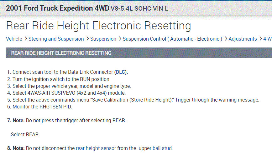

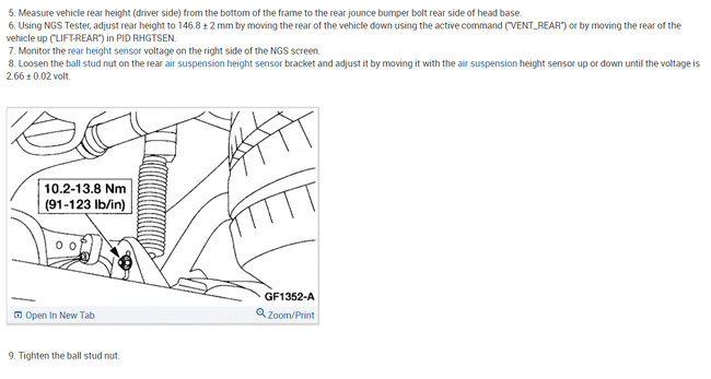

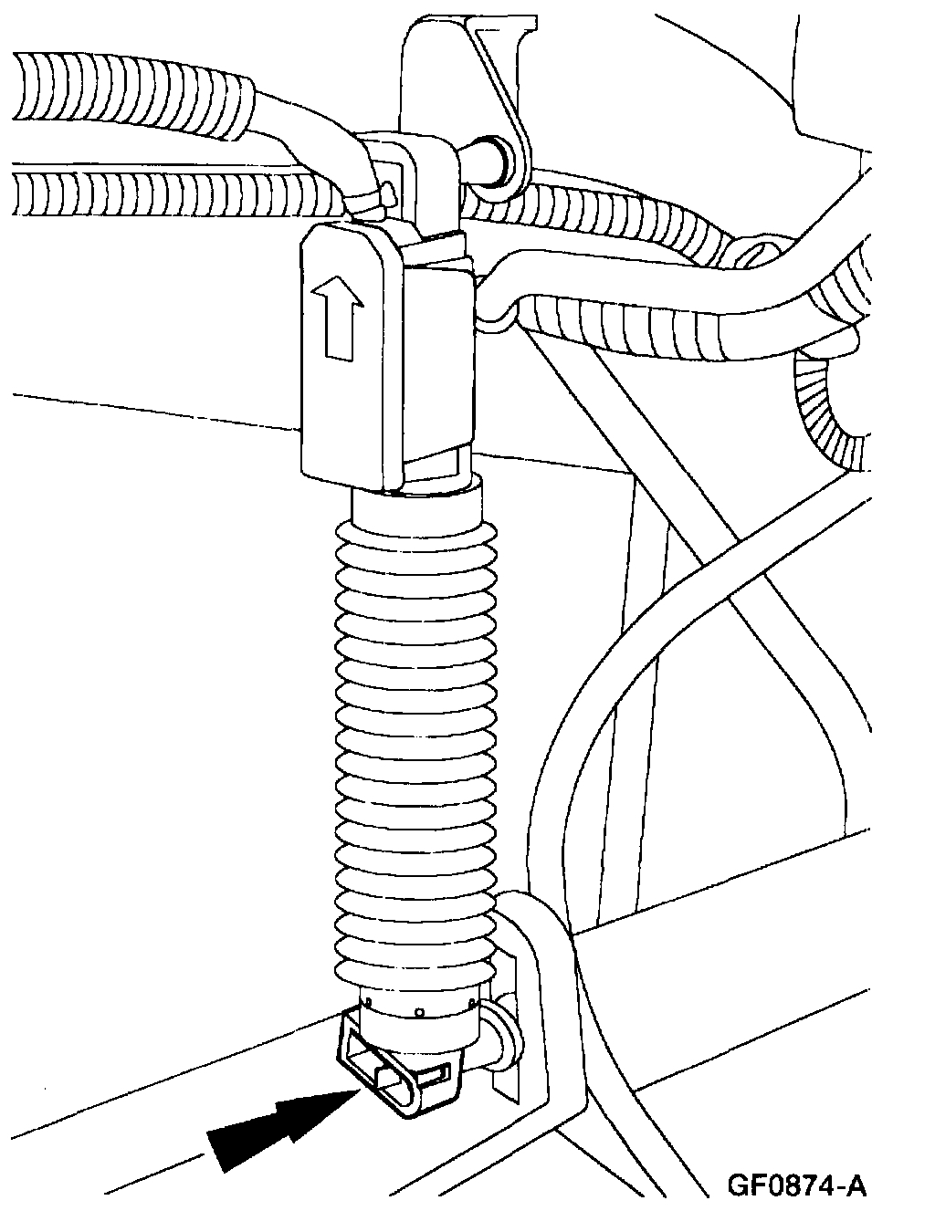

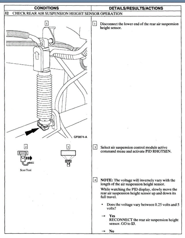

This is going to be tough because you changed the system. However, let's give it a try. When you indicate the rear won't pump up, are you certain there are no leaks? Also, have you tried a mechanical or electric reset?

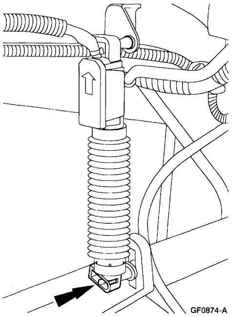

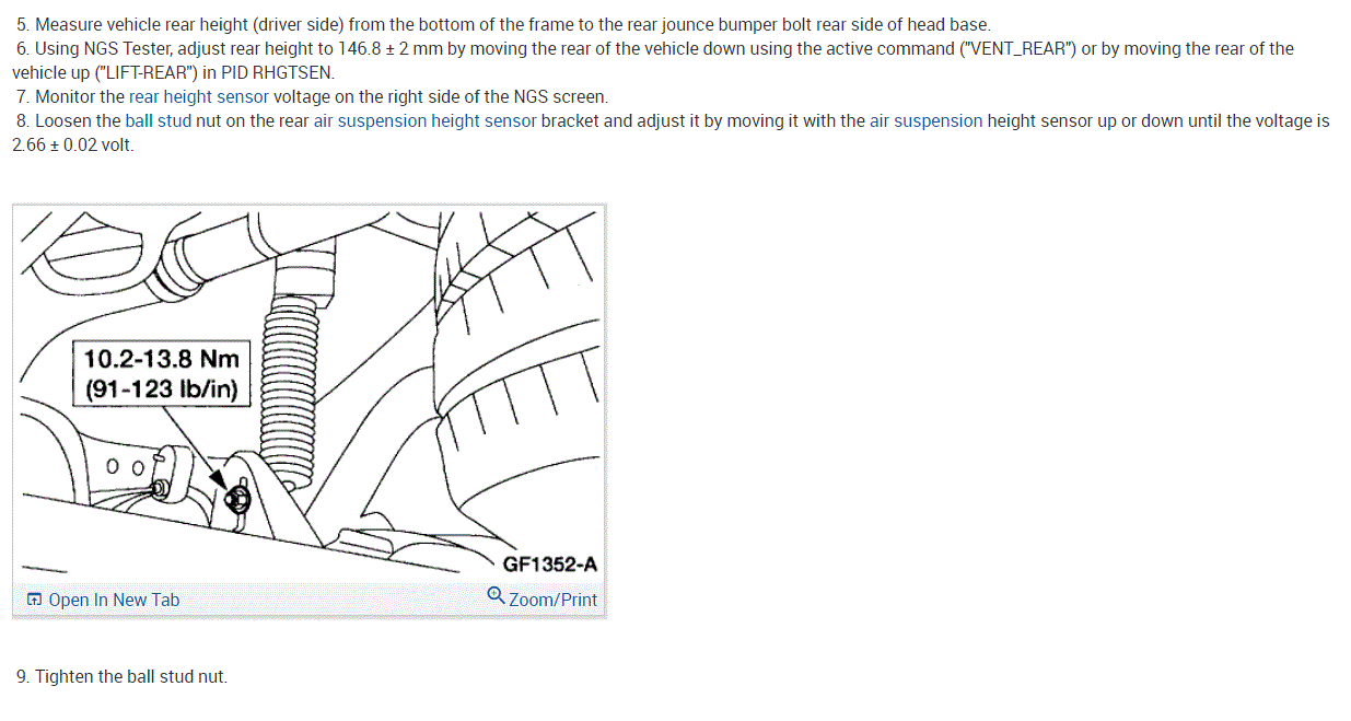

If you look below, the first two pics are the mechanical reset. The last three are the electronic reset.
Let me know if you have already tried this. As far as the compressor running, if there is a leak and the rear height isn't reached, the height sensor will keep it running.
Take care and let me know what you find.
See pics below.

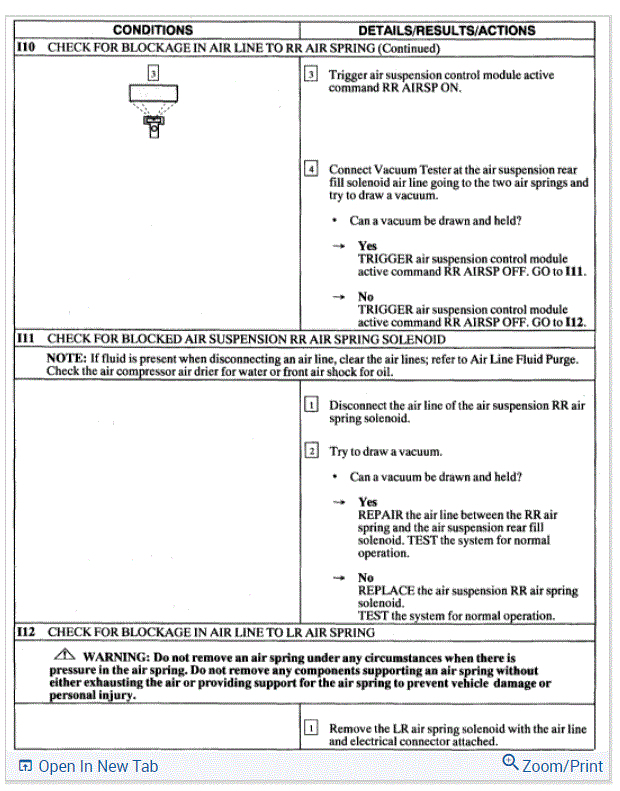

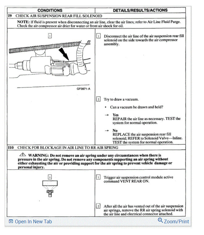

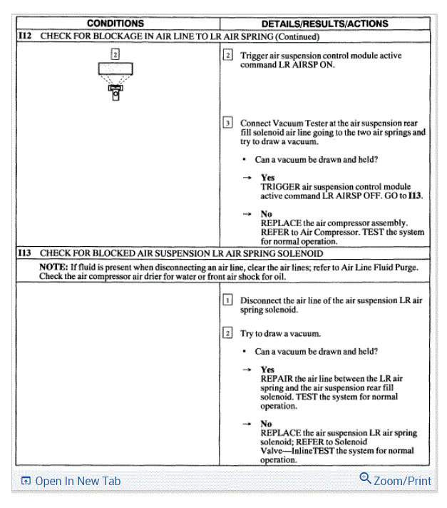

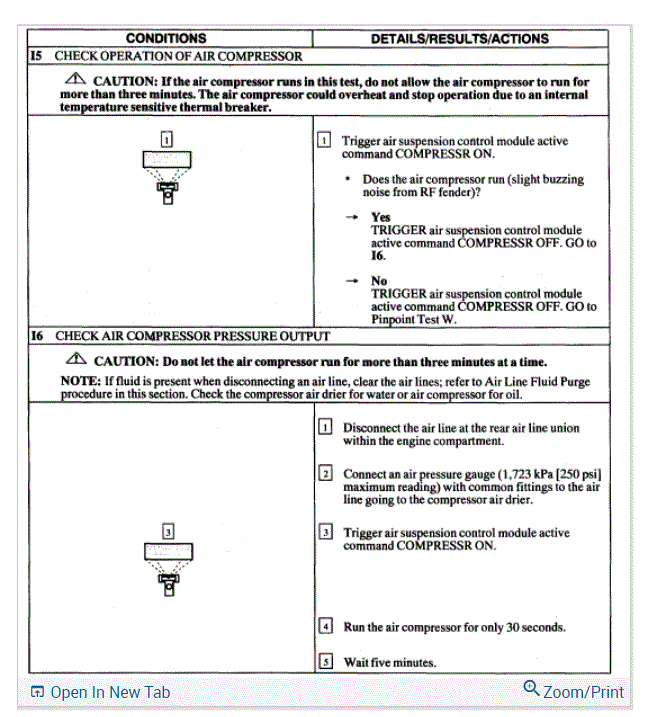

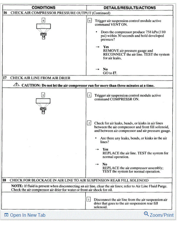

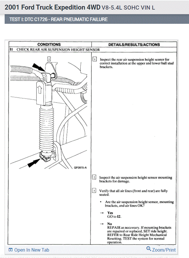

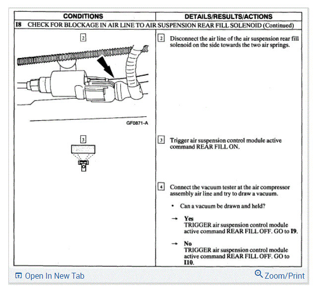

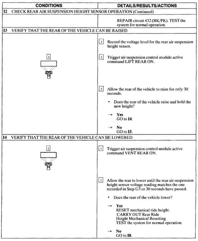

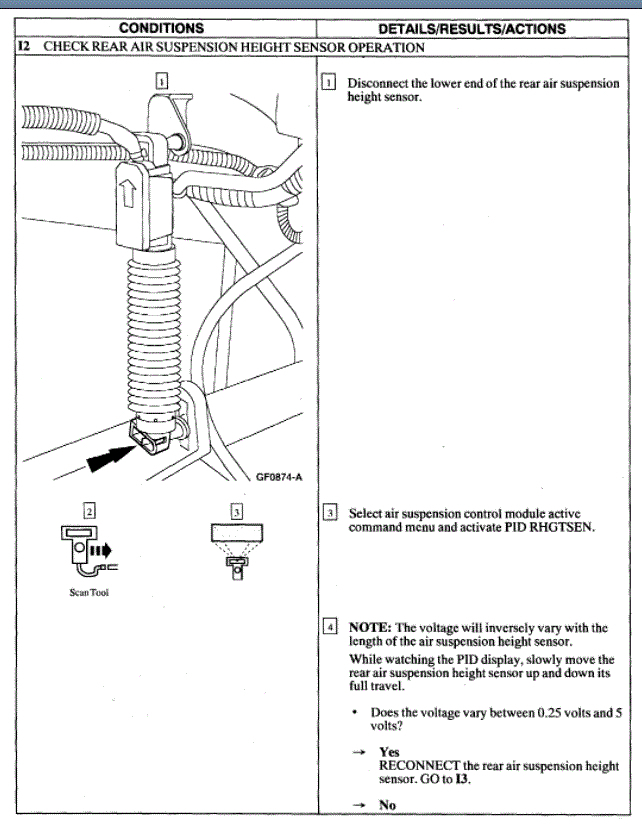

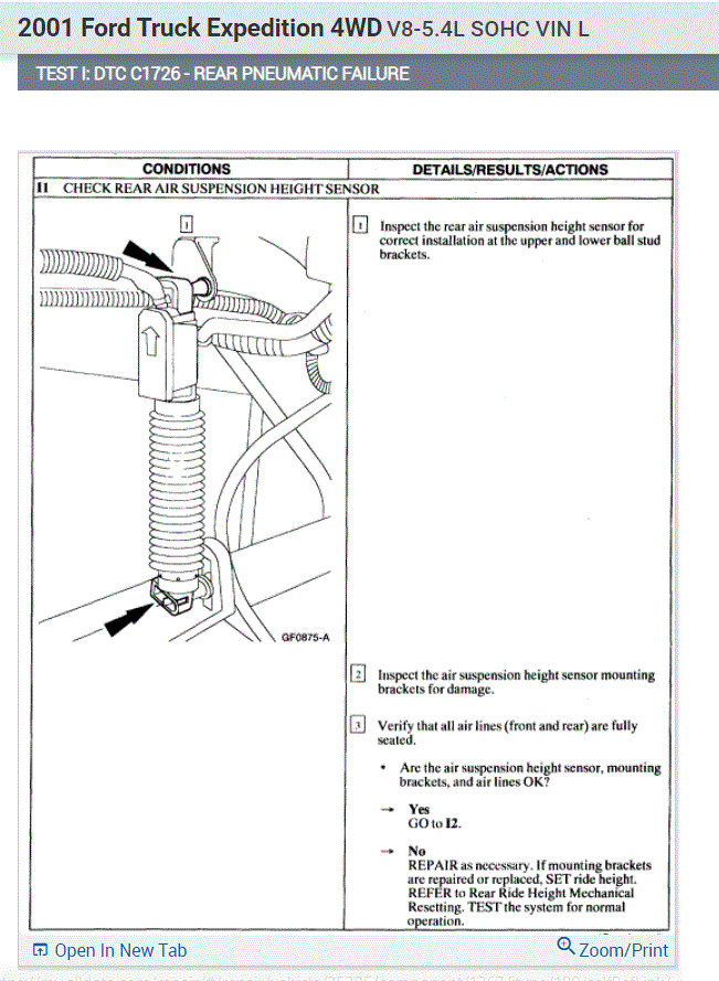

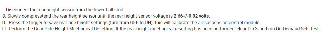

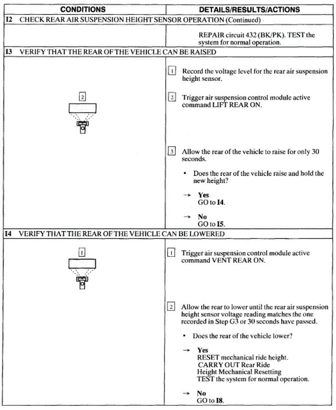

What you are saying makes sense. Do me a favor. Take a look through the diagnostics below. They are specific to the rear air suspension failure. See if there is something there that helps.
It will require a scan tool that can actuate the compressor system.
See pics below.

I solved the problem, there was an air leak at the dryer. I would like to thank you for your assistance, we went through all of your diagnosis diagrams and it was a major help.
