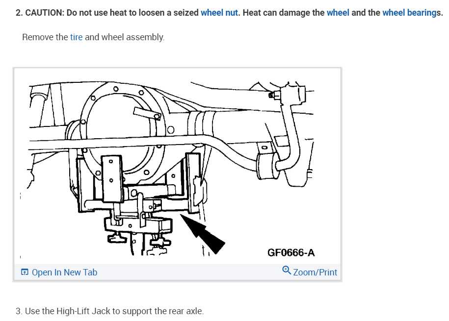

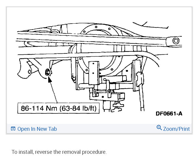

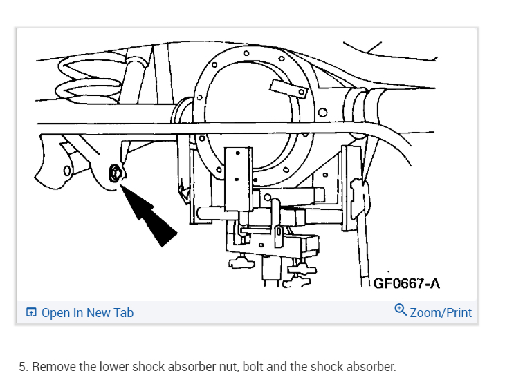

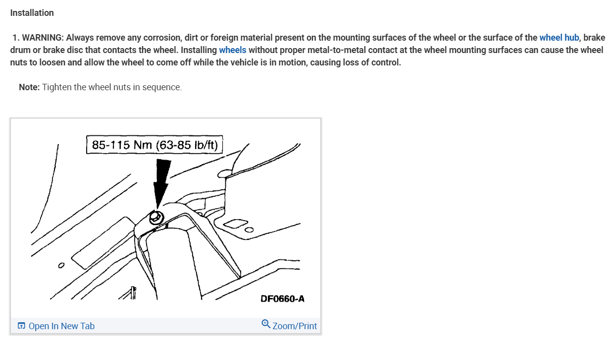

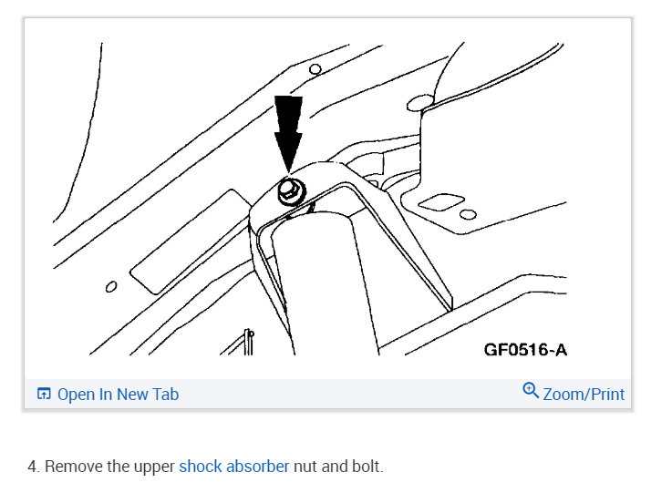

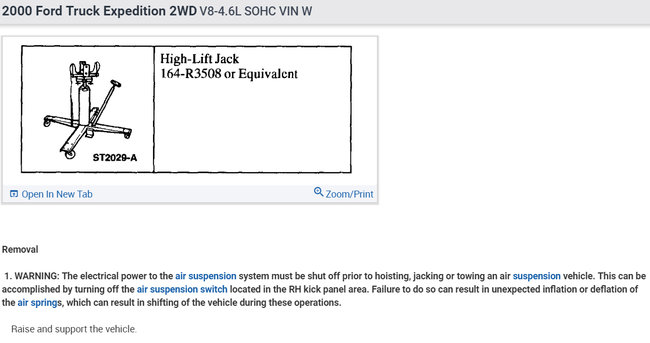

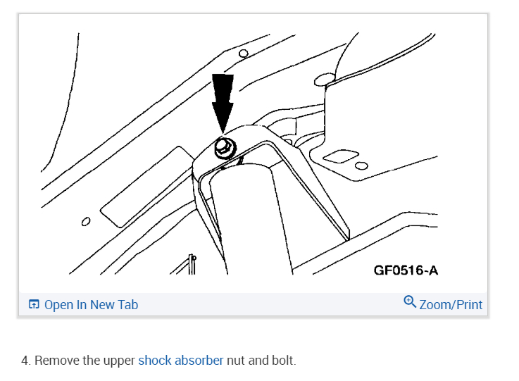

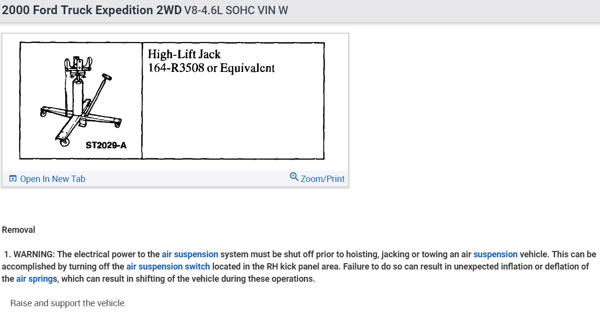

Yep this is common, what happens most of the time is the rear shocks leak. Here are guides to help you change them out. You can get new shocks on Amazon or RockAuto.com
