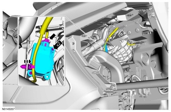

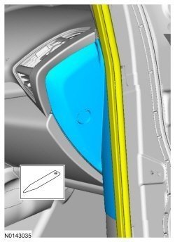

This particular vehicle has a mode door actuator specific to the defroster. Here are the directions for removal and replacement. Note: I'm not saying it's bad, but it would be a good idea to remove it and see if it is functional.
The attached pics correlate with the directions.
______________________
2013 Ford Truck Escape 4WD L4-1.6L Turbo
Mode Door Actuator - Defrost Door
Vehicle Heating and Air Conditioning Air Door Actuator / Motor Service and Repair Removal and Replacement Dual Automatic Temperature Control (DATC) Mode Door Actuator - Defrost Door
MODE DOOR ACTUATOR - DEFROST DOOR
Removal
NOTE: Removal steps in this procedure may contain installation details.
1.
pic 1
2.
pic 2
3.
pic 3
4.
pic 4
Installation
1. To install, reverse the removal procedure.
