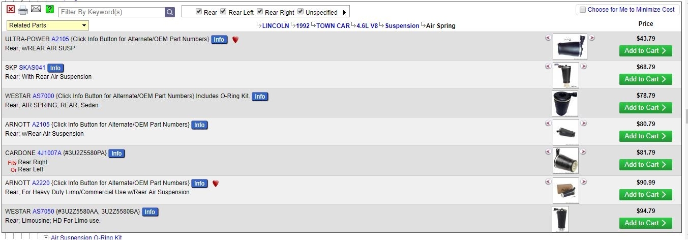

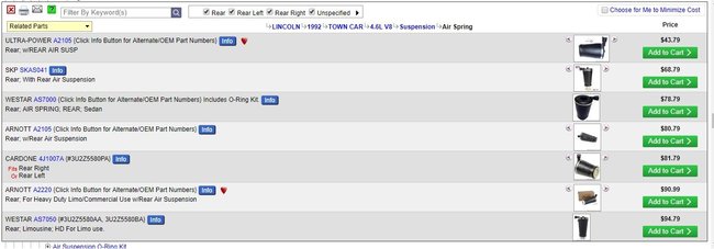

I have an airbag that will not hold air. was going to get a conversion kit from air to coils but when i jacked it up and looked around, i saw the shocks and thought; why not just put some bigger and beefier air shocks in place of these. run my airline down the frame to the back and just disconnect the old airbags and leave them for now. So everywhere i tried keeps telling me they don't offer air shocks for my car. how can i find some good air shocks to fit in place of the original ones and has this ever been done?
Aug 9, 2019 at 7:57 PM
Good morning,
Shocks do not hold up a car, it stabilizes the suspension. Springs hold up a car.
Even if you found air shocks, they will not work as that is not there job.
Why not just replace the failed airbag? It is an easy replacement and the bags are cheaper than trying your air shocks or the conversion.
Aug 10, 2019 at 5:13 AM
HAILEEGRACE12
  • 35 POSTS
Yea you're right. I thought about it all night and that was the most logical answer i could come up with.. Can I just buy 1 or do they only come in pairs?is there a way to patch one?
Aug 10, 2019 at 5:50 AM
No patching. Yes. You can buy just 1. Check with rockauto.com.
Aug 10, 2019 at 5:52 AM
Found the bag for you at rock auto. It is less than $100.00.
Aug 10, 2019 at 5:59 AM
HAILEEGRACE12
  • 35 POSTS
Thanks i ordered it. Just went ahead and got a pair. Figured it would be foolish to have it up on jack stands and only doing one side. I have read somewhere that i need to replace an air dryer? But also heard that it really doesn't matter. Is this something i should look into or will i be okay just replacing the airbags?
Aug 10, 2019 at 8:05 PM
Just replace the bags.
