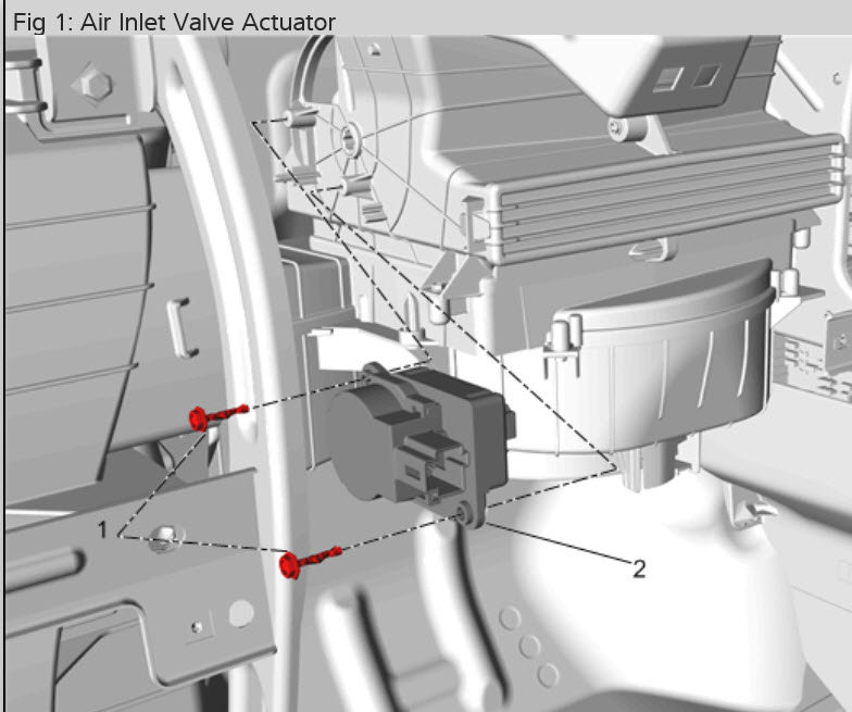

our manual says nothing about how far the actuator opens or closes it may in your manual if you have one. try a reset though, pull HVAC fuse inside truck for sixty seconds with key on that should reset all of them and may fix your problem. See picture of location.

Okay, I did a little more looking and here is what I found:
I took out the glove box and pulled out the cabin filter. I turned the key to enable the fan, but did not start the engine. Then I pressed the button to turn on the fan with Recirculate off. Through the cabin filter slot I could see the air inlet vent door (I had a flash light and mirror and also an fiber optic inspection camera). I now also know where the air inlet actuator is (on the left side of the housing).
Then I turned activated the recirculate button and saw the vent cover rotate up to cover the hole in the top of the housing to the outside air and expose the holes in housing to the cabin (it rotates a "hood" inside the housing for a vent cover). Any time I turned the fan off, the recirculate went off and the vent cover returned to the down position to block the cabin inlet and let in outside air from the air inlet pipe at the top of the housing (this makes sense).
With the fan on and the recirculate button pressed and lit, I did not see any openings to the outside air pathway. This seems to nix the rumor I had read about GM making the vents only close 90%. I was even able to reach around the side of the housing and put my fingers in the cabin inlet holes and feel the vent cover door completely covering the outside air inlet.

Thank you. And thank you for the diagram in the last post!
