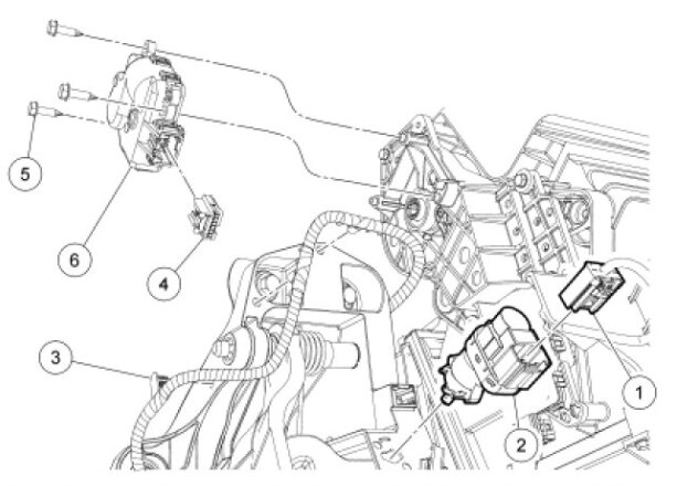

Yep, this problem will be the mode blend door actuator. This actuator is above the accelerator pedal on the left side of the dash so it might be difficult to get to and they say to you need to remove the steering column and the speed control deactivator switch electrical connector.
Do not press the brake pedal when removing or installing the speed control deactivator switch, as the switch will be damaged.

Here is the exact location and the mode blend door actuator. Check out the images (below). Let us know how it goes
