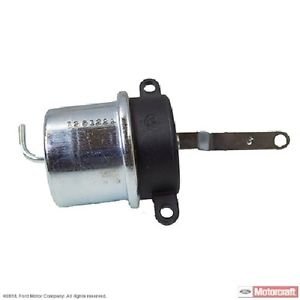

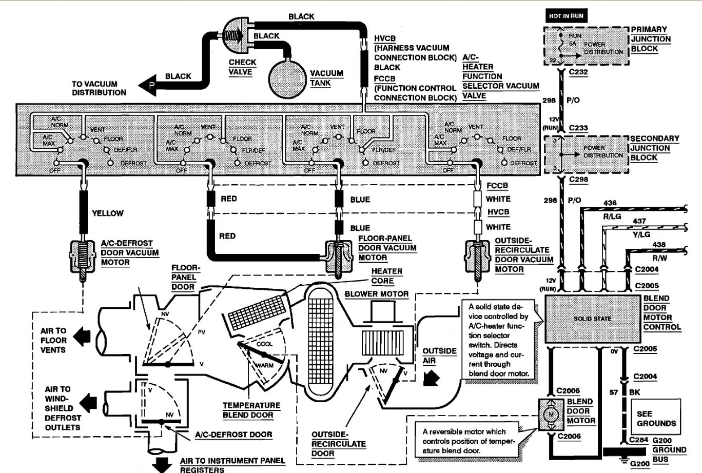

I have been working on the blend door actuator recently and no air goes through the panel vents. Do I need to put in a replacement for it to start working again? I am currently waiting for the replacement to be delivered. I am also worried I might have damaged a cable or vacuum line.
