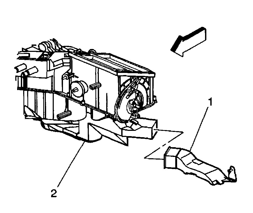

1. Remove the floor air outlet duct extension (1) from the floor duct (2).

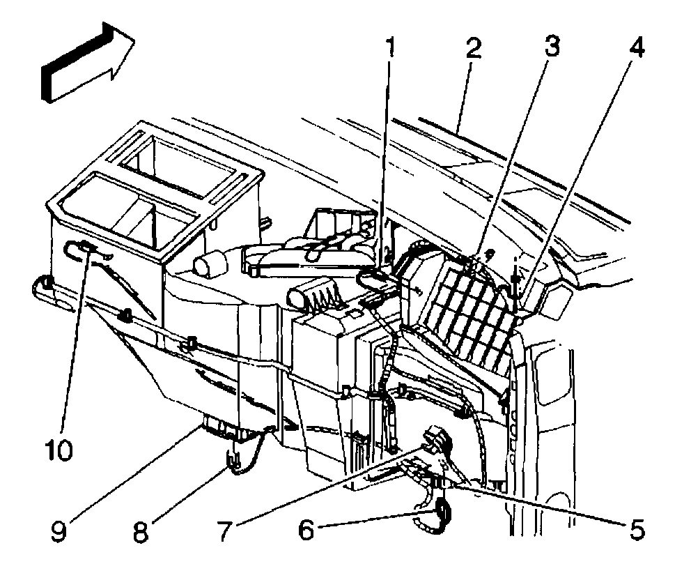

2. Disconnect the electrical connection at the mode actuator (10).

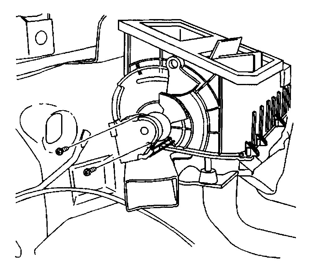

3. Remove the mode actuator mounting screws from the HVAC module.
4. Remove the mode actuator as an assembly with the actuator cam.

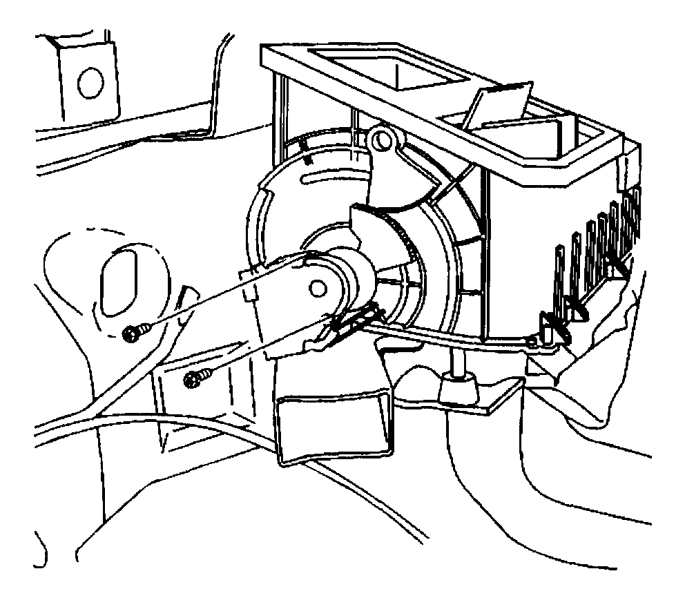

1. Install the mode actuator as an assembly with the actuator cam.
- Line up the heater/defroster valve lever with the mode actuator cam slot.
- Line up the A/C valve lever with the mode actuator cam.
2. Install the mode actuator mounting screw to the HVAC module.
Tighten
Tighten the mode actuator mounting screw to 1.6 N.m (14 lb in).
