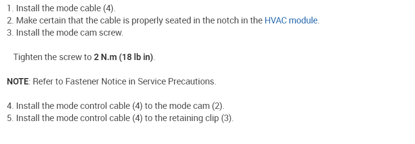

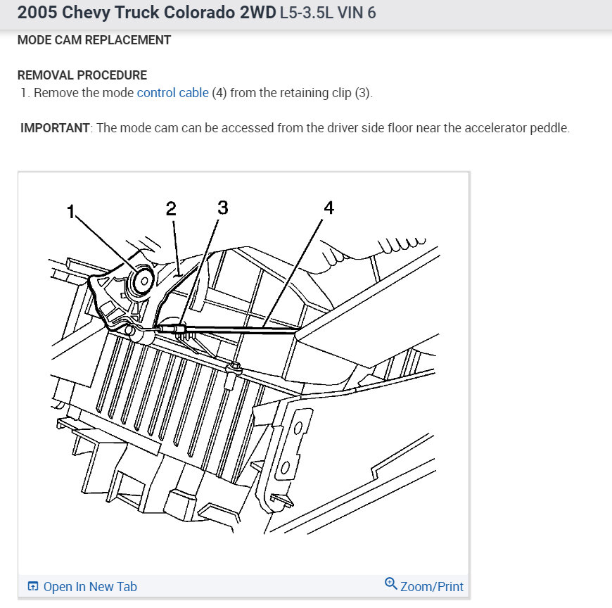

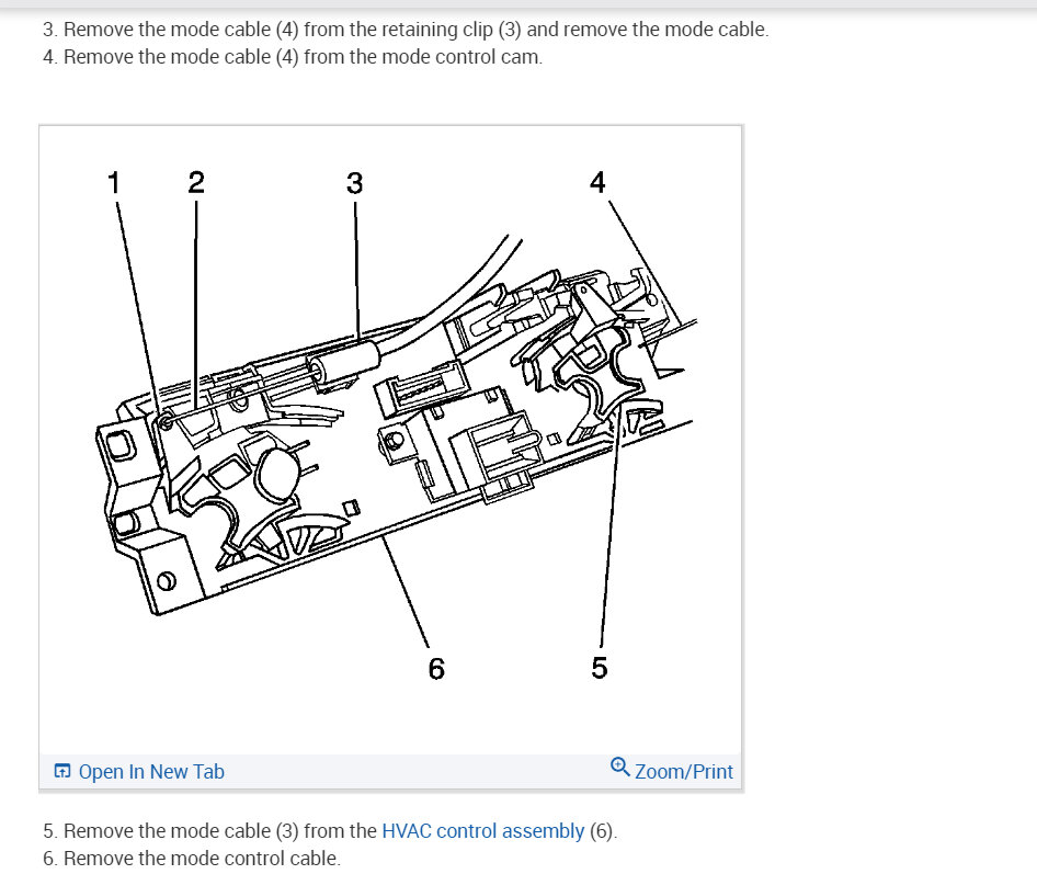

The mode door is controlled by a cable not an actuator. Here is the information on that Check out the images (below). Let us know what happens and please upload pictures or videos of the problem so we can see what's going on.
