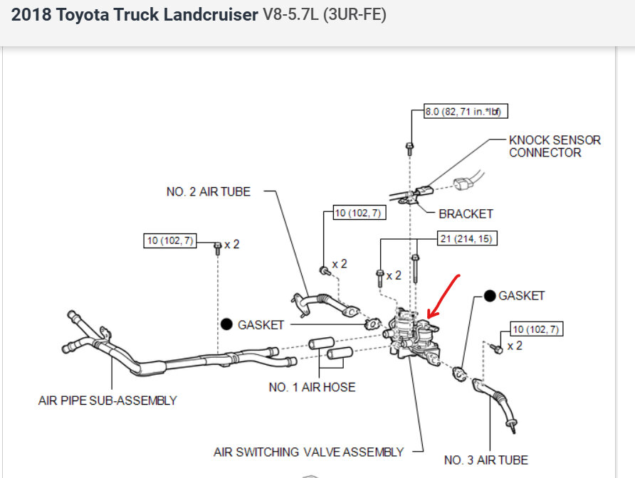

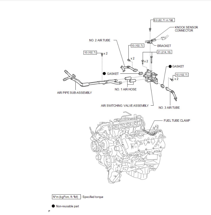

Thanks for the video, this sounds like an air injection problem like the air switching valve is getting stuck, can you get a better idea of where the noise is coming from? I would remove the air switching valve and clean it to see if that helps, plus with the engine cover off you may be able to get a better idea of what is making the noise. We should run the codes as well, there might be something stored there.
