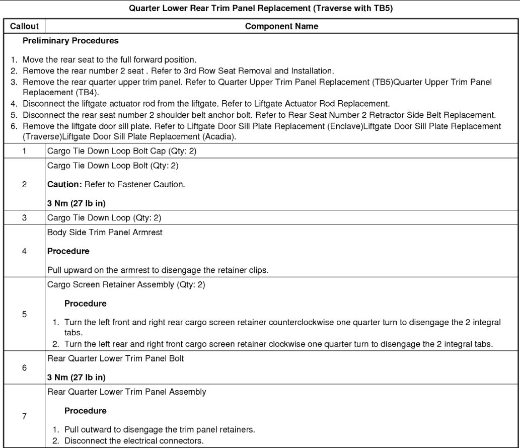

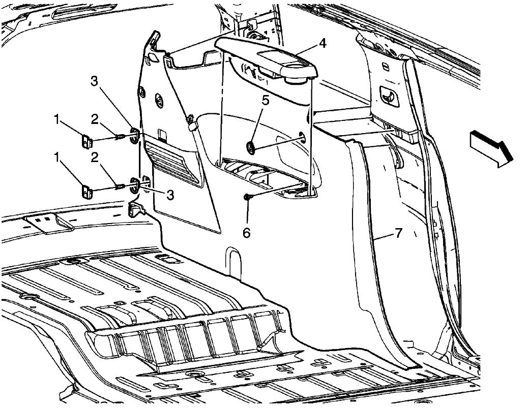

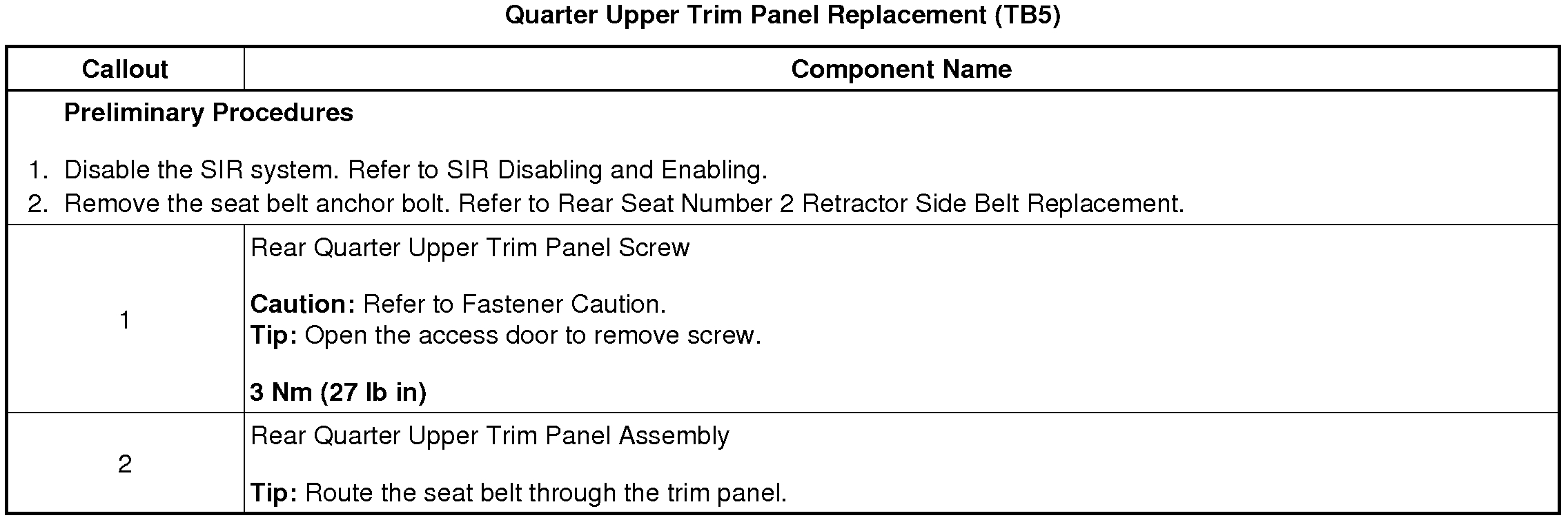

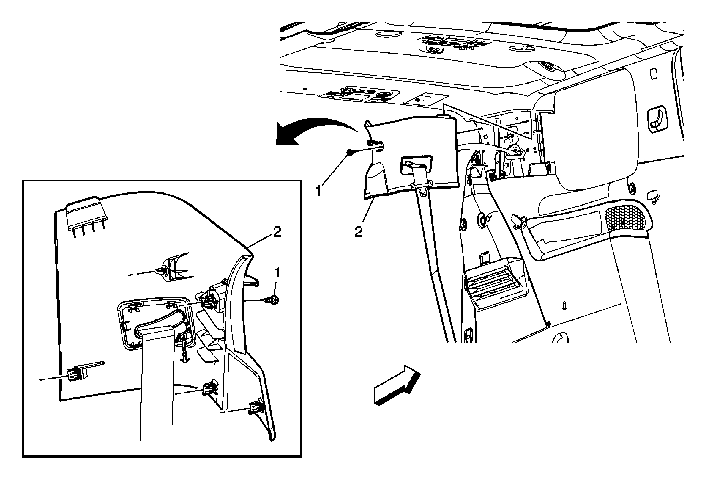

To do that you can follow the instructions in the images below.

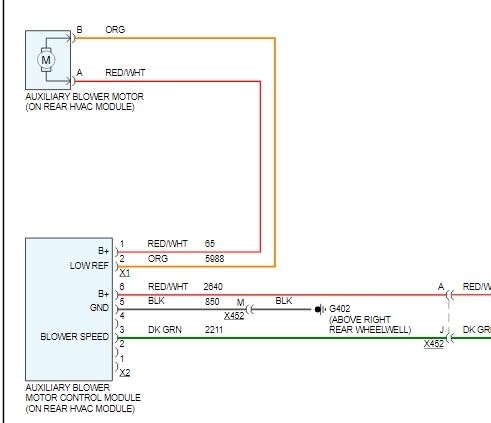

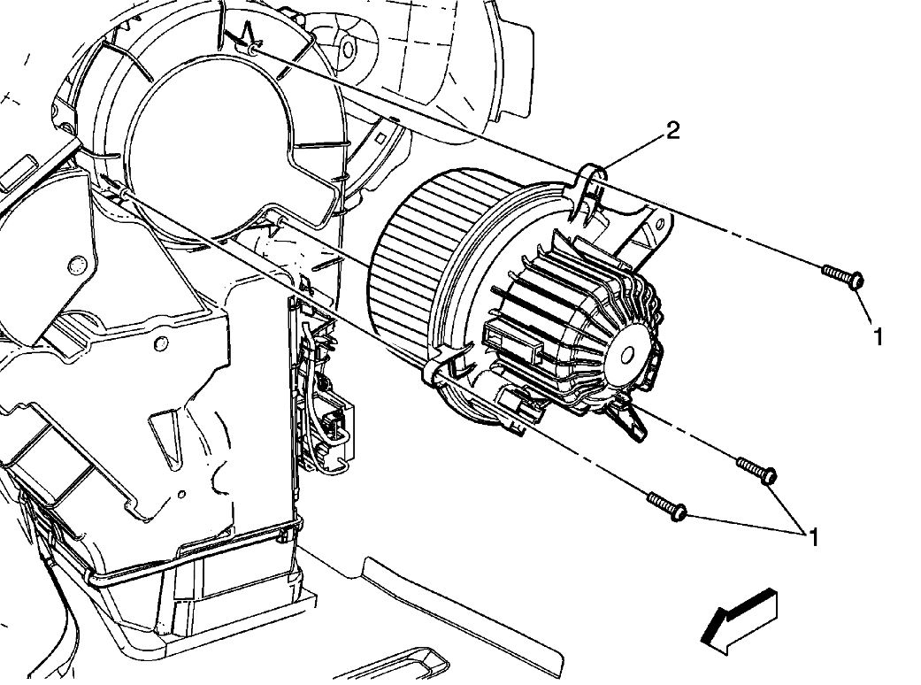

First is the upper trim piece. Followed by the lower quarter trim panel. Once those panels are off the AC unit is in the open. The blower motor is at the top and the controller is midway up the rear edge. The blower comes out with a few screws and the wiring connector. To test the blower motor you can use a couple pieces of wire and the battery, if it spins up OK then check for battery voltage at the Red wire with a White stripe going into the speed controller. If there is voltage there and you have a good ground the controller is suspect. Or the signal from the front controls. Those can be tested but you need an oscilloscope to do it correctly.
