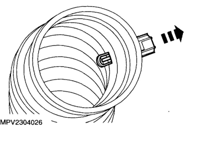

We show an air intake sensor in the main air intake tube between the throttle body and the air filter.
Here is a guise and a diagram to help you get the problem fixed.
https://www.2carpros.com/articles/replace-an-air-intake-boot
