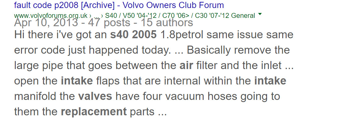

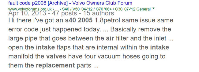

Unfortunately you have a 1.8L which in the US is not available and the info I sent was for a 2.4L, dummy me for not looking.however I did look online and found what is in the pic that may lead in the right direction.
