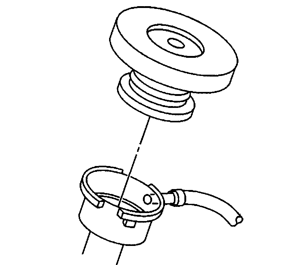

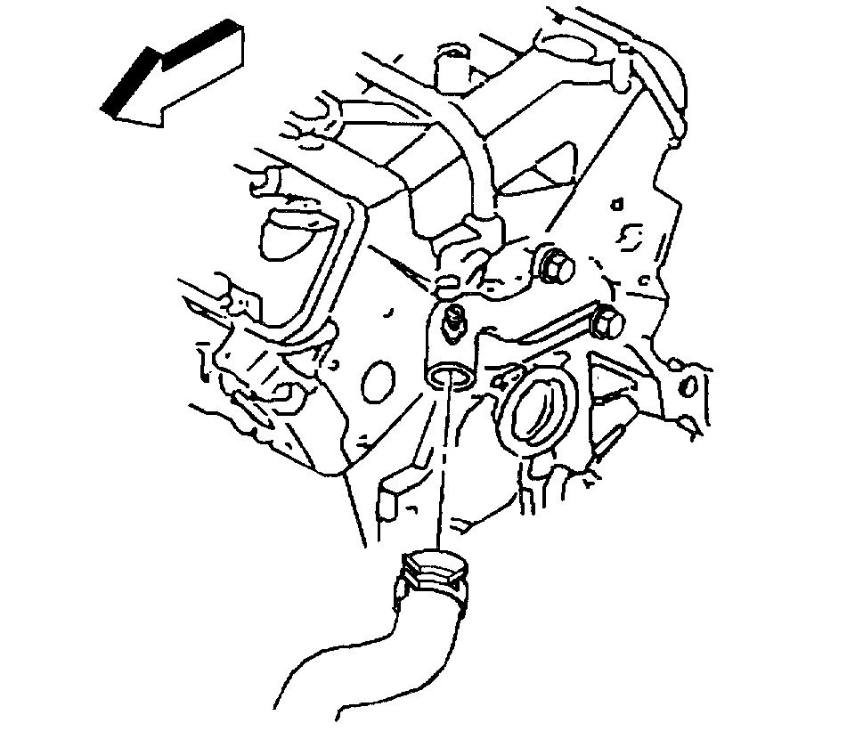

Picture 1
1. Remove the air cleaner and duct assembly. Refer to Air Filter Element Replacement in Computers and Controls.
2. Drain the coolant until the coolant level is below the thermostat. Refer to Draining and Filling Cooling System.
3. Remove the radiator hose from the thermostat housing. Refer to Radiator Hose Replacement - Inlet.
4. Remove the thermostat housing bolts and clean any sealer from the bolt threads.
5. Remove the thermostat housing and gasket.

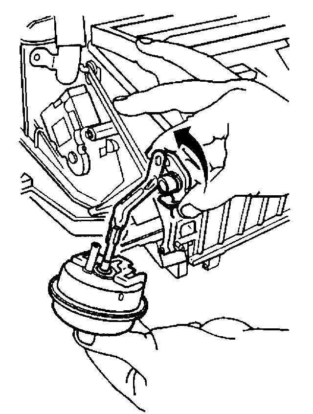

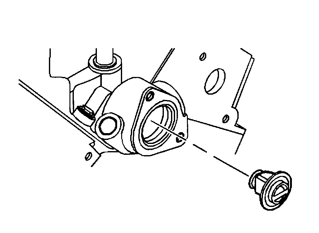

Picture 2
6. Remove the thermostat.
7. Clean the mating surfaces.

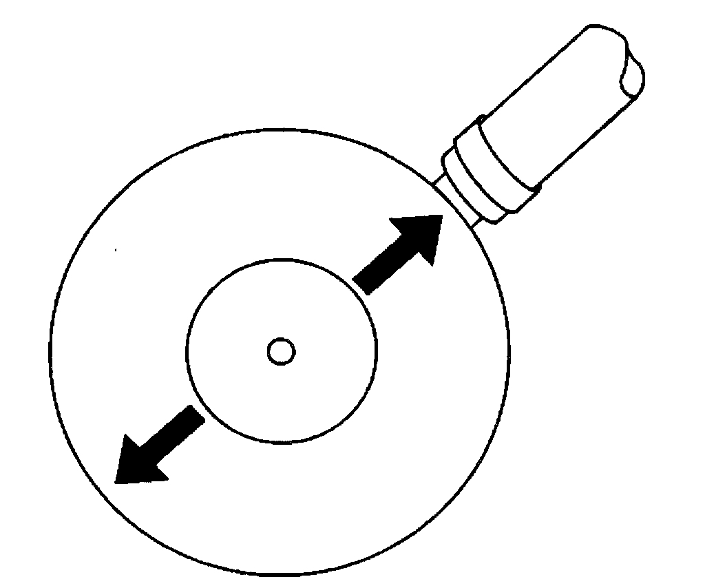

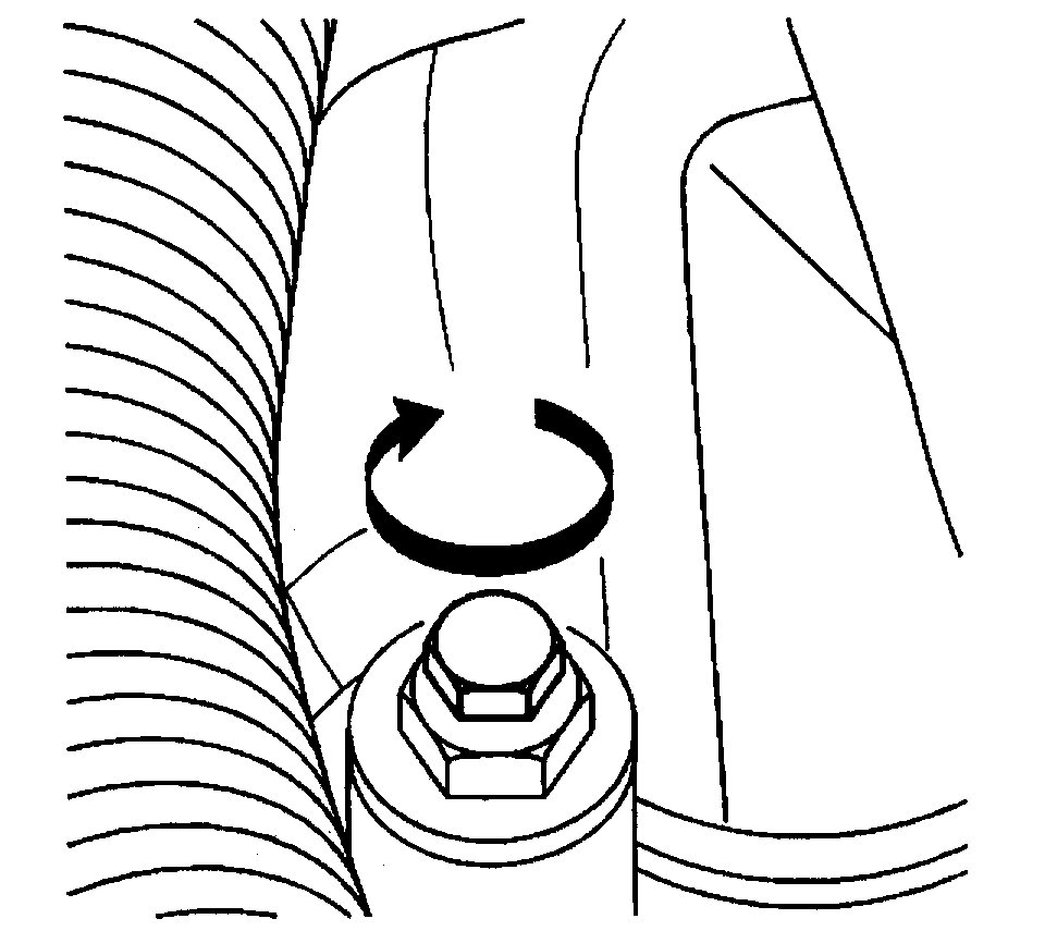

Picture 3
1. Install the thermostat.

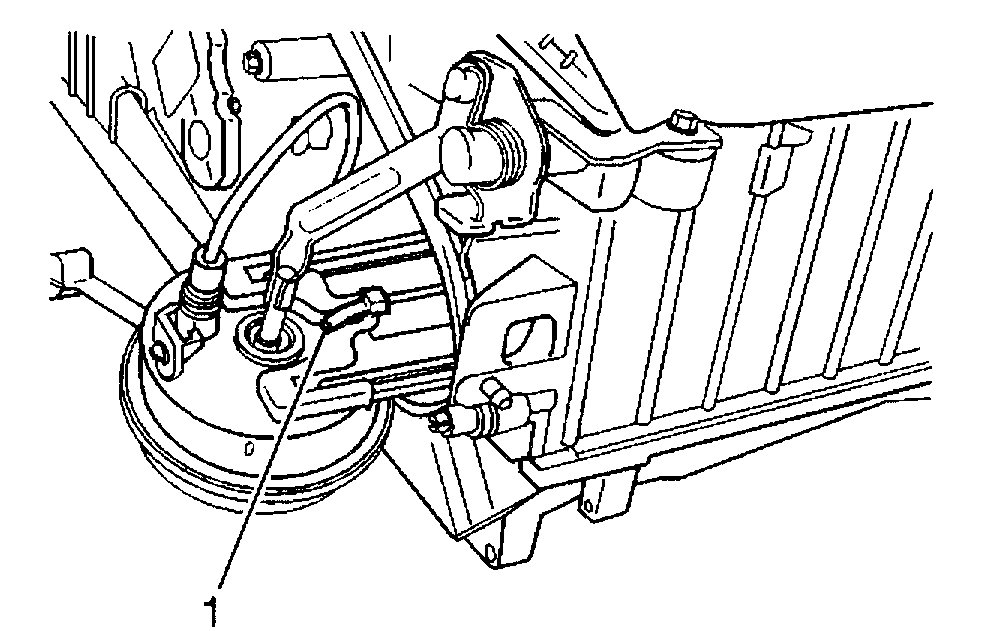

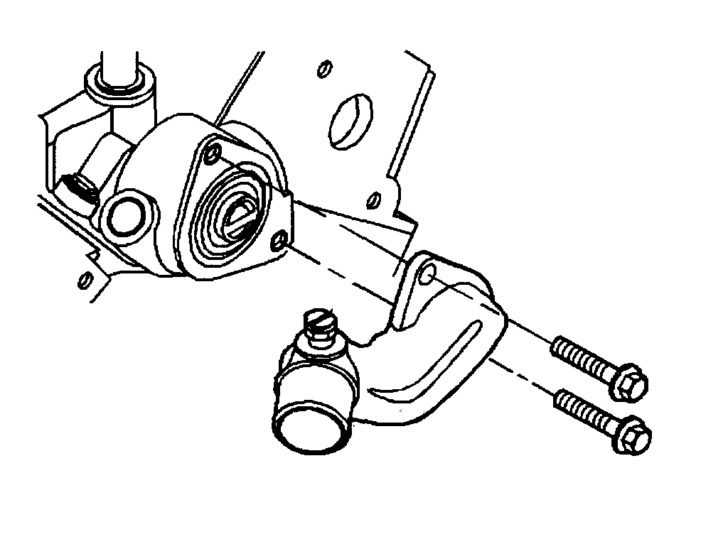

Picture 4
2. Install the thermostat housing and gasket.
3. Install RTV sealer (GM P/N 1052366 or the equivalent) to the thermostat housing bolt threads.
Notice: Refer to Fastener Notice in Service Precautions.

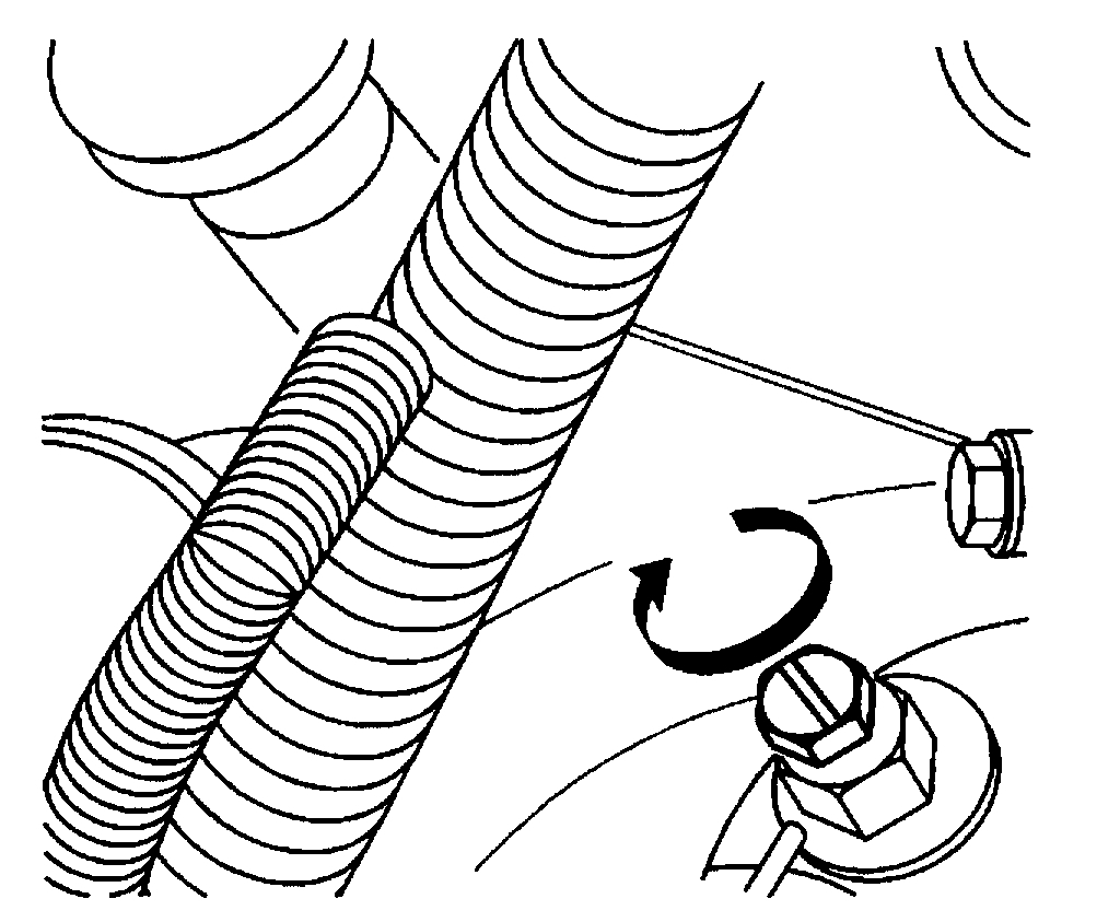

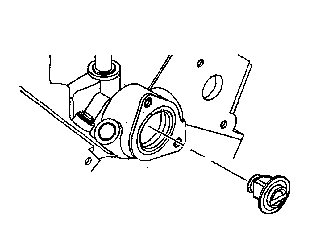

Picture 5
4. Install the thermostat housing bolts.
^ Tighten the bolts to 25 Nm (18 ft. lbs.).
5. Install the radiator hose to the thermostat housing. Refer to Radiator Hose Replacement - Inlet.
6. Install the air cleaner and duct assembly. Refer to Air Filter Element Replacement in Computers and Controls.
7. Fill the cooling system. Refer to Draining and Filling Cooling System.
8. Inspect the cooling system for leaks. Repair as necessary.

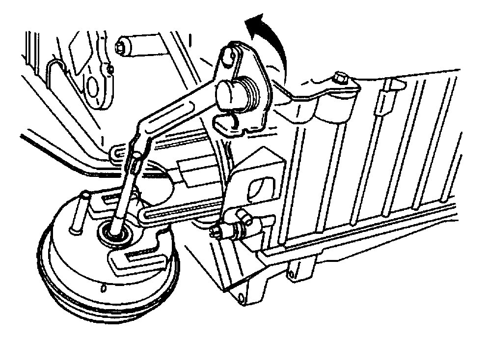

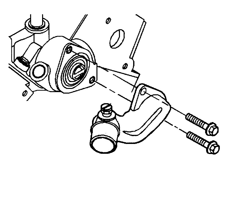

Picture 6
1. Remove the left instrument panel insulator.
2. Remove the knee bolster from the instrument panel.
3. Disconnect the vacuum lines from the mode valve vacuum actuator.
4. Cut the tie strap (1) that is on the back side of the mode valve vacuum actuator.
