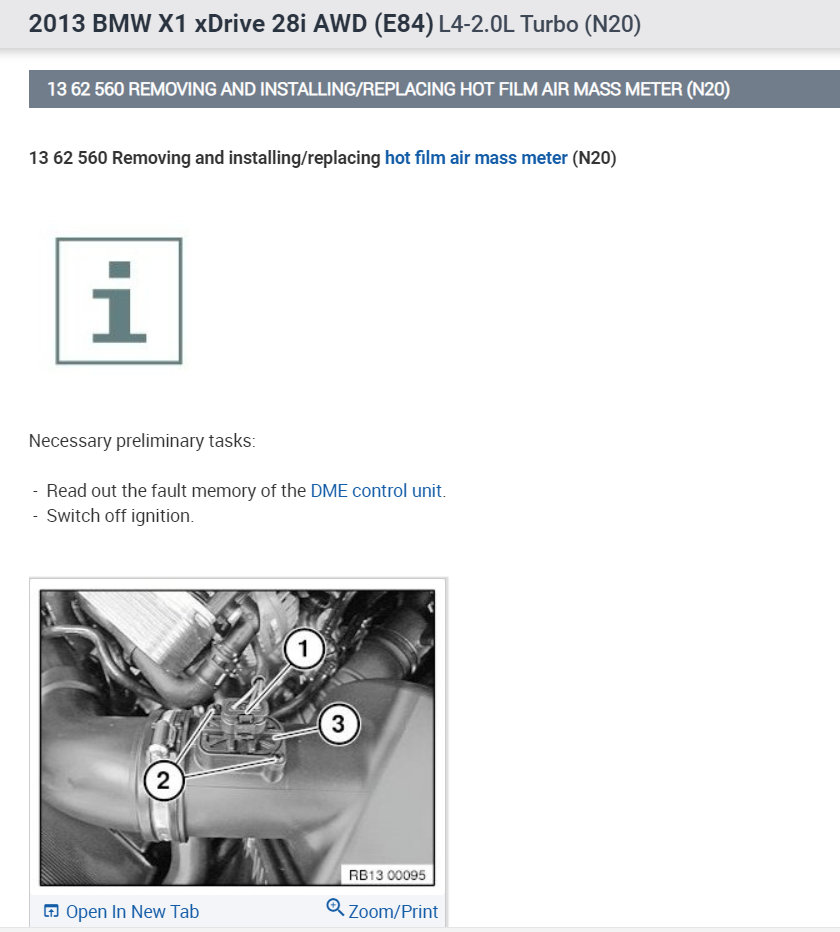

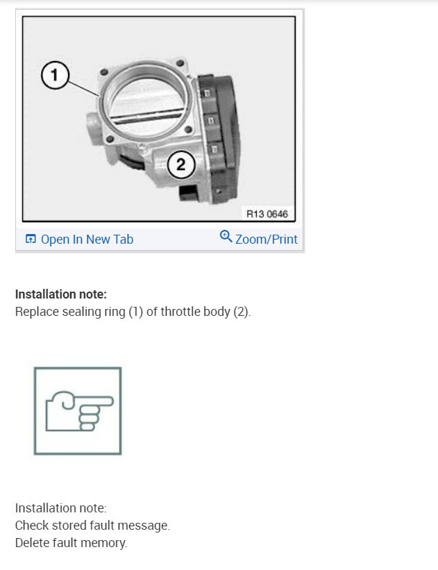

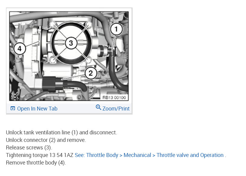

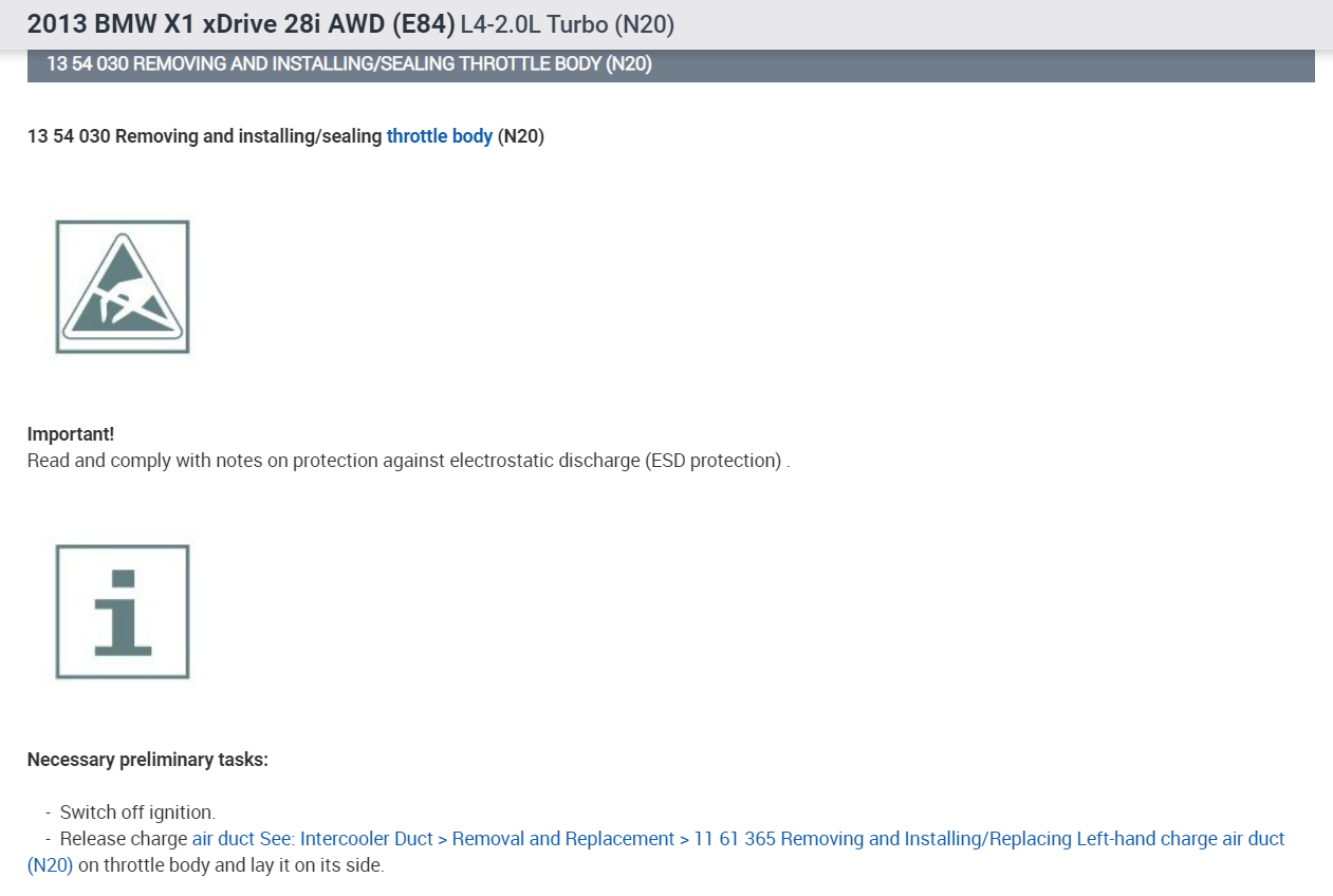

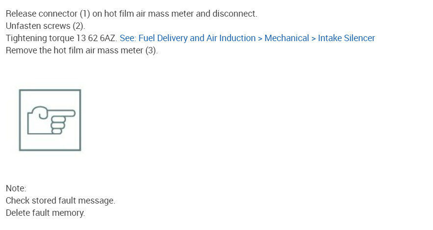

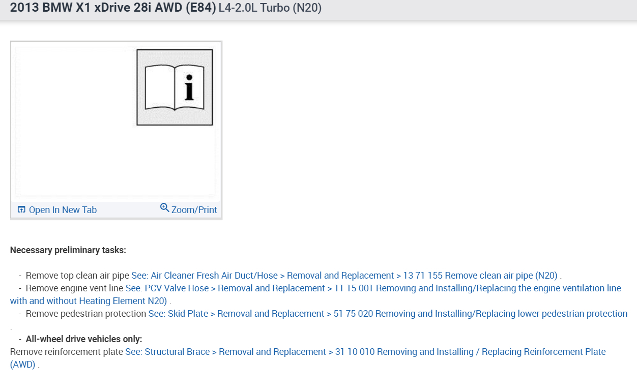

Thanks for the videos, this sounds like you have a vacuum leak which I have heard these cars can crack the valve cover, also I would service the throttle body, this would account for the P2774 code. I would also get some MAF cleaner to service that is well, check for a vacuum leak when the engine is cold only, and then go over these guides to help us find the problem.
and
and
https://www.2carpros.com/articles/mass-air-flow-service

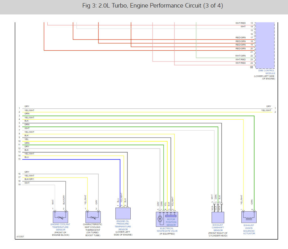

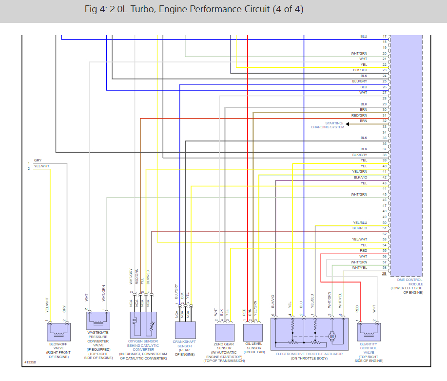

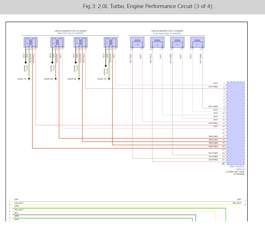

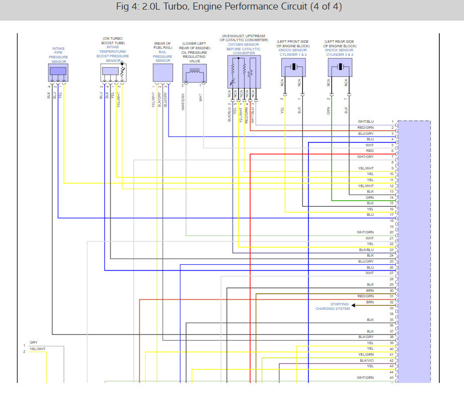

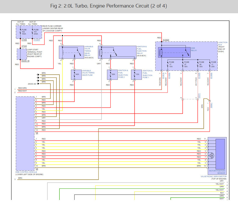

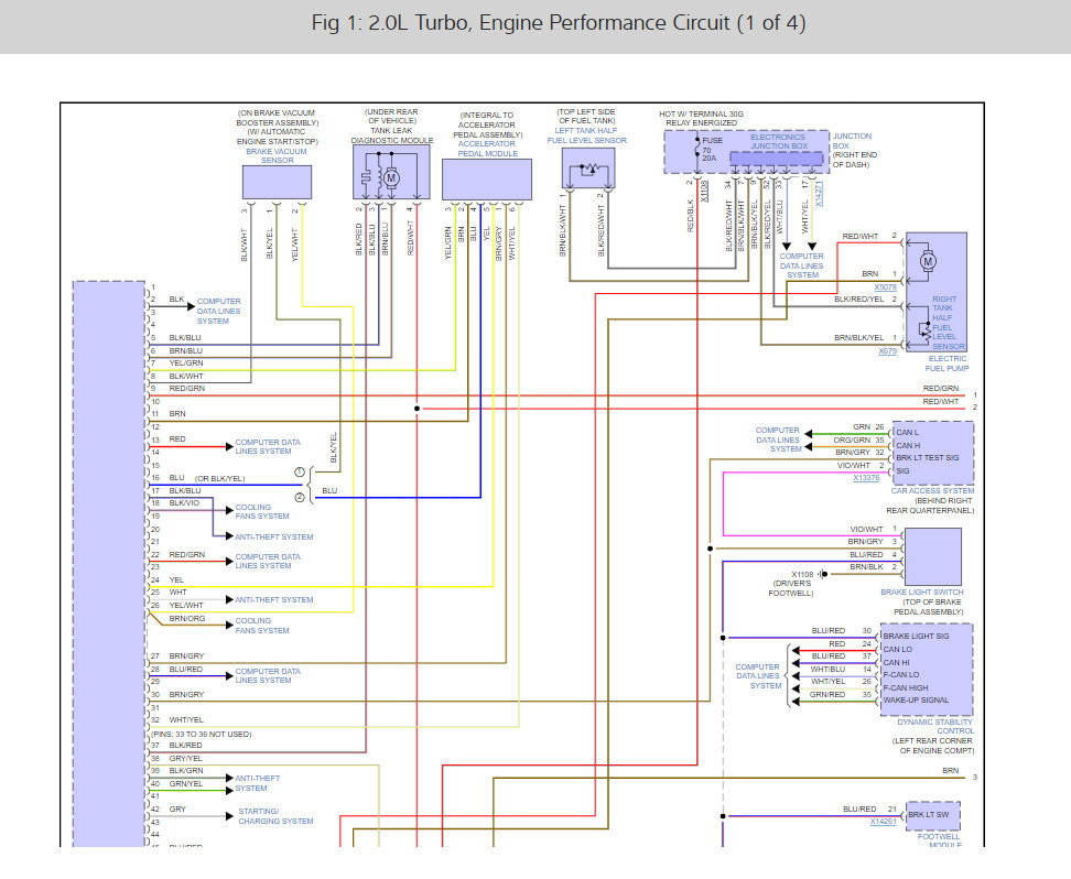

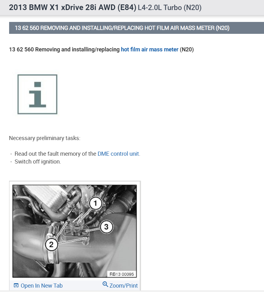

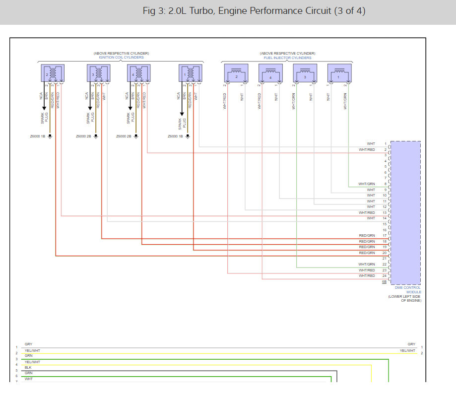

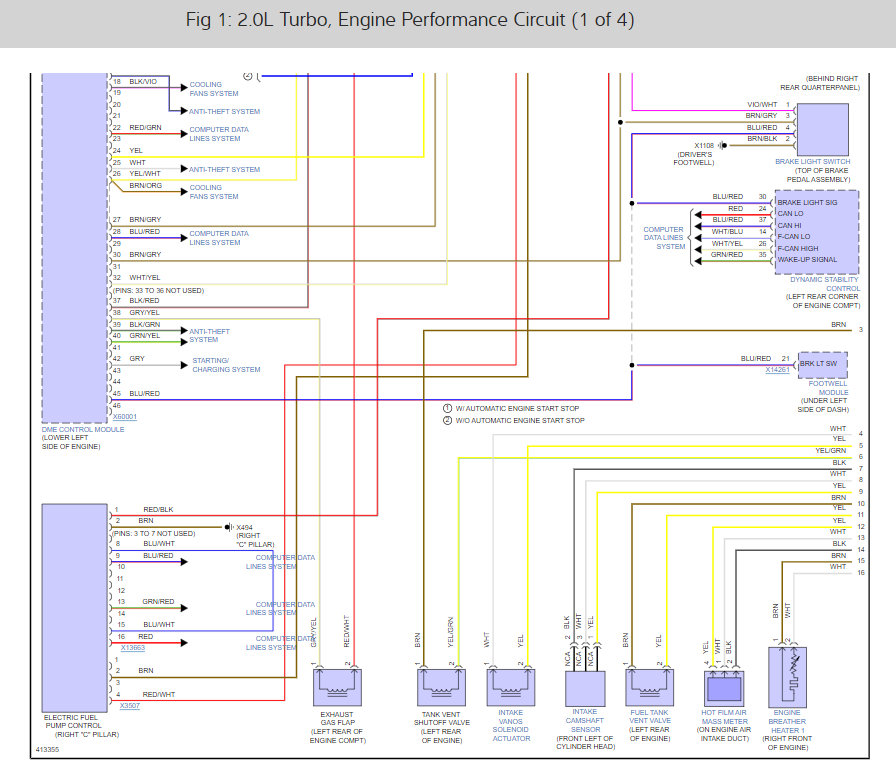

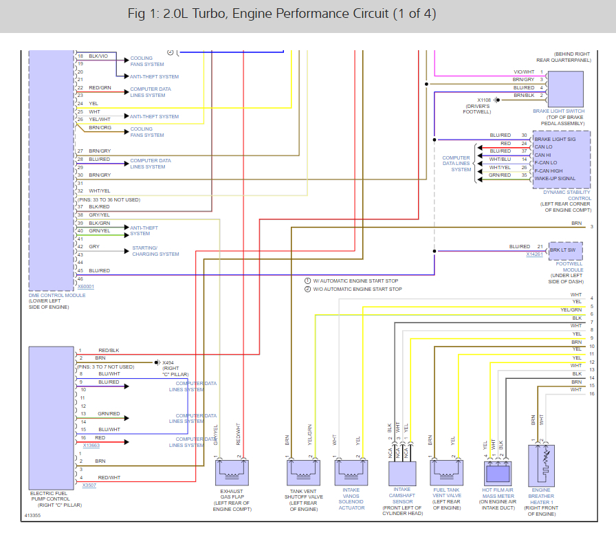

It looks like you have a problem with the wiring for the MAF sensor or the connector is having problems. Here is a guide to help you test the connections and the MAF wiring diagrams to help with the test. Also, cleaning the sensor will not work if the sensor is bad. so, I would try a new sensor first.

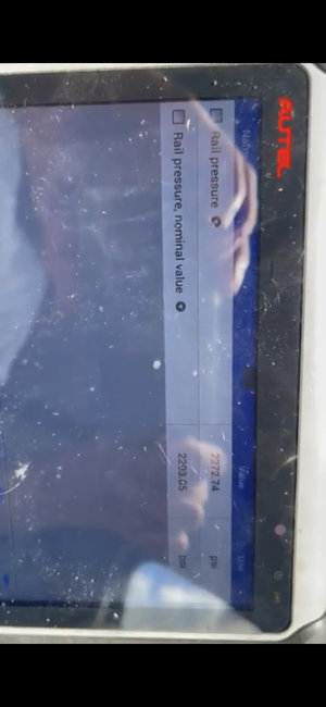

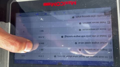

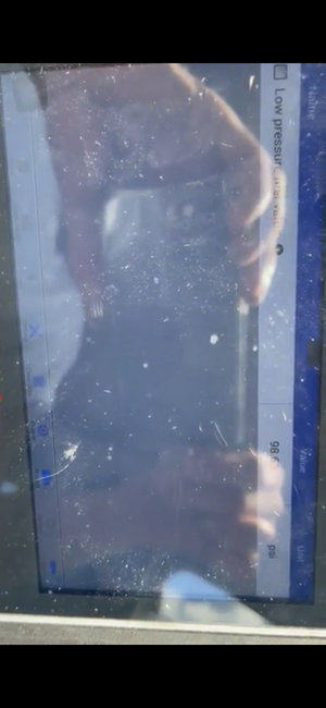

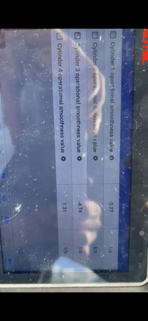

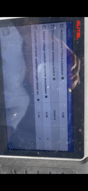

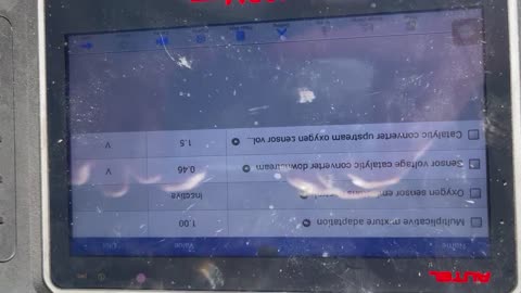

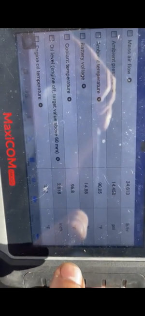

Here are some numbers when cold.
Aug 29, 2022 at 2:07 PM
I can't see the numbers because the phone needs to be on landscape position.
Aug 30, 2022 at 12:17 PM
BHAMDOC1973
  • 2,008 POSTS
I watched it on my phone sideways, no issues.

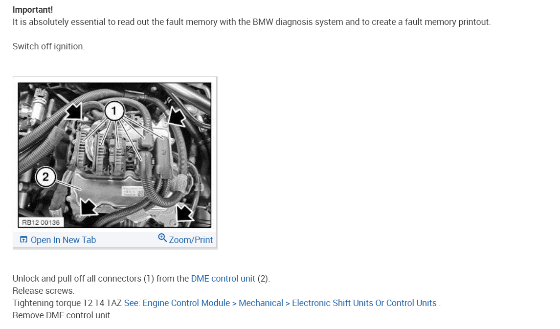

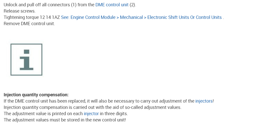

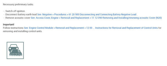

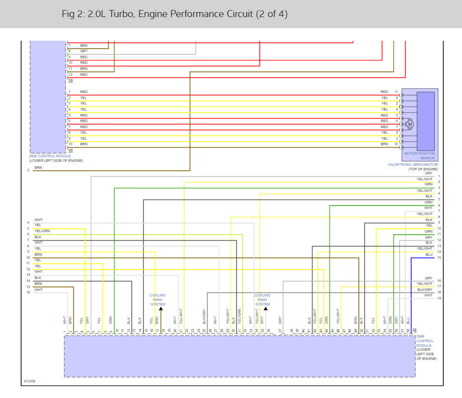

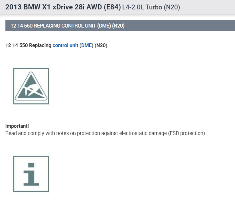

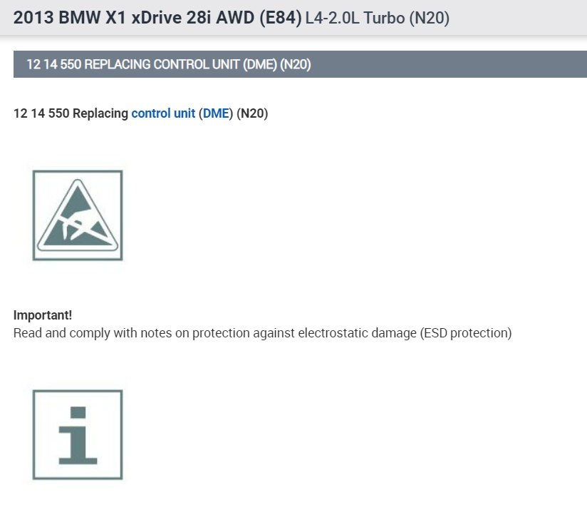

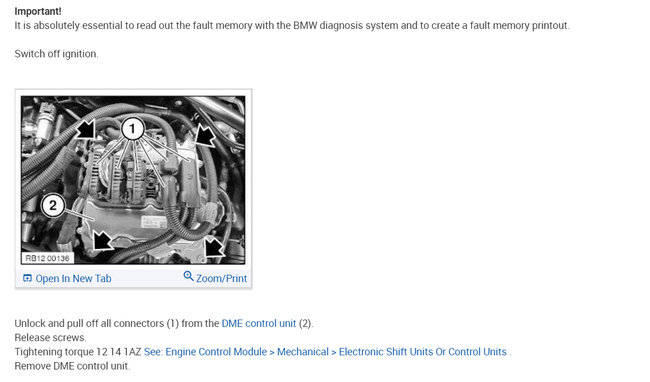

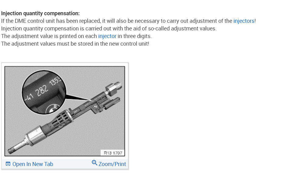

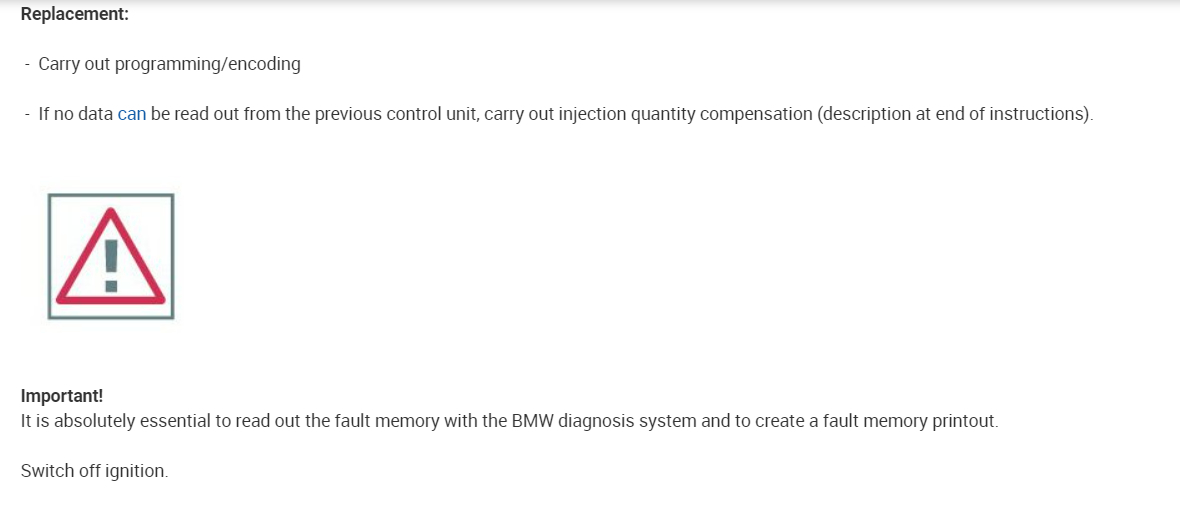

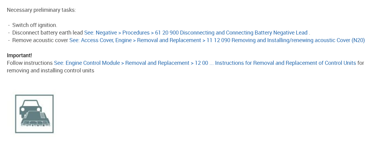

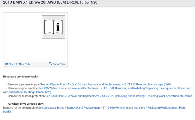

Thanks for the reload, I'm on desktop. With all these codes I would say the DME is bad. Here is how you can replace it.

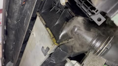

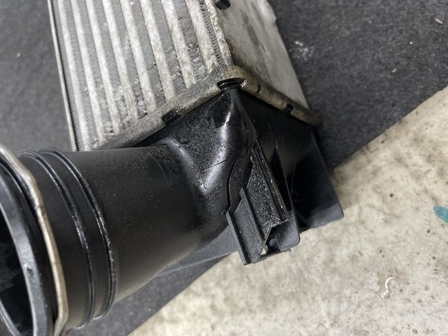

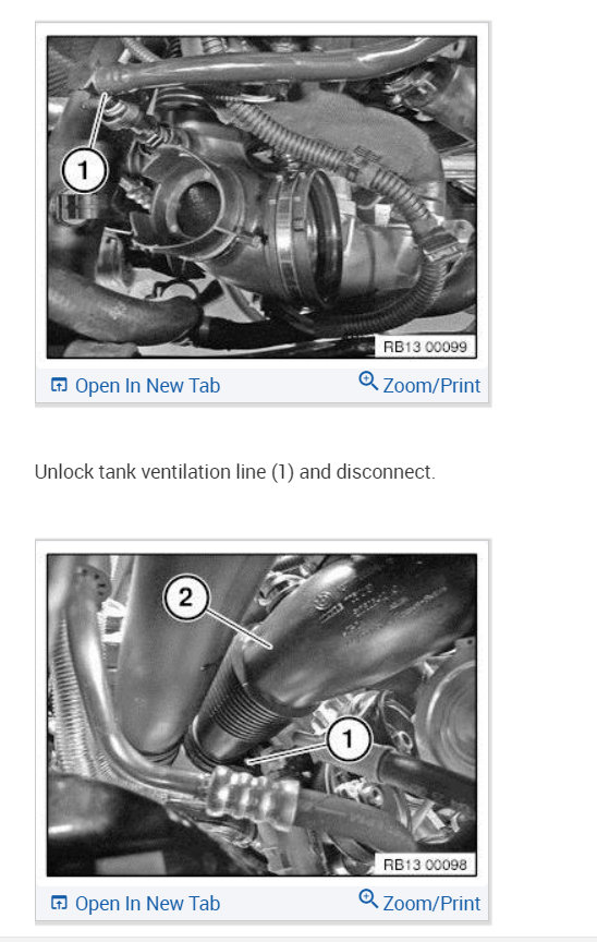

I found this leak, just not sure what can be causing it, looks like it's a bot broken but not sure if it's the whole thing on bottom, isn't this the air cooler?
Sep 2, 2022 at 8:31 AM
BHAMDOC1973
  • 2,008 POSTS
Via smoke test. Thats got to be it.
Sep 2, 2022 at 8:34 AM
Yep, you found it nice work. ;) When you get it apart can you please unload images of the broken part/damage?
Sep 3, 2022 at 8:48 AM
BHAMDOC1973
  • 2,008 POSTS
Cracked.
Sep 3, 2022 at 9:33 AM
Nice work, we are here to help, please use 2CarPros anytime.
