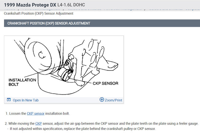

Not starting, rough idle when running. When replacing crank position sensor does it require an air gap?
Jan 16, 2024 at 7:17 AM
CERTIFIED EXPERT
53,854 POSTS

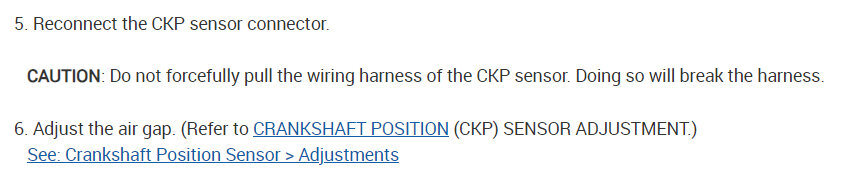

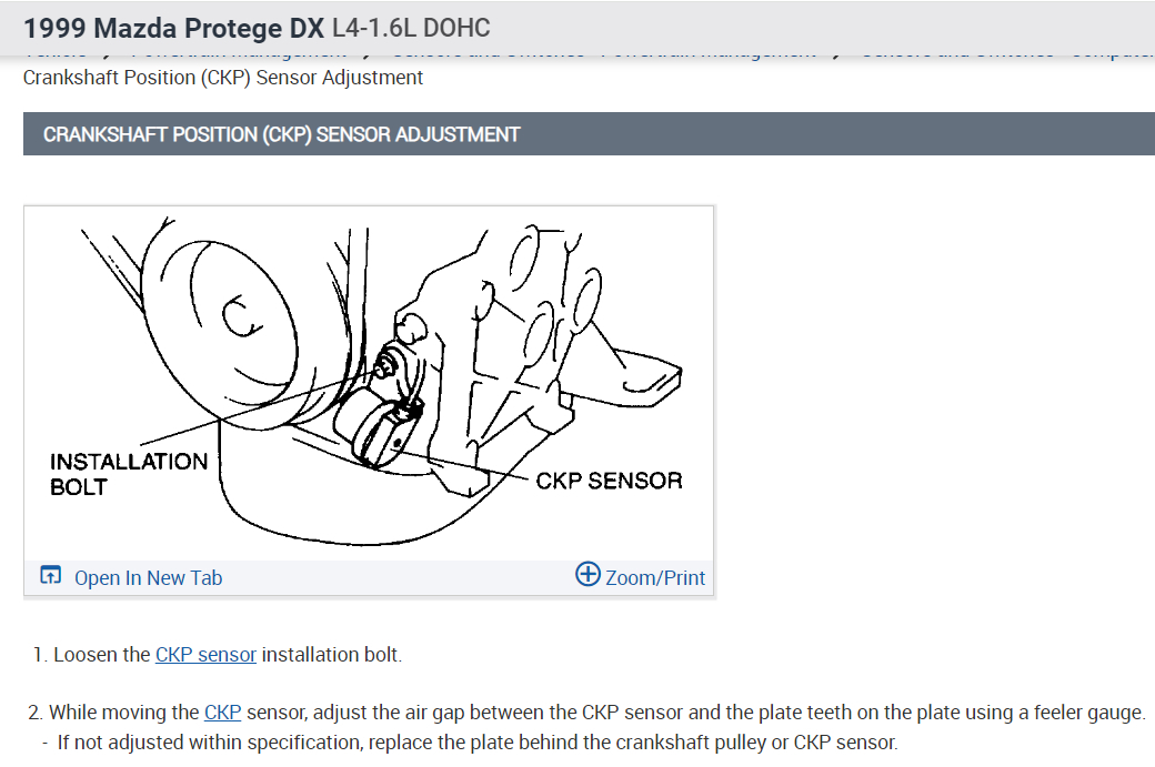

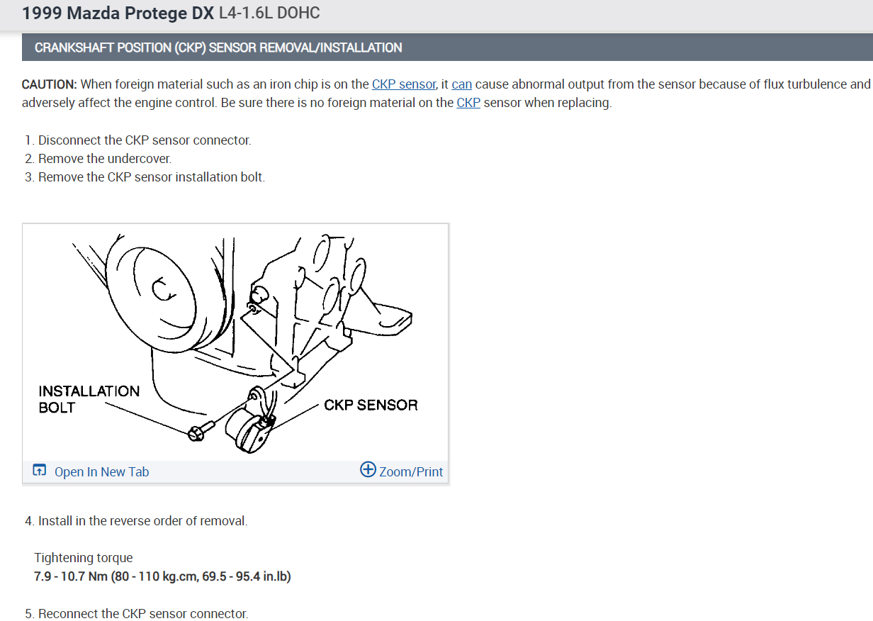

Yes, there is an air gap that must be observed to have the sensor work correctly.
Specification: 0.5 - 1.5 mm (0.020 - 0.059 in)
here is how the crankshaft sensor is replaced correctly. Check out the images (below). Let us know if you need anything else.
