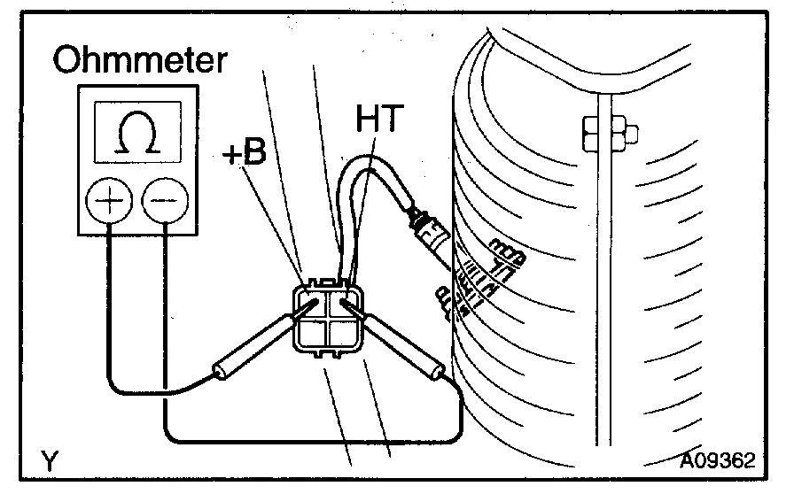

1. INSPECT HEATER RESISTANCE OF A/F SENSOR (Bank 1 Sensor 1)
a. Disconnect the sensor connector.
pic 1

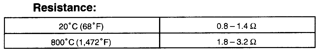

b. Using an ohmmeter, measure the resistance between terminals +B and HT.
pic 2
If the resistance is not as specified, replace the sensor.
