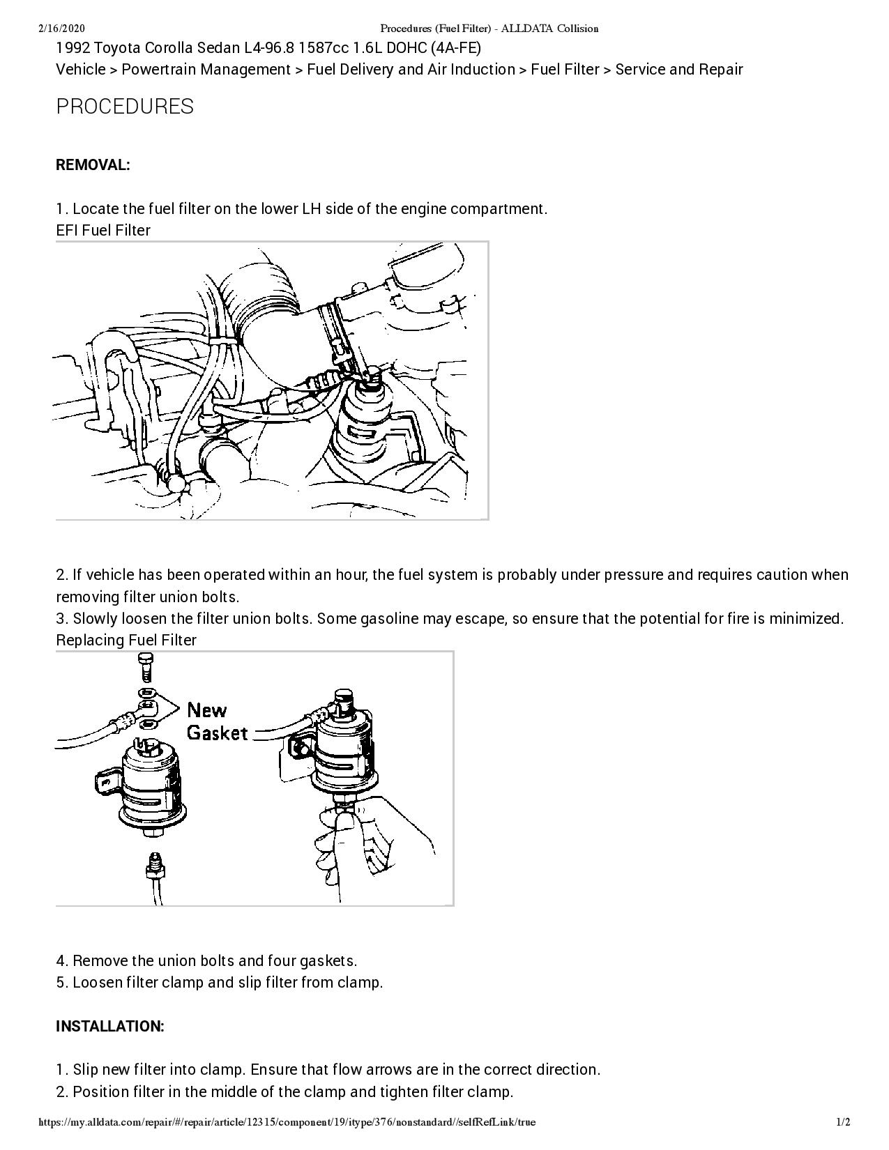

I have attached instructions below on how to remove the spark plugs and it also shows specs for the gaps.
If not recently replaced i would advise starting by changing out the old spark plugs.
The next items to check will be the air filter and fuel filter.
I have attached the procedure for replacing the fuel filter, if this has not been recently replaced please also replace this and retest.

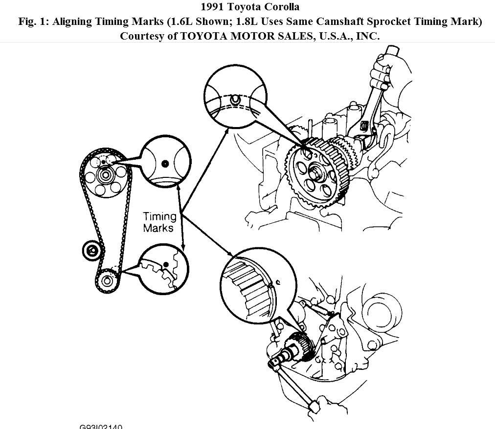

I check on the link you gave/type to me & it was legit to check it & experience it out. Also, when I totally took out the timing cover & check the top crank wheel above it didn't move nor rotate when I crank it to see movement? What do I do now? Do I open also to check the lower level of the belt below to see it the timing belt is warp out? & may I kindly know how to do the (TDC) for My Vehicle? Thank you...
Jan 21, 2021 at 2:52 PM (Merged)
KHLOW2008
  • 41,814 POSTS
When the top do not move while the crankshaft is being turned, the timing belt is bad. Push at the belt to check for deflection and if it has a lot of slack, the belt has stripped a few tooth.
You would need to remove the crank pulley and lower cover to replace the belt.
Diagram shows the timing marks.
MICHAELLSJ
  • 27 POSTS
To: KHLow2008,
Ok will do, also I haven't move it fully will take it apart below to checkout the lowerside of the belt. Do I open also to check the lower level of the belt below to see it the timing belt is warp out? Thank You.

Is it Possible to Turn the Gear Wheel on Top that Holds the Timing Belt With A Socket Wrench? To (TDC) it.? With The Diagram You Send to Me?
Thank You!
07/19/2013
10pm gmt
KHLOW2008
  • 41,814 POSTS
Yes, you can use the bolt holding the cam sprocket to turn the camshaft. Turn the vrank away from TDC by about 20 degrees first and after getting the camshaft timing correct, turn the crank back to TDC.

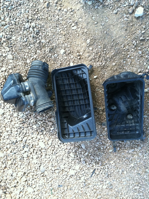

I have a 1991 Corolla 1.6 automatic, I am having a problem when i accelerate to fast the engine cuts in and out. It never stalls. At full throttle it will run for a second then cut off for a second. I have replaced the fuel pump, tps, distributor and I replaced the speed sensor. There are no codes.
RASMATAZ
  • 75,992 POSTS
Test the airflow meter-let me know
JASONZAIDA
  • 4 POSTS
Doesn't have one, it has a air charge temp sens.
RASMATAZ
  • 75,992 POSTS
Airflow Meter On air intake, on left side of engine compartment
JASONZAIDA
  • 4 POSTS
I have taken the airbox and tube off and there is no air flow meter, is it between the box and the intake.
RASMATAZ
  • 75,992 POSTS
Its on the air intake
JASONZAIDA
  • 4 POSTS
This is the air intake, no meter.
MMPRINCE4000
  • 8,548 POSTS
It has a MAP sensor on rear of intake. Check the vacuum line to it, if leaking it will cause the problems you describe.

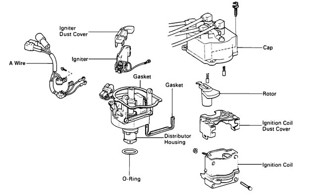

I have a 1990 toyota corolla, when you first get in the car and drive for about 2 miles the car shutters and then dies, like you just turned off the fuel, but let it sit for just a moment i will restart and go alittle further then do it again, sometime for 3 to 5 more times, then it just quits acting up and drive fine the rest of the time. at first i thought it was the fuel pump but ruled that out, its almost like it gets vapor locked, could this be some kind of sensor causing this, someone told me that they believe there is something that i can spray into the inlet of where the fuel line enters the carbarator or should i be looking for something else. i had a diagnostics done with no hits
Jan 21, 2021 at 2:53 PM (Merged)
MMPRINCE4000
  • 8,548 POSTS
Sounds more like the ignitor in the distributor. When this happens again, spray some starting fluid in the intake, if it runs a few seconds, it is fuel related, if not it is ignitor, coil.
