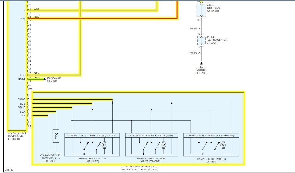

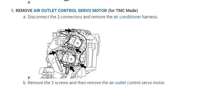

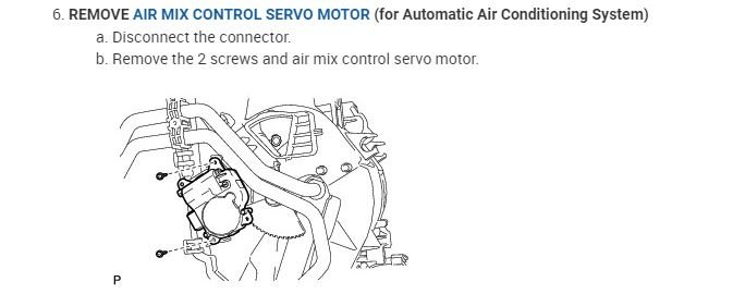

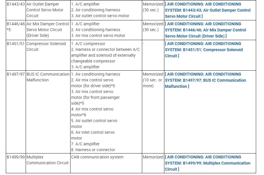

My FIXD OBD puts out code B1241. I also have a Maintenance Required Indicator steady light, no blink. Trying to find a wiring diagram/schematic for system as well as the physical location of the suspected door. Please help.
Jul 18, 2020 at 2:12 AM
Good morning,

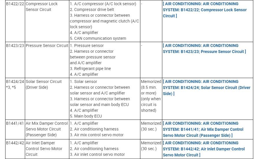

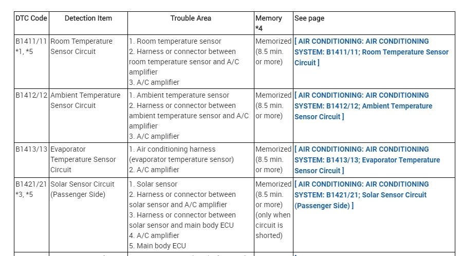

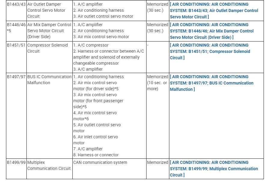

There is no code 1241 for the A/C system. I attached the full code chart for you to vie of all the codes. You may need a real scan tool for checking the code.
I attached the wiring for the actuators for the housing. They are mutiplex controlled by the module which means conventional testing will not work.
What is the actual issue you have with the system?
