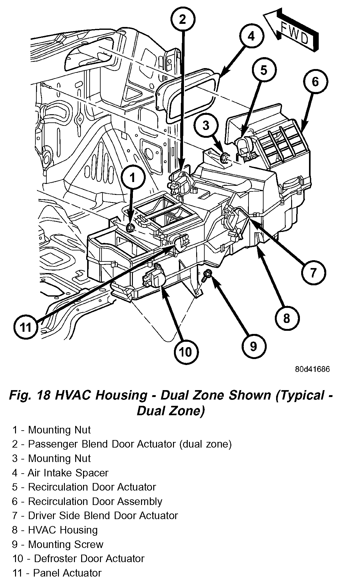

Fig. 18 HVAC Housing - Dual Zone Shown (Typical - Dual Zone)
see pic 11
4. Remove the two screws that secure the mode door actuators to the distribution housing. For single zone systems only lower actuator in present. For dual zone systems remove second actuator which is mounted on top of HVAC housing.
