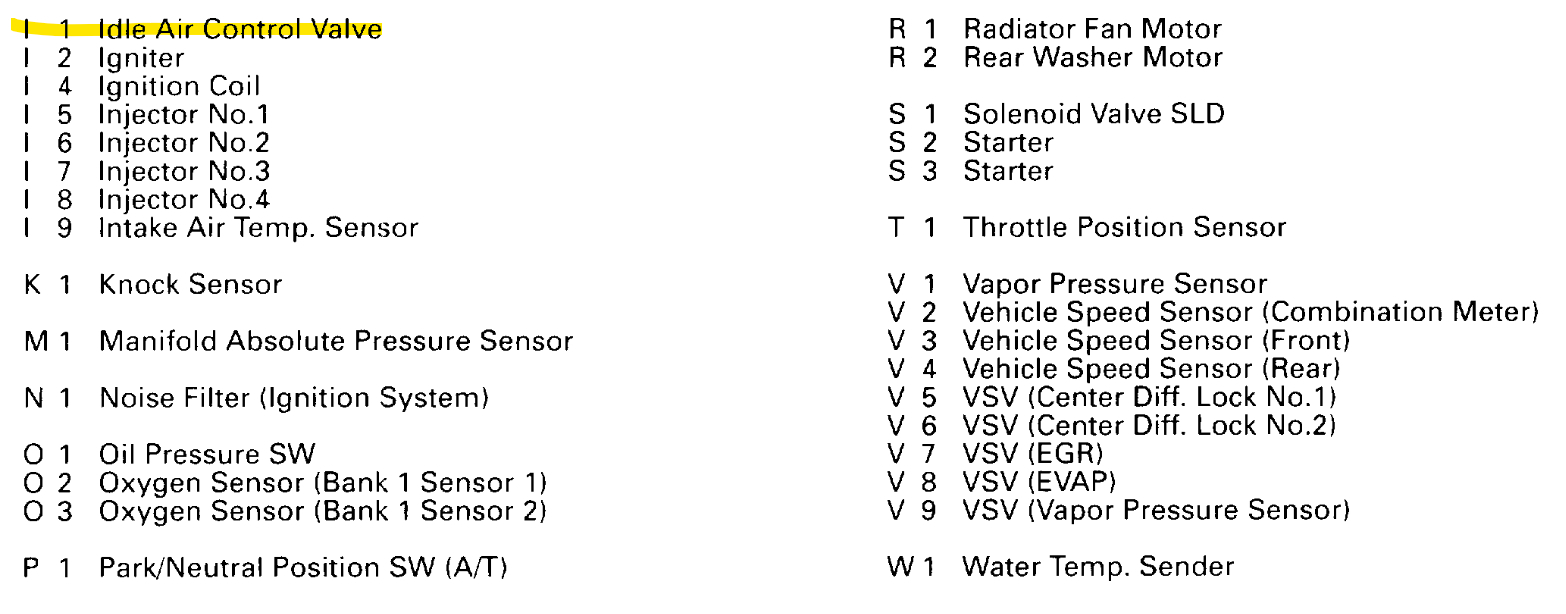

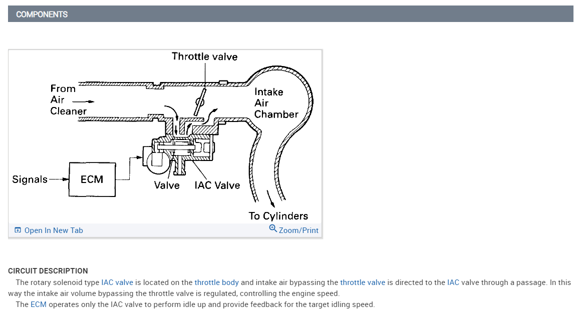

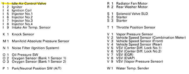

Hello, are you having an issue with the idle hunting up and down while the vehicle is stationary? You may have a vacuum leak, or some carbon build up in the Idle Air control valve.

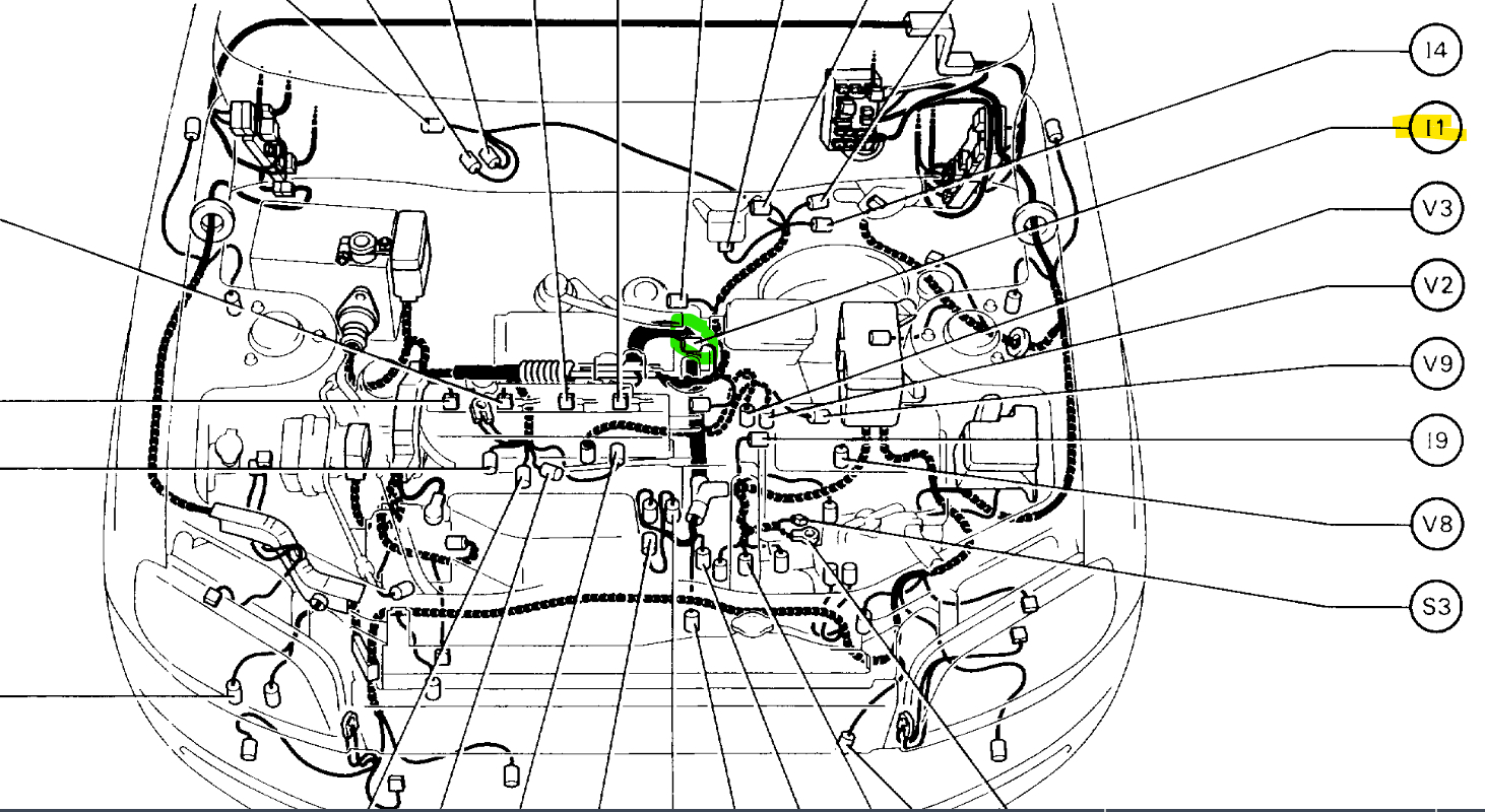

Here are some guides to help find a vacuum leak, and Ill see if I can find a diagram of the idle air control valve.

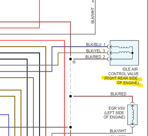

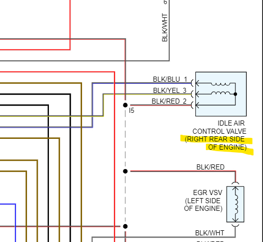

Below the diagrams will show where the Idle air control valve is and if you have trouble finding it, there is a wiring diagram (4th) that will help, its a 3 wire connector and the wiring diagram shows the colors of those wires. But look for any broken or leaking hoses or lines going to the intake manifold.

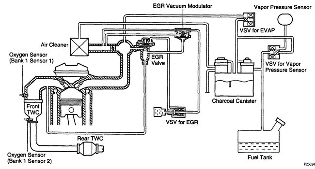

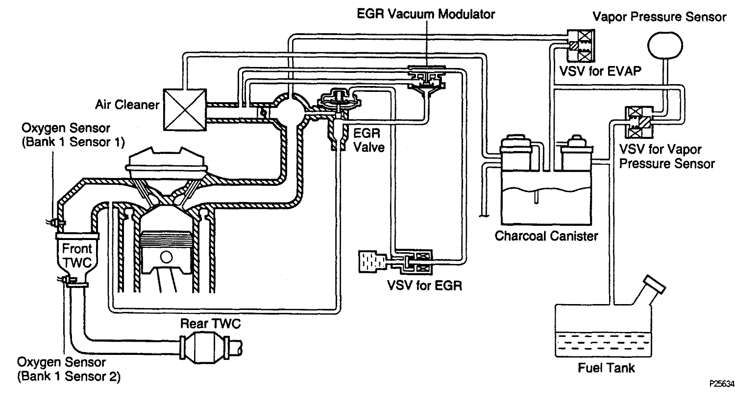

there is also a diagram of all the vapor and vacuum hoses (5th) that go to each component in the engine compartment.
