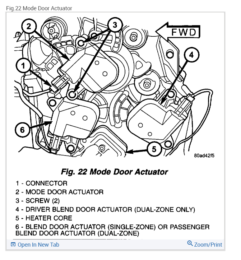

Blower motor works fine, can hear air flow but no air coming through any vents including defrost and heater.

It sounds like the mode blend door actuator is out. here is a guide that will walk you through the repair with diagrams and instructions below to show you how on your car:
