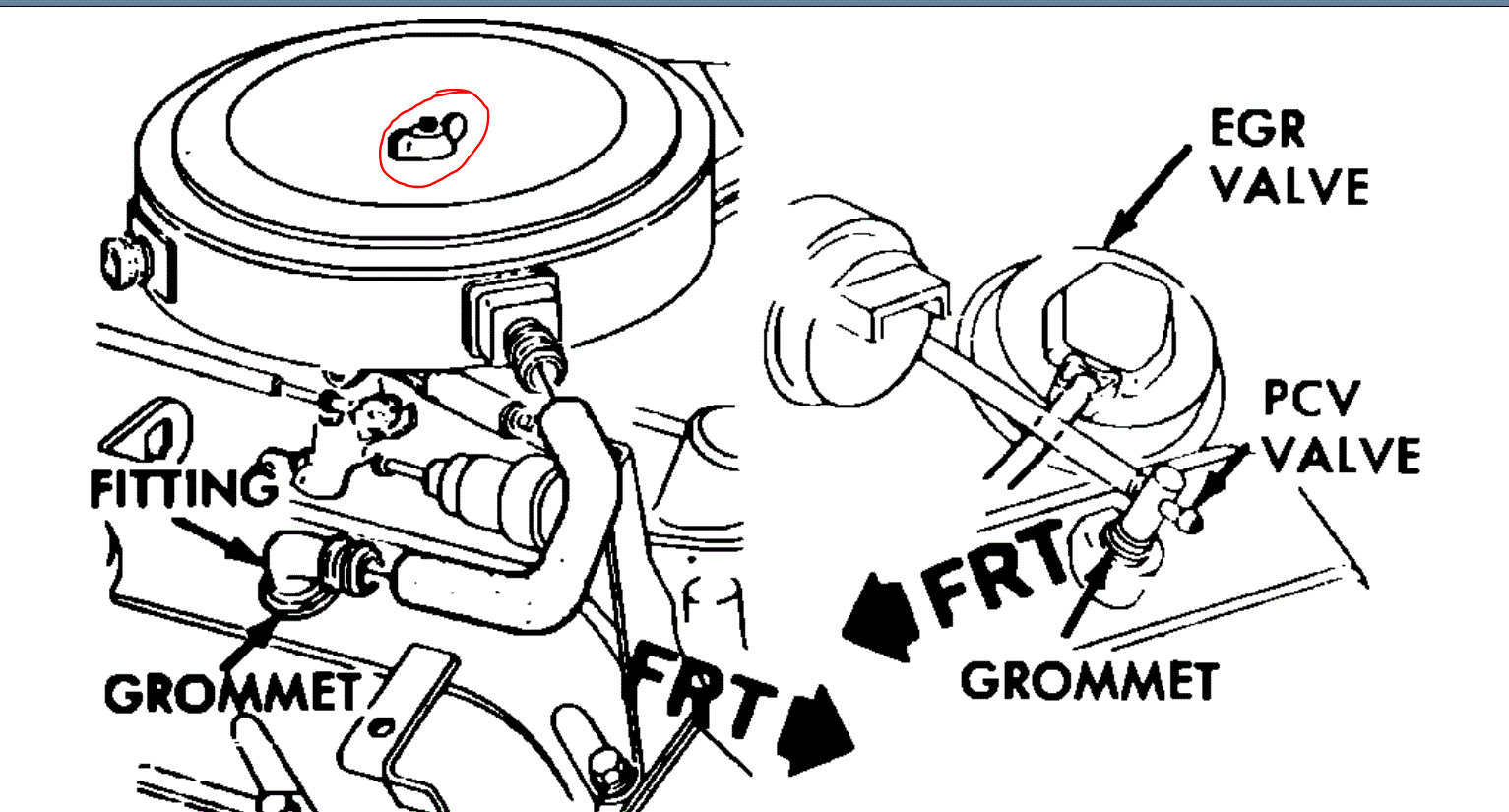

There should be a wingnut at the top center of the housing holding the lid in place. Remove that nut and remove the cover and air filter element. (See pic below)
Once they are removed, there are a few hoses that need to be disconnected including vacuum hoses under the assembly. I don't recall there ever being anything holding the housing onto the carb other than the aforementioned wingnut.

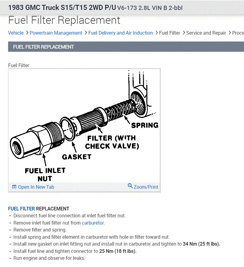

See pic below.
