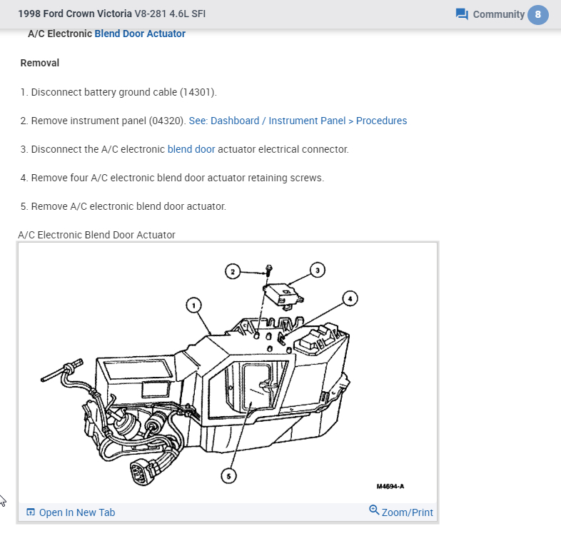

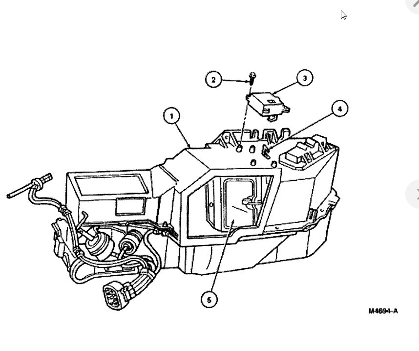

My car is a 1998 Lincoln town car brake masters said it was the motor blend door actuator . Can you tell me where that is located ?
Jun 18, 2019 at 7:19 AM

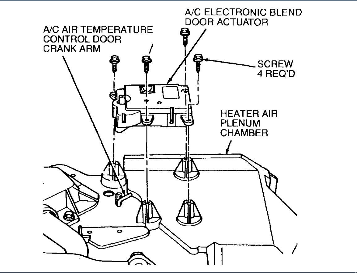

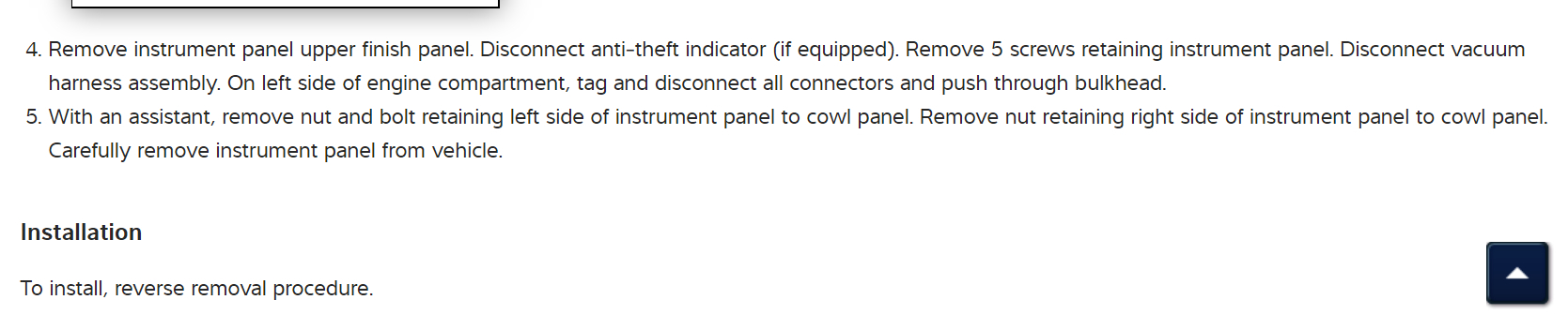

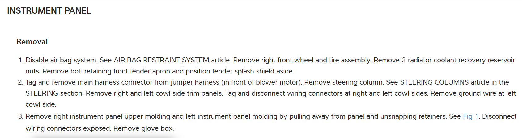

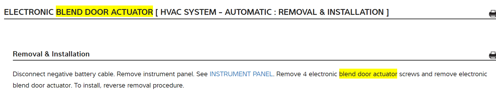

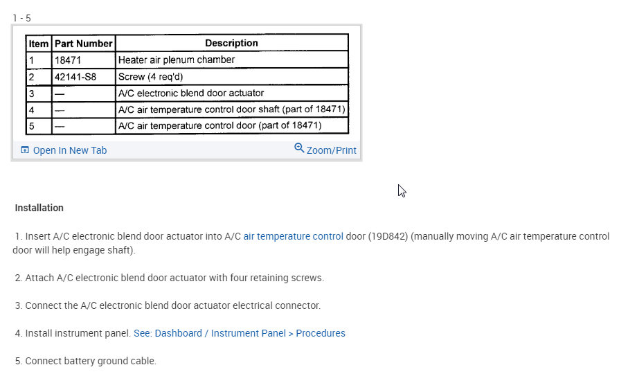

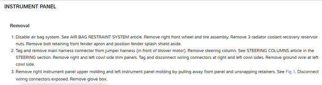

This is located on top of the HVAC housing. I attached the process on how to replace it. Please let me know if you need anything else. Thanks
Jun 23, 2019 at 11:53 AM
SCGRANTURISMO
  • 4,897 POSTS

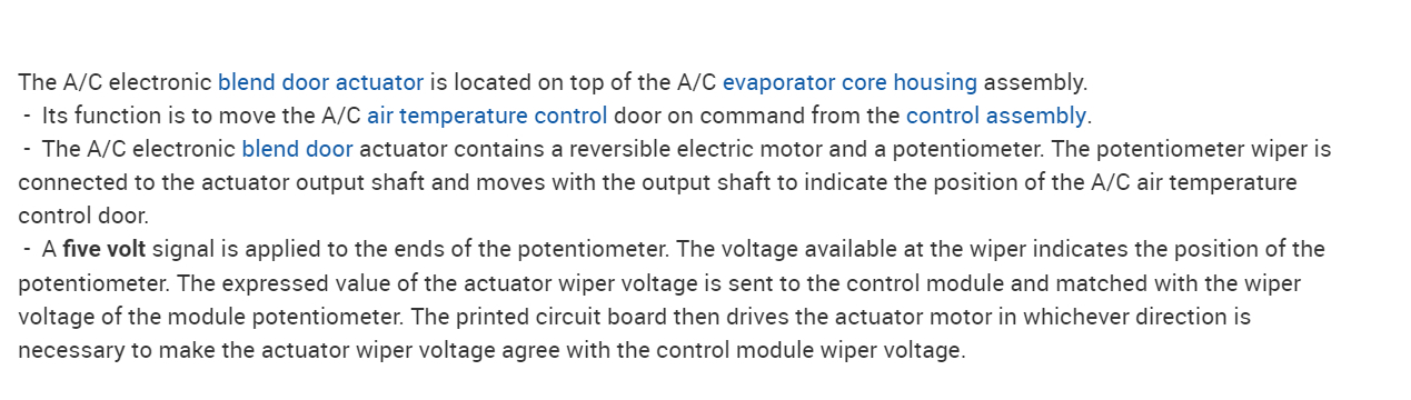

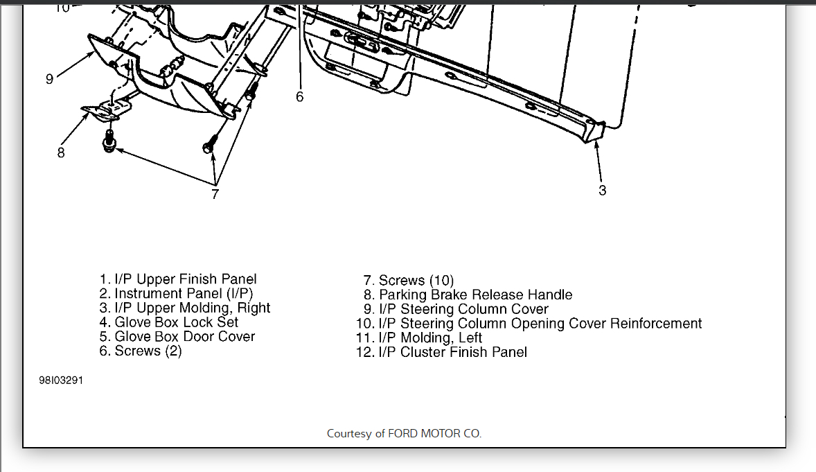

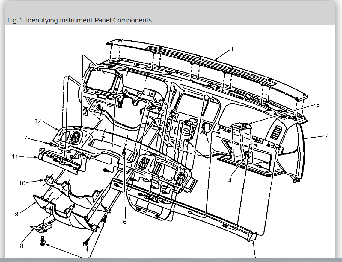

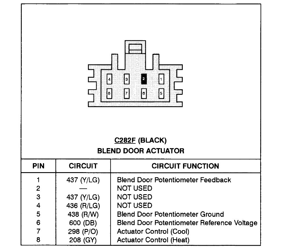

The information that you requested is in the diagrams down below. I have included the location, diagrams, electrical connector diagram, and removal and installation instructions in the diagrams down below for you. I have also included a link below for you to go to.
Please go through these guides and get back to us with what you are able to find out.
Thanks,
Alex
