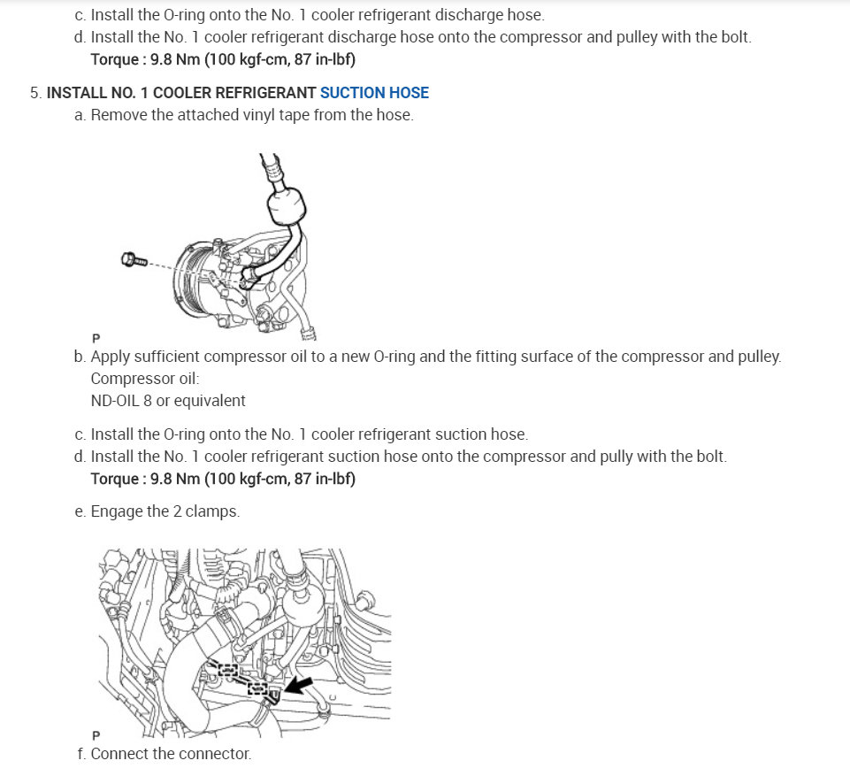

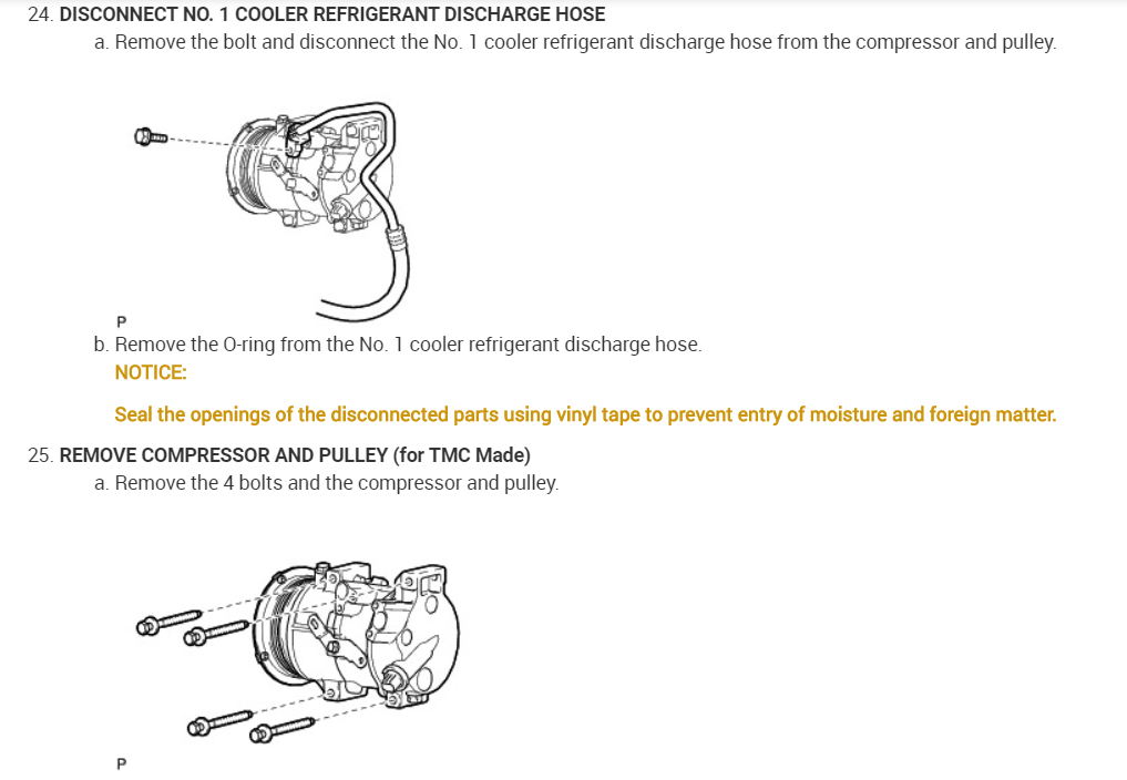

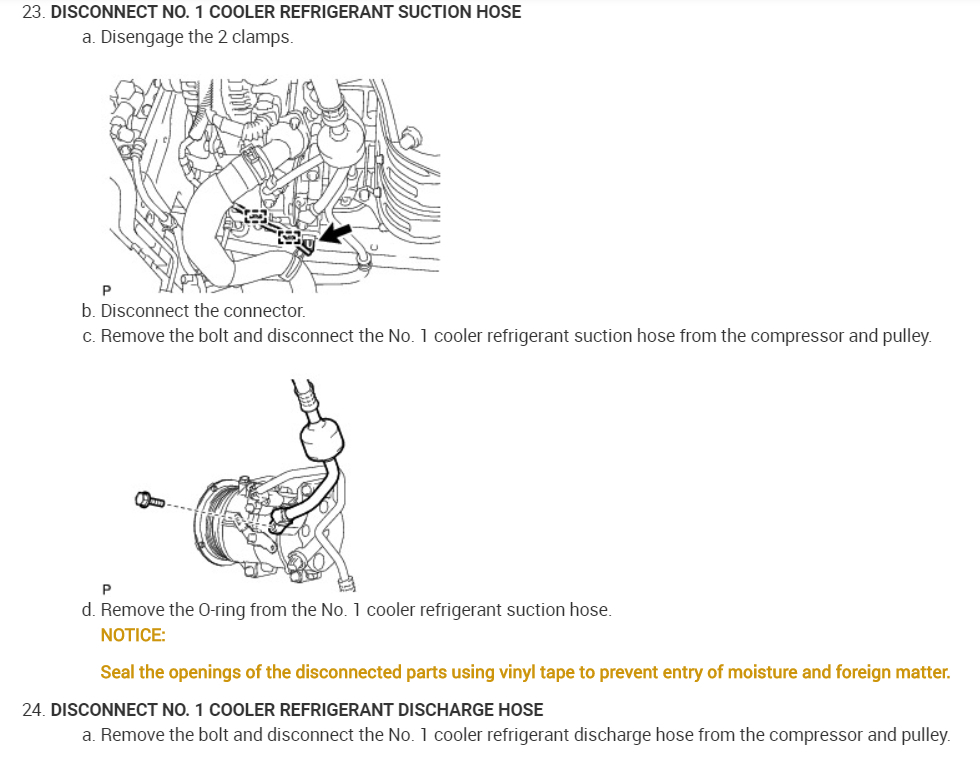

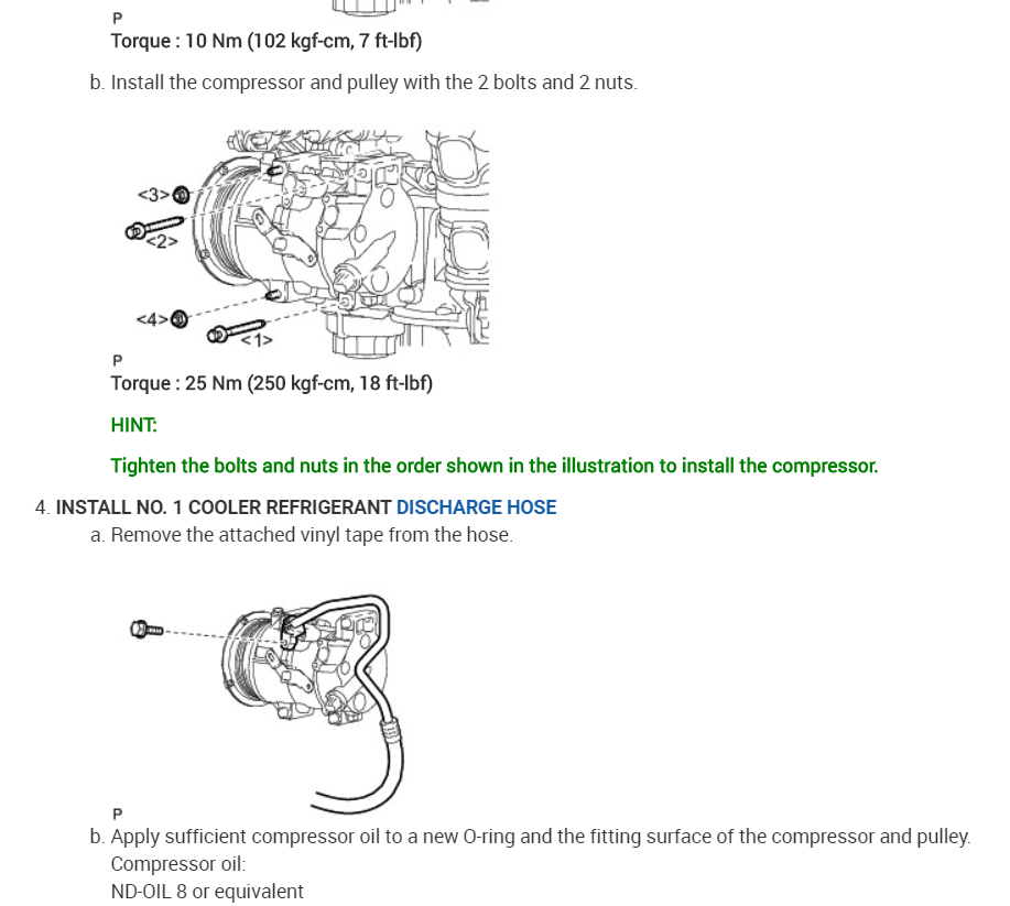

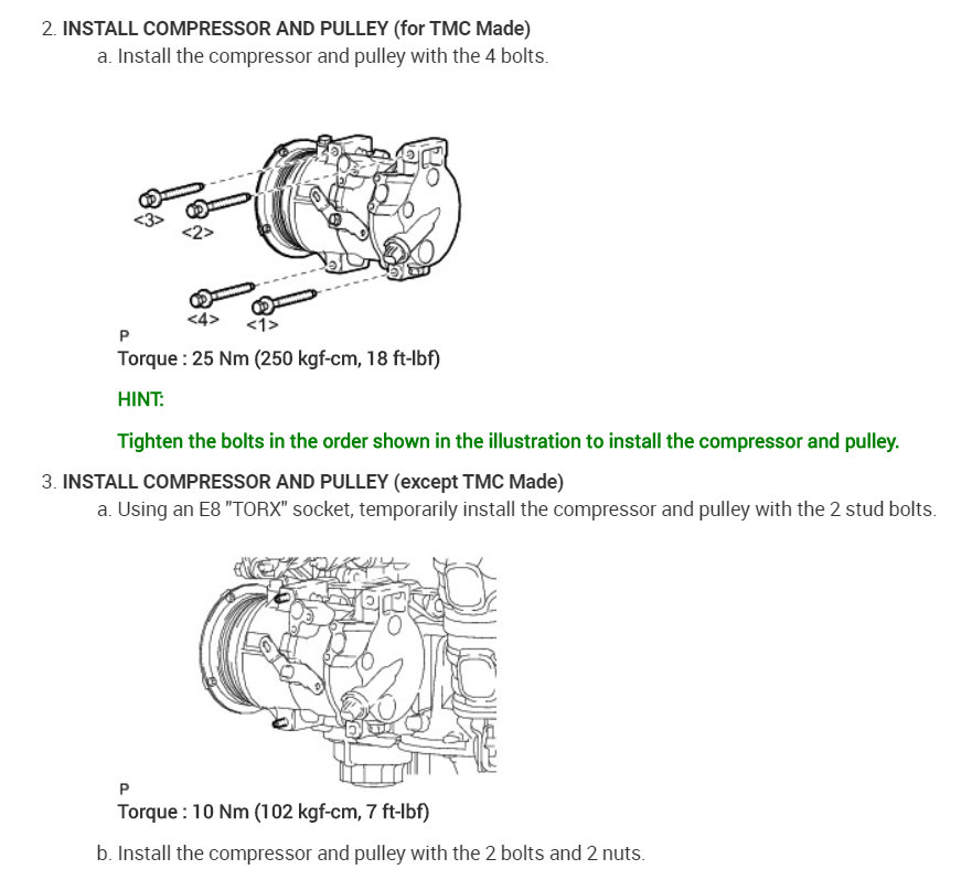

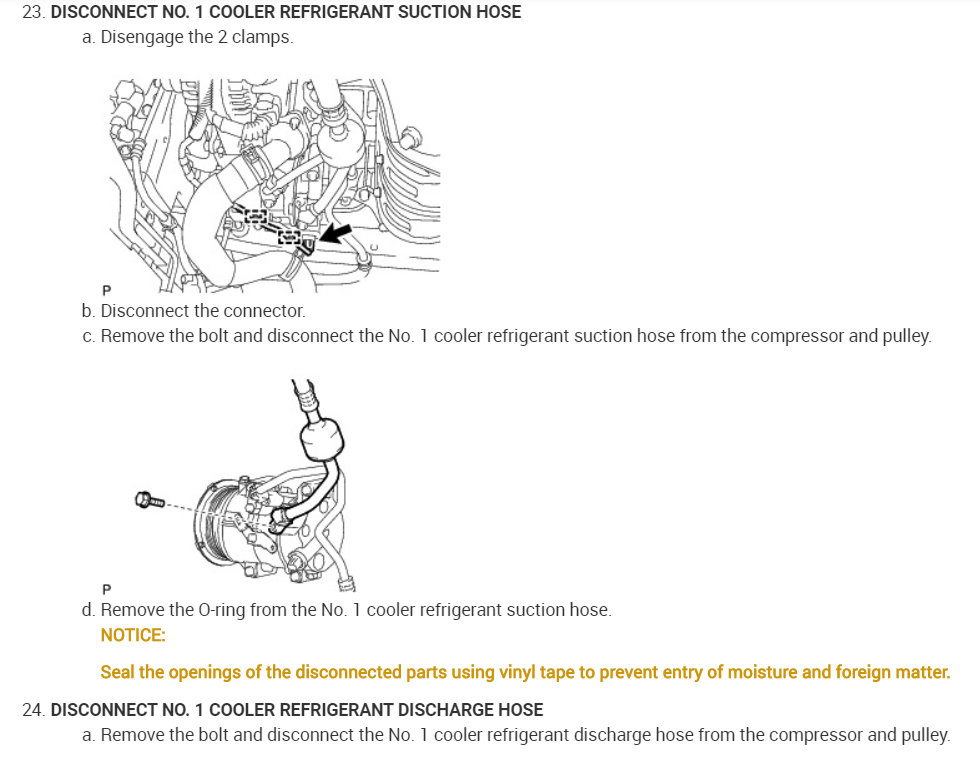

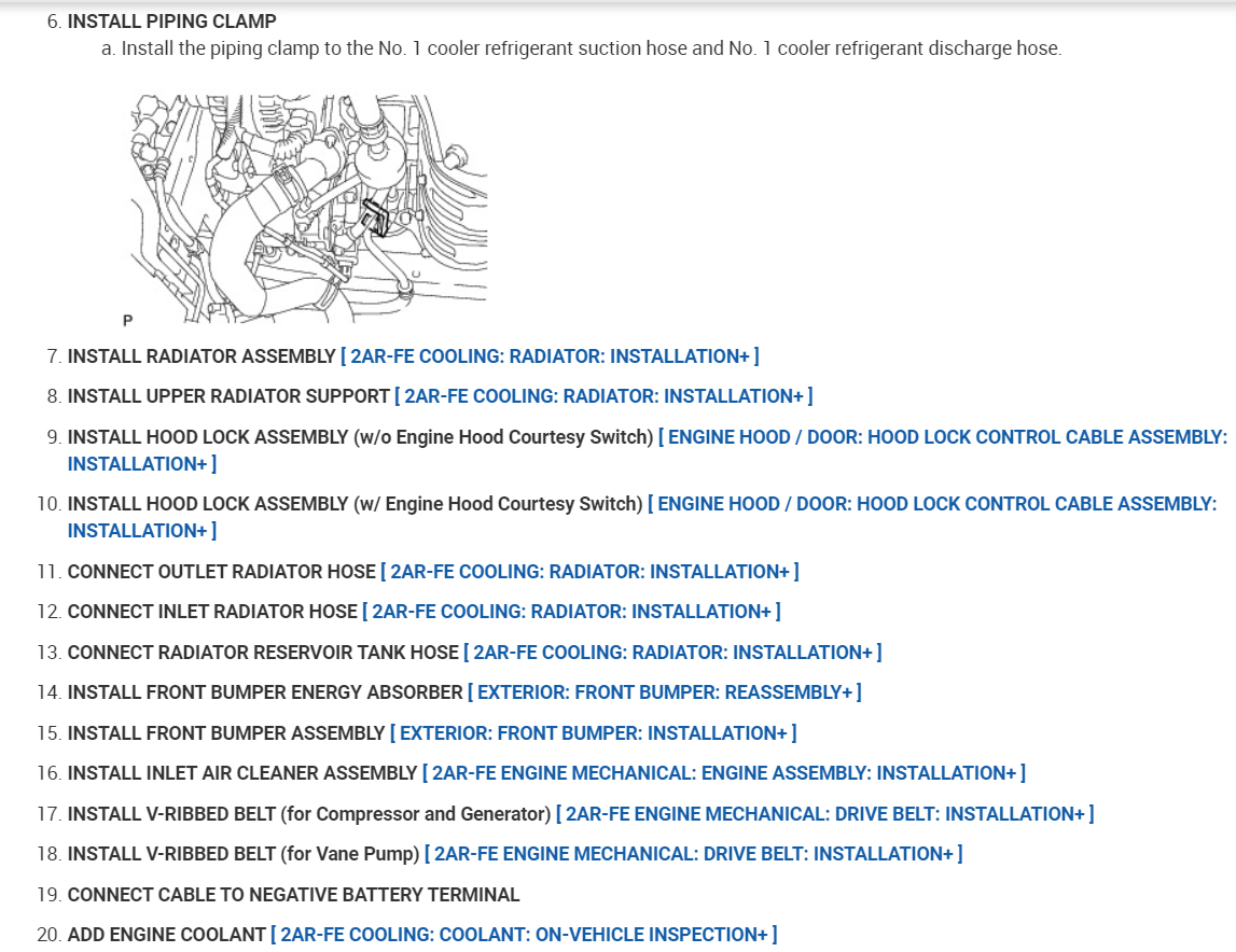

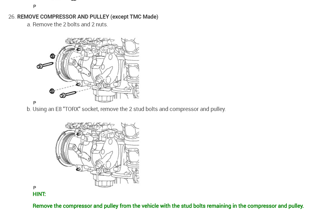

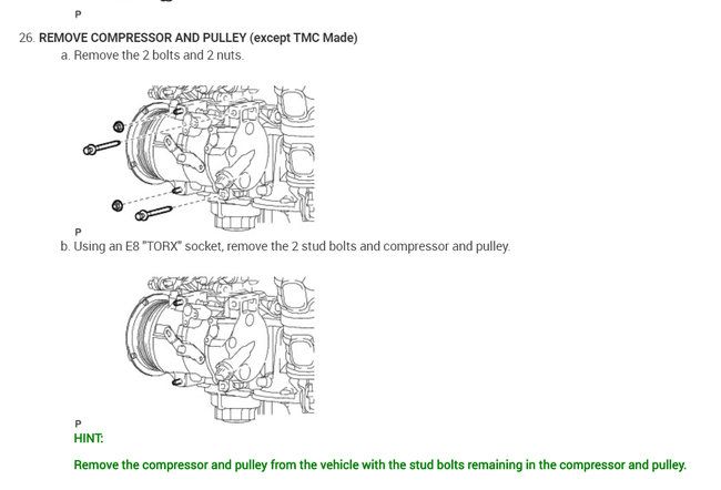

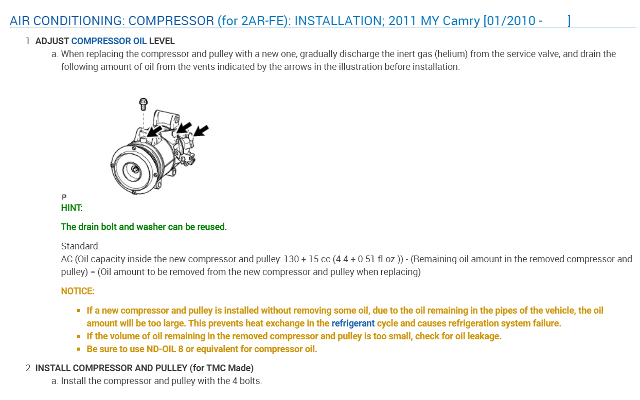

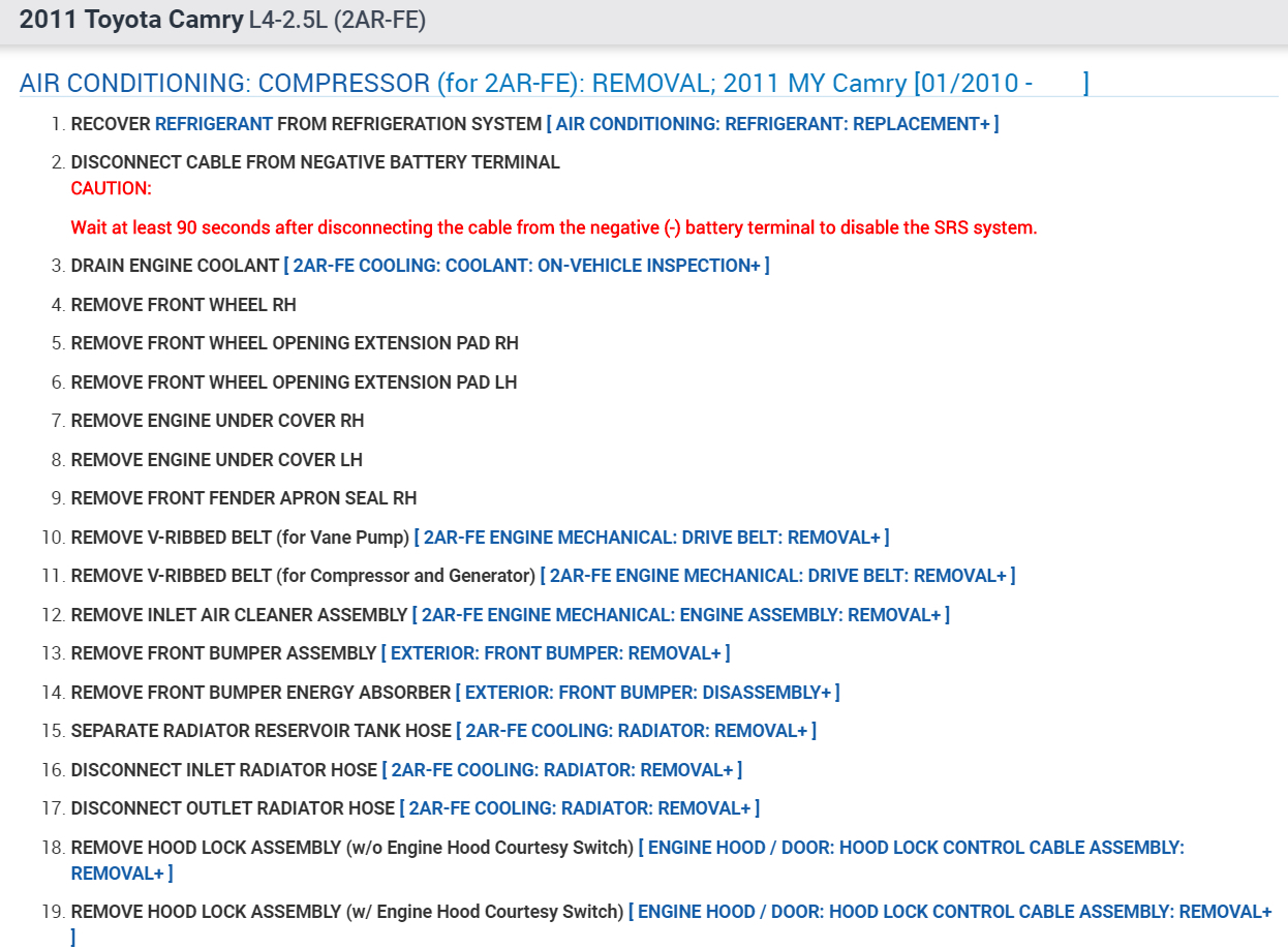

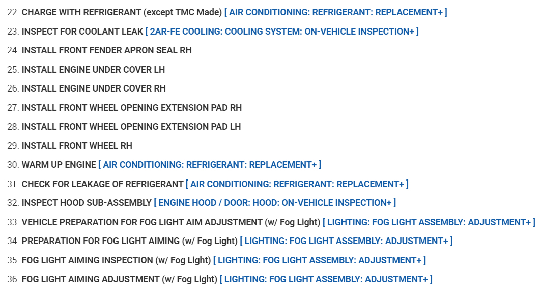

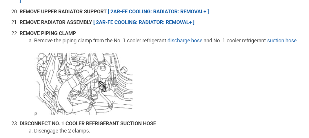

If the system is full you could have a compressor that is going out. this guide will help with diagrams below to show you how on your car:
https://www.2carpros.com/articles/replace-air-conditioner-compressor
and
https://www.2carpros.com/articles/car-air-conditioner-not-working-or-is-weak
