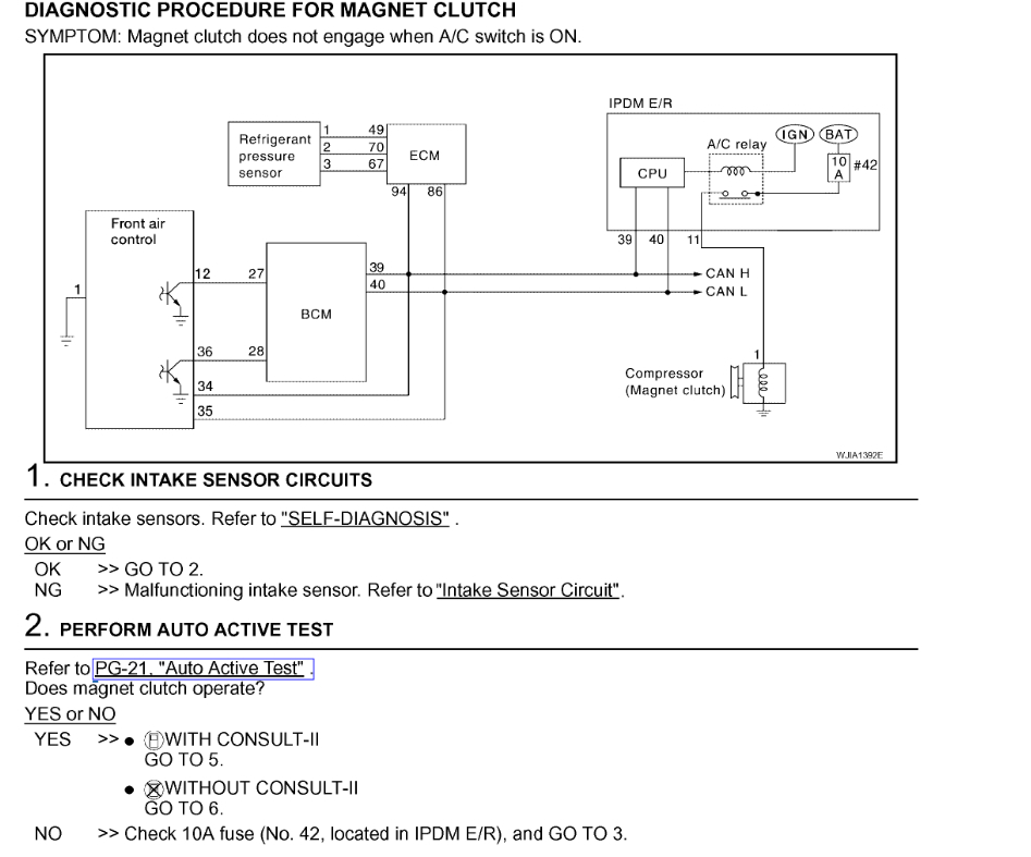

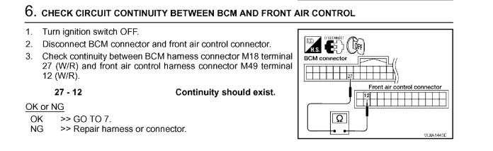

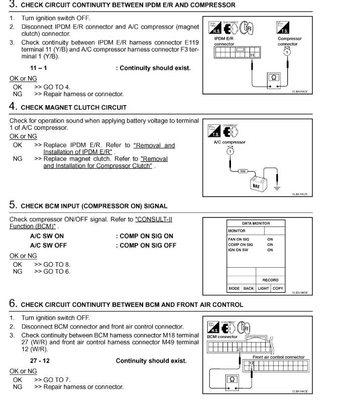

The Nissan self-test IPDM test. Shows that the A/C clutch does work. When you do the test, the clutch does activate. There is refrigerant in the system with proper pressures.
High pressure condenser switch has been replaced. The TCA thermal control amp is also called Sun loan sensor. The one that has that sits in the evaporator box that has been checked and tested with an accurate oh meter of 19,000 homes at 90°F so I think I’ve ruled that out.
The A/C does work and blows cold air. If I run a jumper wire to the A/C clutch without the jumper wire, the A/C clutch will not engage. It’s not getting signal even though the IP DM test shows that it works.
I would think the IP DM test checks, all relays, fuses and sensors, but I don’t know I have checked manually relays and fuses that I am aware of by following the schematic on the fuse box cover.
