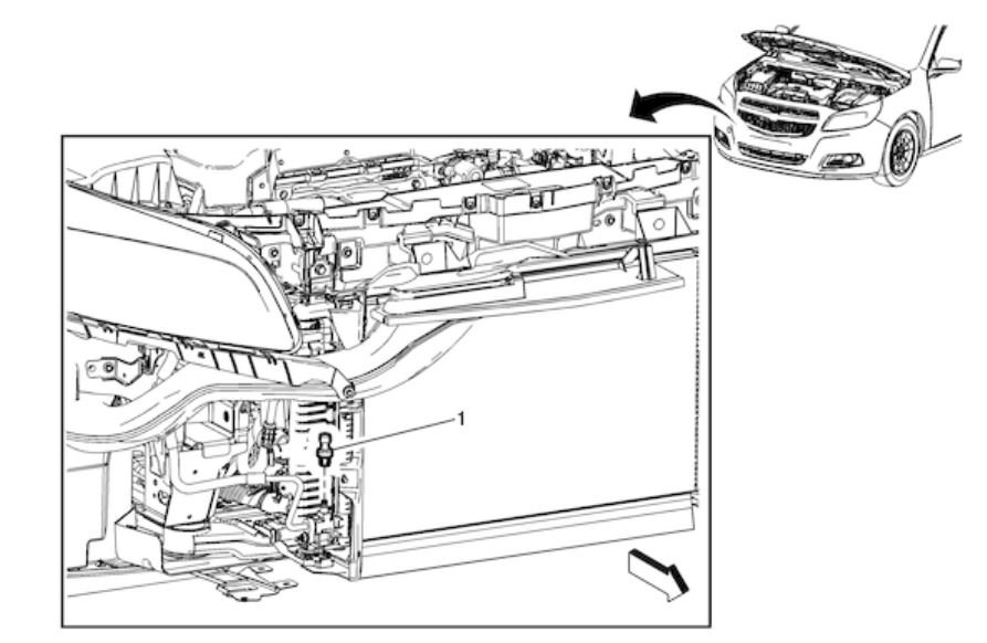

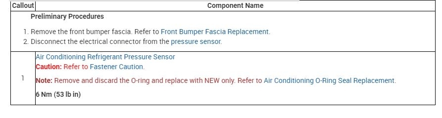

A/C was blowing hot air. I checked the refrigerant, but the level was good. The clutch was not engaging. I took the relay out and "jumped" it, using a paperclip. The clutch does engage. With it engaged I got cool air. It looked like the A/C was being locked out. I tapped the sensor and the A/C began to run. I replaced the sensor. Now the clutch will cycle on and off when the system is charged fully. I was under the impression that the sensor (the one on your picture), was the low pressure sensor. Thinking that a high pressure sensor is now the culprit, I purchased one. I am not sure where it is located.
Did I replace the high pressure sensor with a low sensor? If I did, where is the low pressure sensor located?
Are both sensors included in the system?
