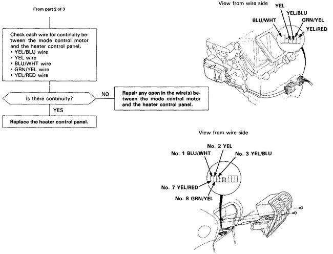

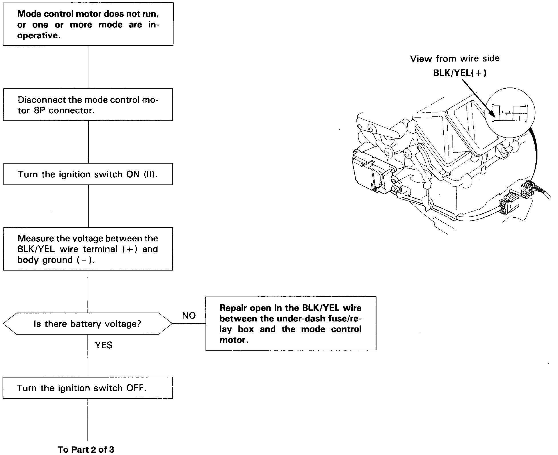

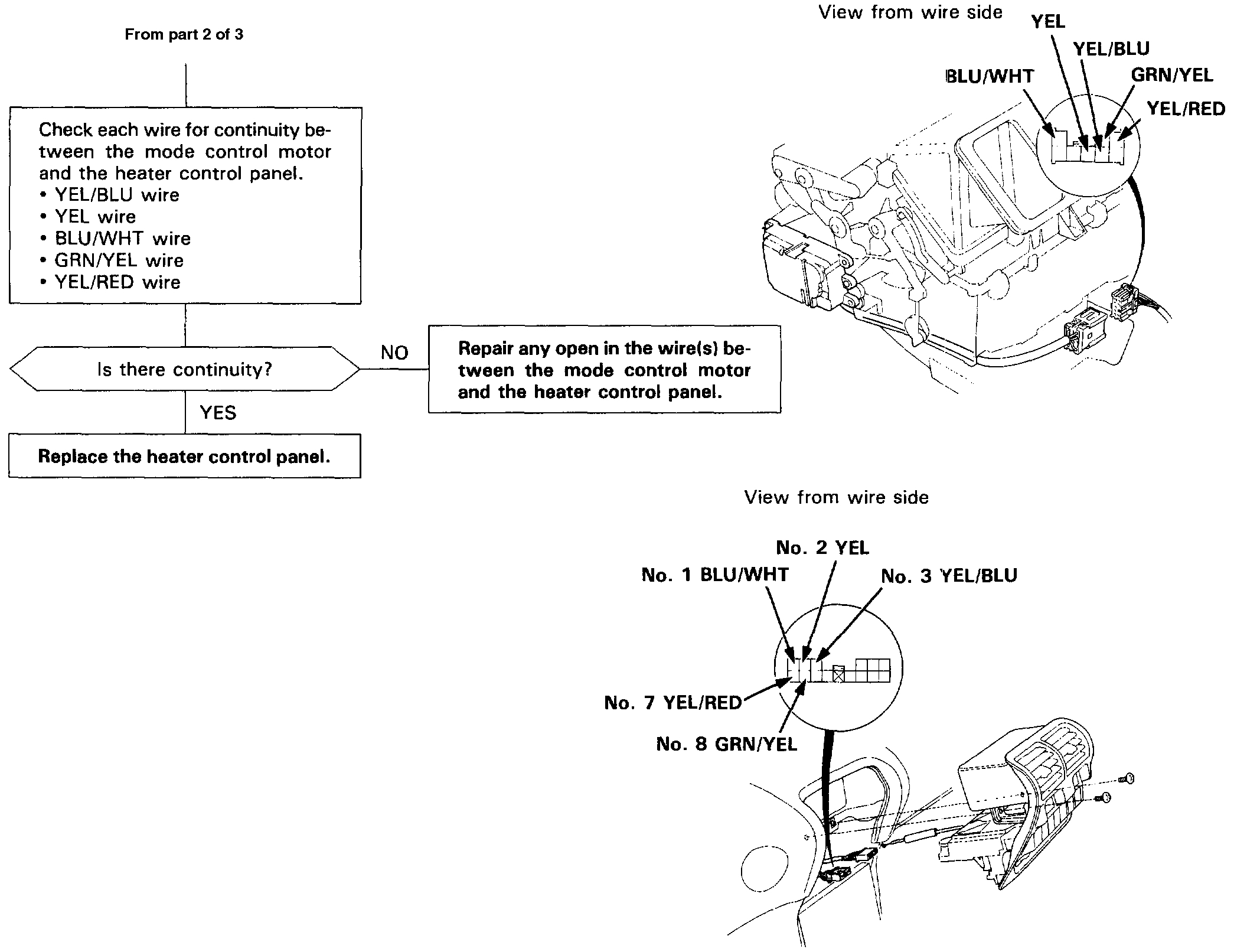

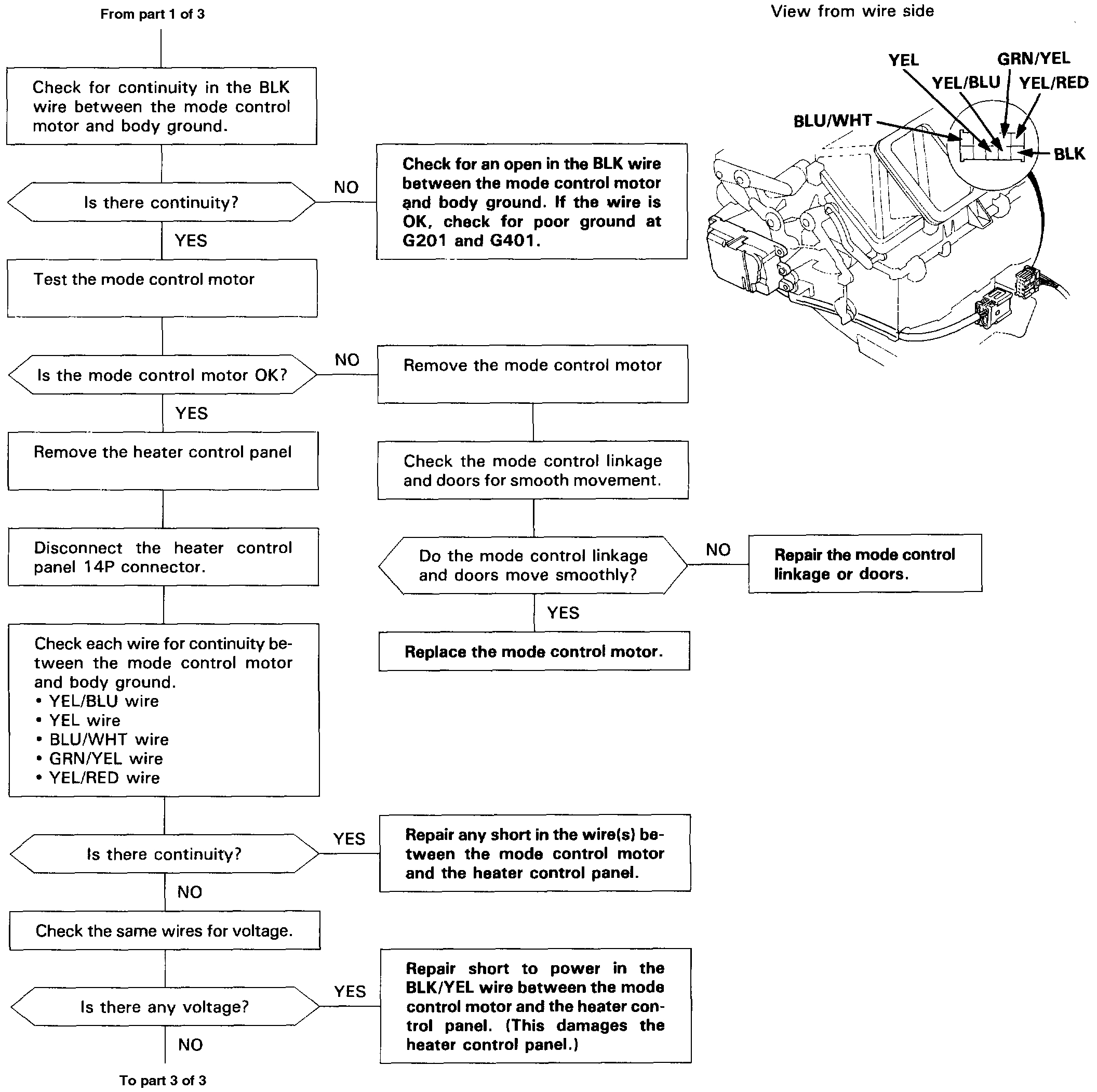

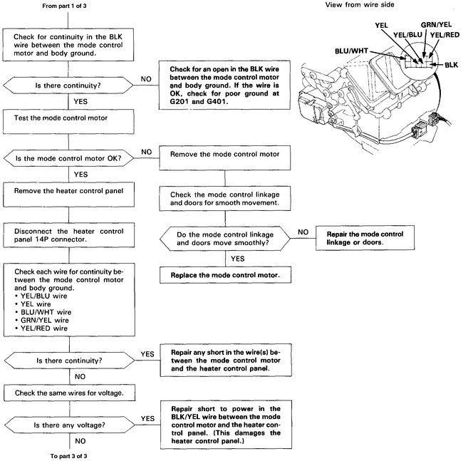

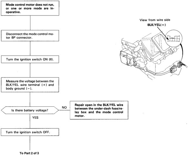

If the panel is getting power, then you need to check the mode door actuator to make sure it is working. It may not be, which would result in no clicking.
Here are the directions for testing the mode actuator. The attached pics correlate with the directions.
2001 Acura Integra GS L4-1834cc 1.8L DOHC PGM-FI
Mode Control Motor
Vehicle Heating and Air Conditioning Air Door Actuator / Motor Testing and Inspection Component Tests and General Diagnostics Mode Control Motor Mode Control Motor
MODE CONTROL MOTOR
Mode Control Motor (1 Of 3)
pic 1
Mode Control Motor (2 Of 3)
pic 2
Mode Control Motor (3 Of 3)
pic 3
Mode Control Motor / Troubleshooting
Mode Control Motor / Test

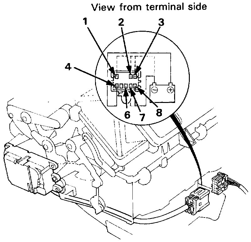

1. Connect battery power to the No. 4 terminal of the mode control motor and connect ground to the No. 8 terminal.
pic 4
2. Using a jumper wire, connect the No. 8 terminal individually to the No. 1, 2, 3, 6 and 7 terminals, in that order. Each time the short circuit is made, the mode control motor should run smoothly and stop.
NOTE: If the mode control motor does not run when shorting the first terminal, short that terminal again after shorting the other terminals.
The mode control motor is OK if it runs when jumping the first terminal again.
3. If the mode control motor does not run in step 2, remove it, and check the mode control linkage and doors for smooth movement. If the mode control linkage and doors move smoothly, replace the mode control motor.
