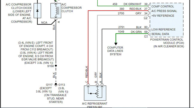

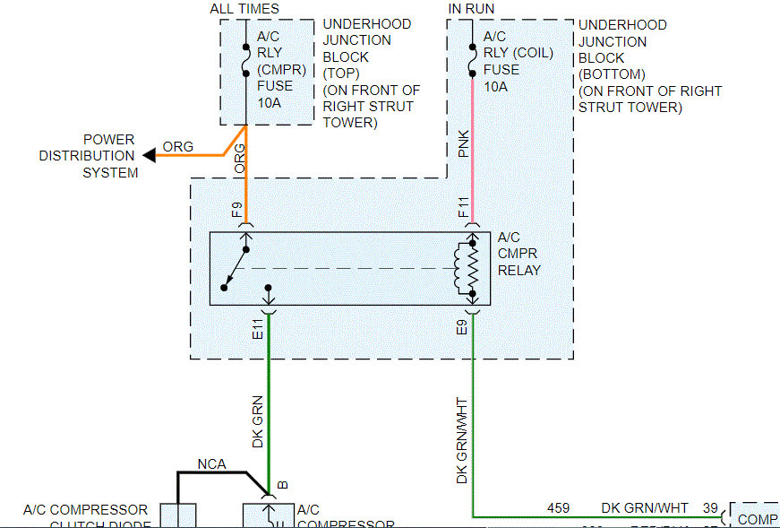

I attached a wiring diagram for you to view. Can you tell me which 10 amp fuse failed?
Jul 25, 2020 at 8:33 AM
KEVINJAMES
Red 10 amp fuse AC/ RLY that's the fuse that burns out . I have a 3.4 liter engine.
Jul 25, 2020 at 3:53 PM
In the diagram I sent, both are marked. Can you give me a fuse number or if it says coil or load?
It makes a difference in the testing and possibilities.
Jul 25, 2020 at 3:57 PM
KEVINJAMES
Coil.
Jul 25, 2020 at 4:55 PM
Okay, can you remove the relay and put a new 10 amp fuse in and test for power to the relay? There should be 2 powers with the key on.
