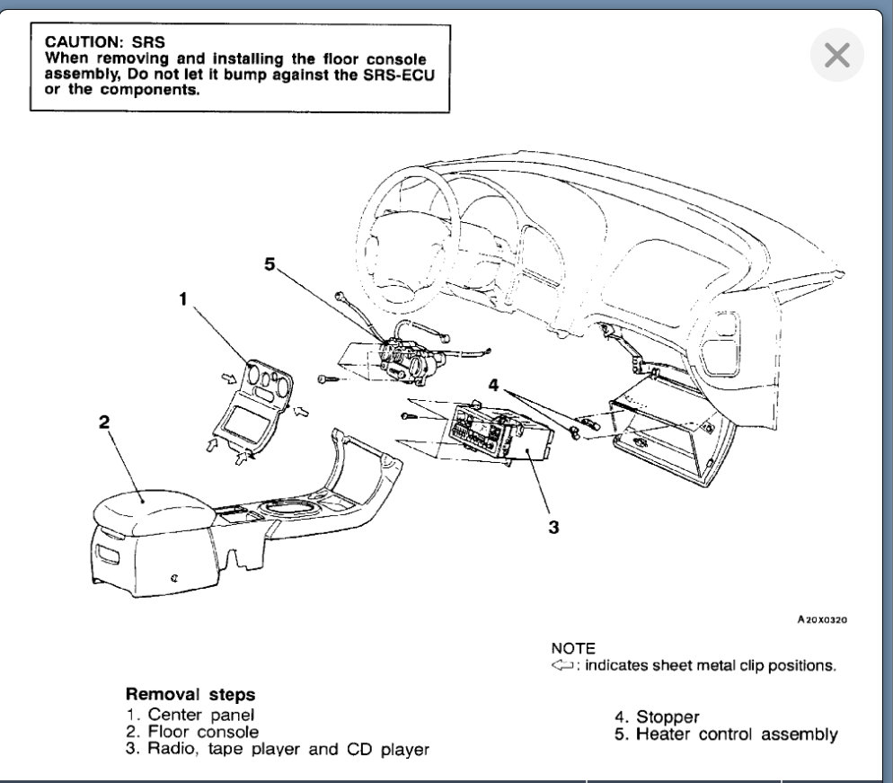

Where is the blend door actuator located?
1998 CHRYSLER SEBRING
80,000 MILES • 2.5L • V6 • 2WD • AUTOMATIC
MICK LANDRY
Is there an easy way to get to it?

Correct me if I am wrong but this has a dial for the heat and cool air, correct? If that is the case then it does not have an actuator, it has a cable and door.
So, if you only have hot air then the likely cause is the Freon or compressor and not the actual blend door.
If this is the case the way to figure out what the issue may be is to start with checking the pressures of the system.
