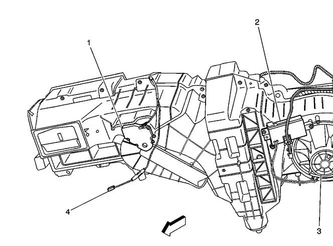

check freon level first it may be low if compressor is running then check actuator in heater as one controls temp, remove hvac fuse for 60 seconds then reinstall with key on. it may reset after a minute if not the actuator may not be working. generic pic included.

So the A/C normally works really good blows hard and cold, but for the second time in two months it has went from blowing cold to hot while driving. If I stop and turn it off then turn it on, it will go back to blowing cold.
What gives, I was thinking one of the actuators maybe?
Apr 30, 2021 at 2:11 PM (Merged)
Yep the blend door actuator go bad in these trucks, here is an excellent guide that will show you what you are in for when doing the job.

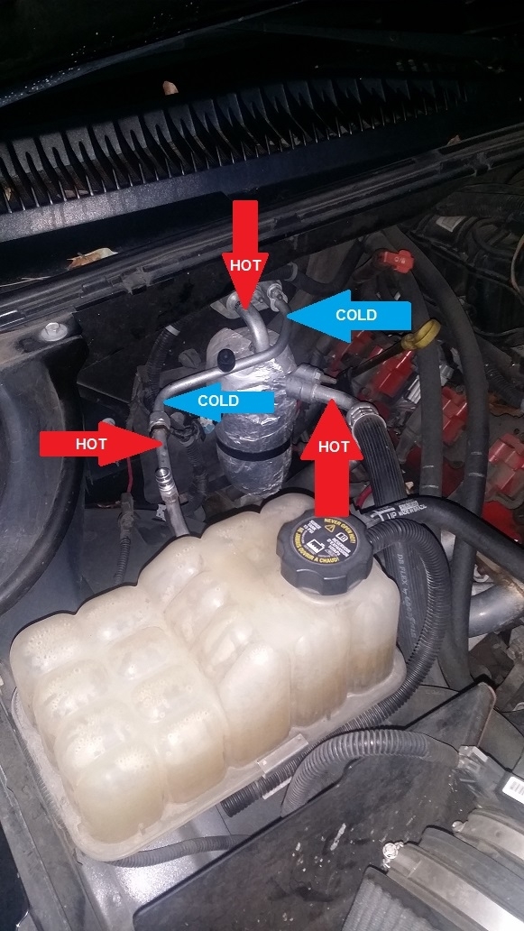

One day the AC was working great and then the next day it was blowing hot. The compressor is cycling on and off. I checked the inlet blend door actuator and it seems to be working, I say this because as I turn it from hot to cold I can feel the actuator turning when I place my finger on it. I jumped the low pressure switch and still no cold air. the compressor is clicking on and off, not sure if it is doing it too fast or not because I am not sure how fast that cycle is suppose to be. I put a gauge on the low side, the only gauge I own is from one of those cans you buy from the auto part stores, and the gauge fluctuates back and forth from side to side. I also reset the AC control module by taking out the fuse and following a outlined sequence of turning the key on and off. Also, last year the system was vacuumed down and the orifice tube was replaced. Not sure if this will help but at the accumulator one line is cold and the other is not.
I need some guidance as to what could be the problem. I would like to try to fix it on my own if I can so I can save the money of going to a shop.
Apr 30, 2021 at 2:13 PM (Merged)

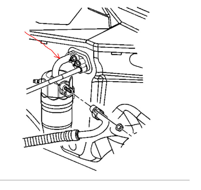

You have a large tube exiting the fire wall and then headed to the rear of the compressor. With the engine running and the system on use your hand and see if the tube is cold at the fire wall. This will help us see if it is a blend door problem or a compressor issue.
Here is a diagram (below) and a guide that can help:

I ran the truck and turned the A/C on and have attached a picture of the lines and where it was hot and where it was cold. I hope this helps you help me. thank you
Thanks for the images :)
Yep a classic case of the system being low. I suggest you using a gauge set though so you can see what the high side is doing which is more important.

So does this mean there is a leak in the system? I know the system was vacuumed down and recharged last year to replace the orifice tube. It should not have to be added to every year does it?
It does sound like you have a leak because you should not have to recharge it more than every other year.

Hello, sorry it took so long to reply back but I did find the problem. There was in fact a leak. Seems that when it was serviced some dirt got into the valve where you add refrigerant. I noticed there was a puddle of what looked like green fluid. I contacted the ac shop and the guy had me come by and said yep that's where dye was added and is leaking out of the system. he put a new valve in and charged it for 30 bucks. blowing cold as ice now. thank you for all your help!
