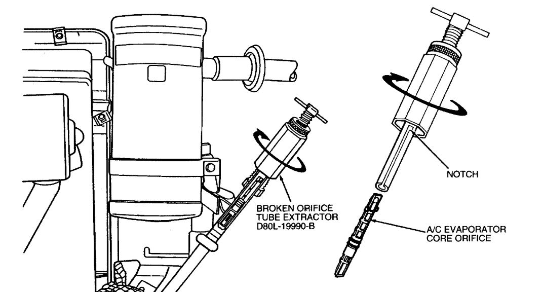

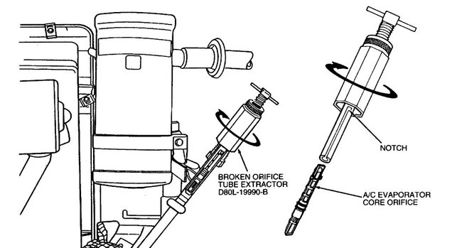

The low side is the issue. It is too high. It should be 25-30 lbs. 42 is rushing the Freon through the evaporator too fast and that means cool, not cold air.
The fact the static is not the same confirms it. They should be exactly equal.
You need an expansion valve and a dryer.
