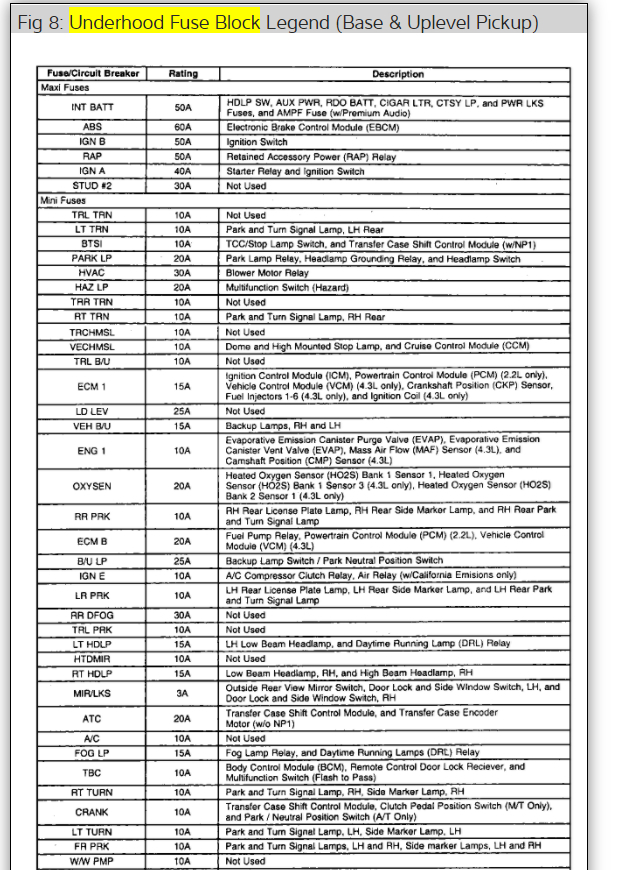

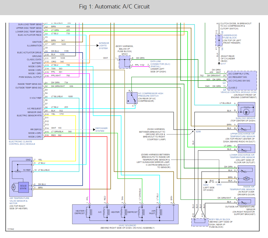

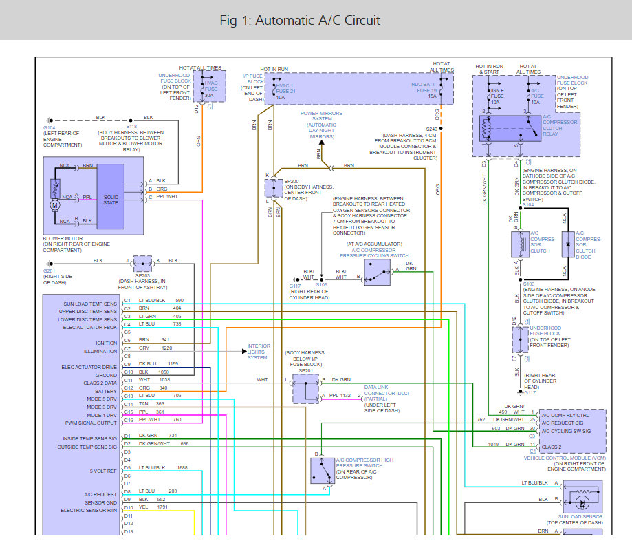

No air from vents and the inside has no pawer but air con works because I hear clutch on.
Jun 19, 2022 at 5:18 PM

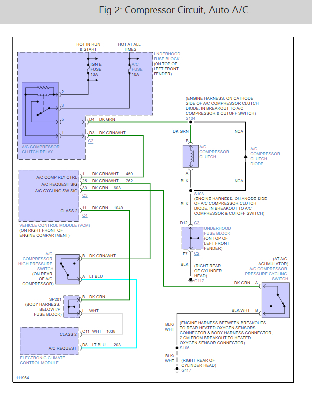

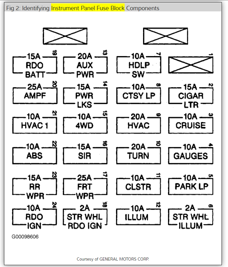

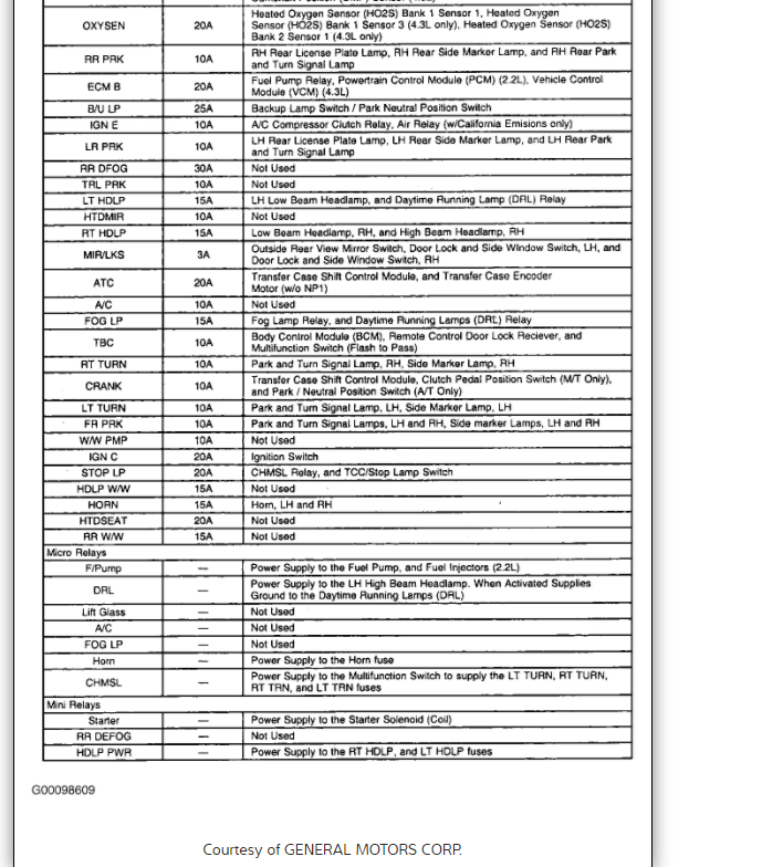

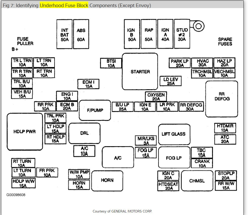

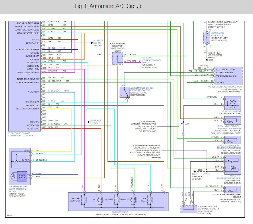

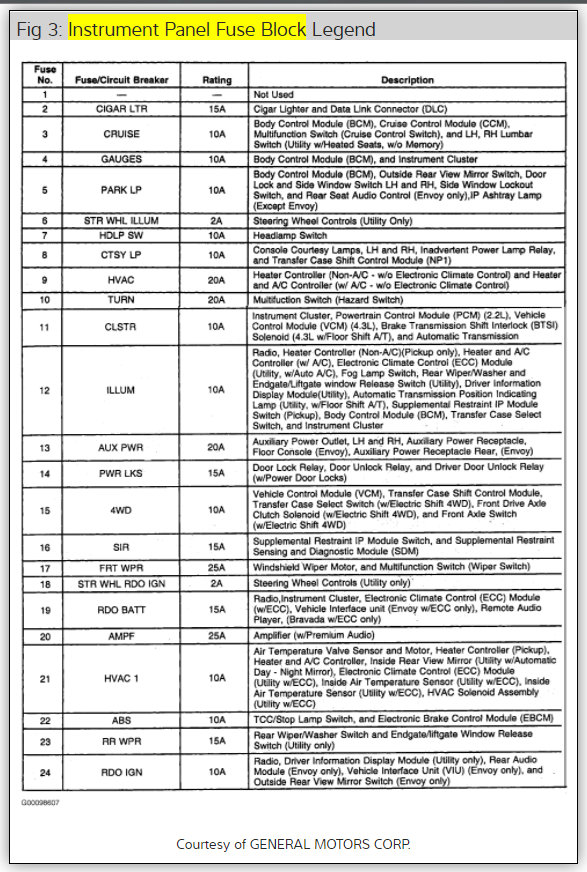

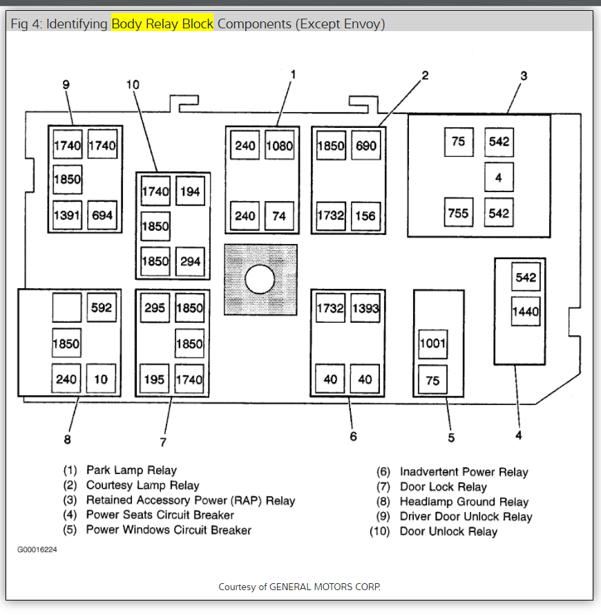

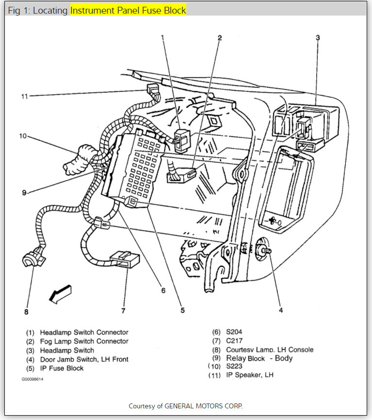

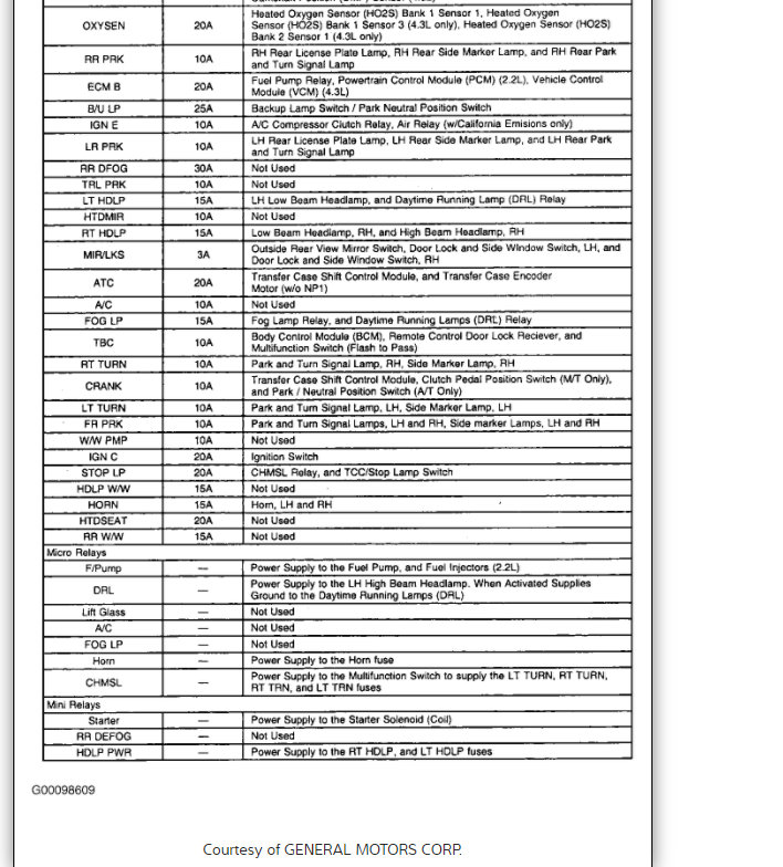

This can be a bad fuse, or the HVAC control unit is out, let's start with the fuses. here is a guide to help and the fuse (HVAC, HVAC1, RDO Batt) locations. Here are the A/C wiring diagrams so you can see how the system works:
