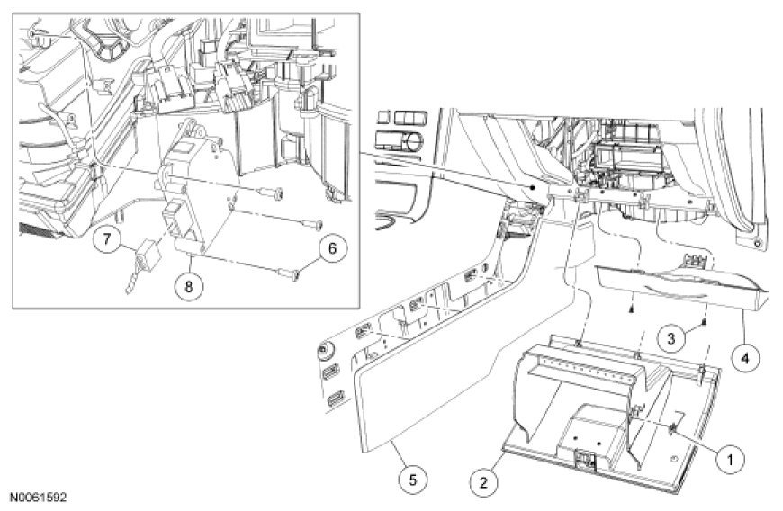

There is at least one. If you have the electronic split system there are two temperature actuators.
In the picture is the left hand actuator. In the manual system this is the only actuator. In the automatic system this id the drivers side unit.

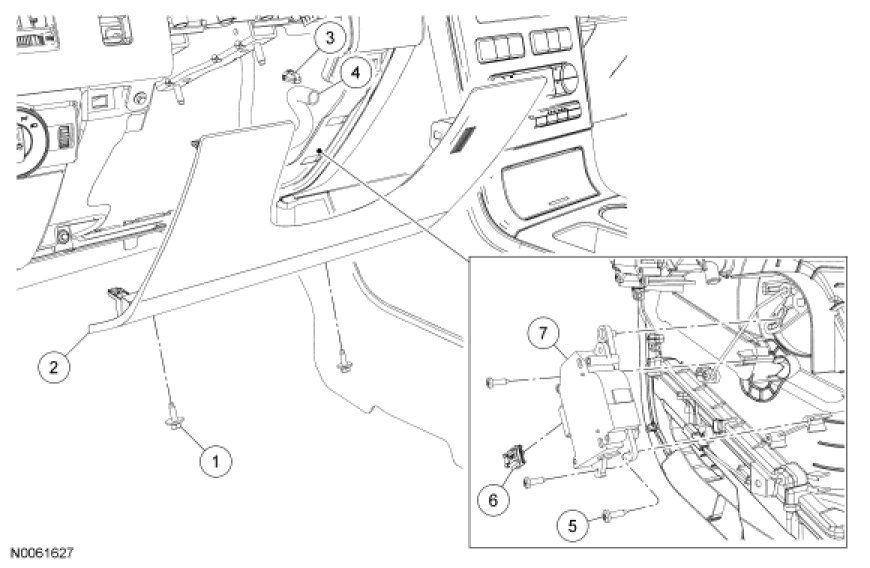

If you have the automatic system the second picture is the right hand actuator that services the passenger side.
Both are very easy to change compared to other makes.
