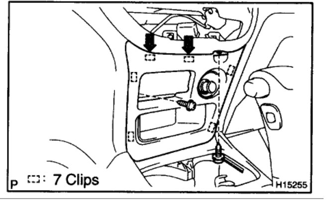

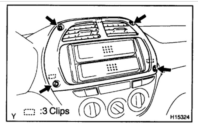

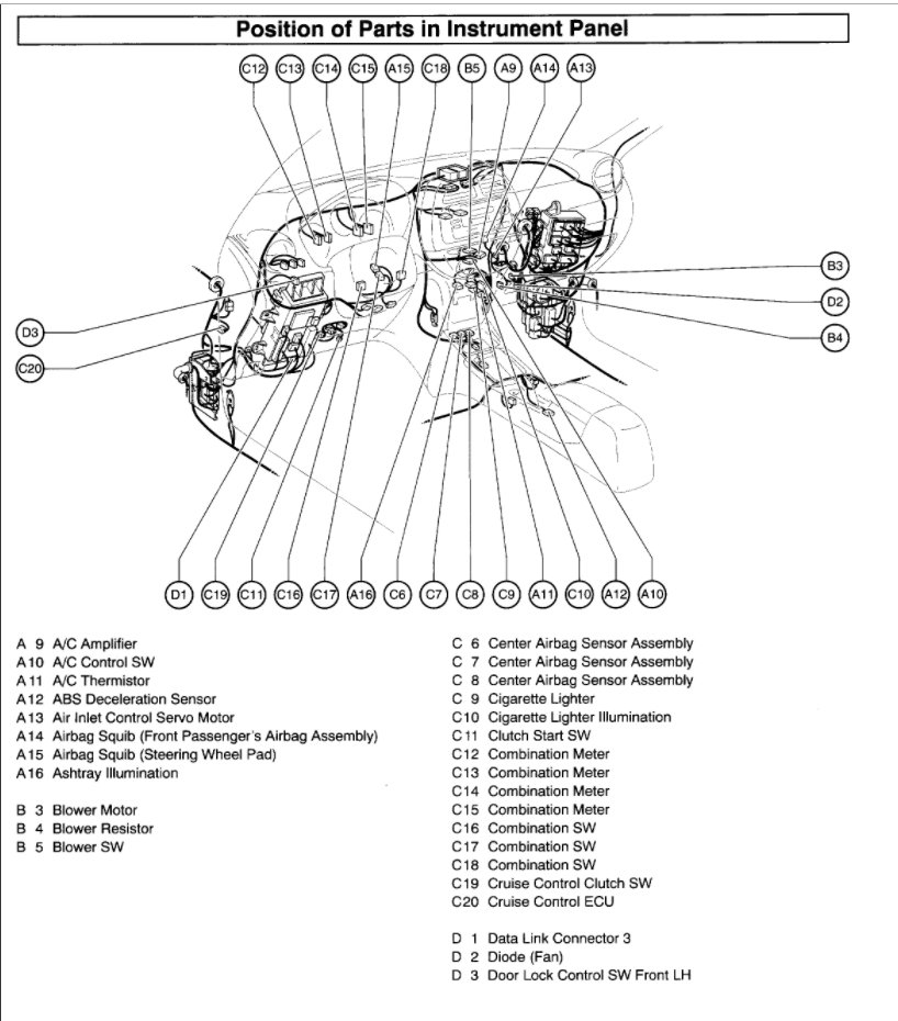

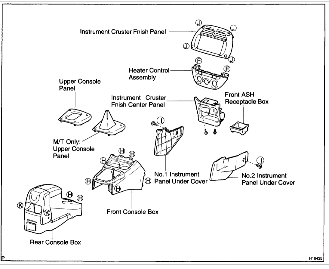

It sounds like the switch has gone bad and needs to be replaced. Here are some diagrams (below) that can help you get the problem fixed.
Please let us know what happens, we are interested to see what it is.
