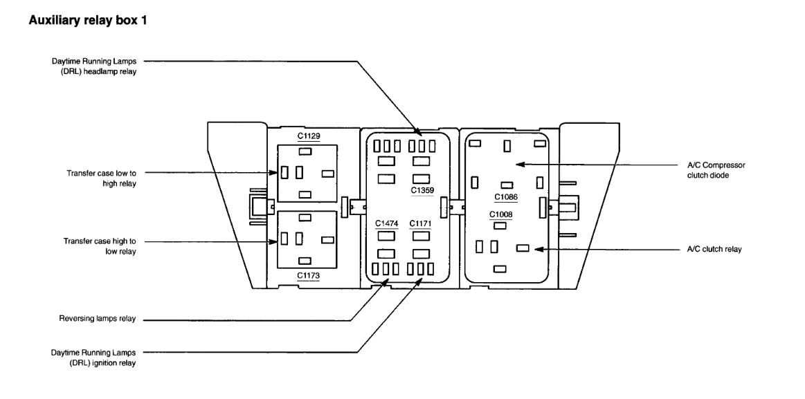

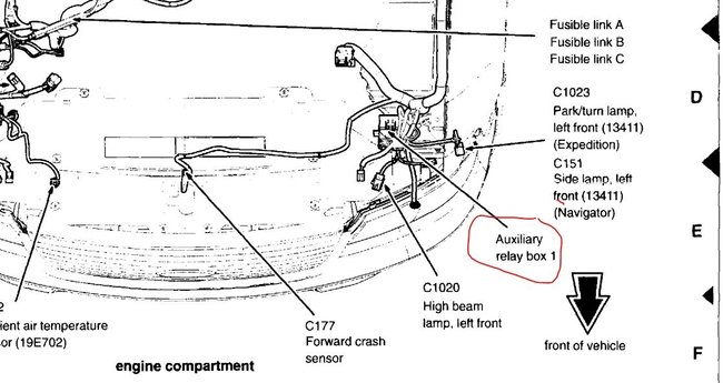

I attached the location of the relay in the relay box for you.

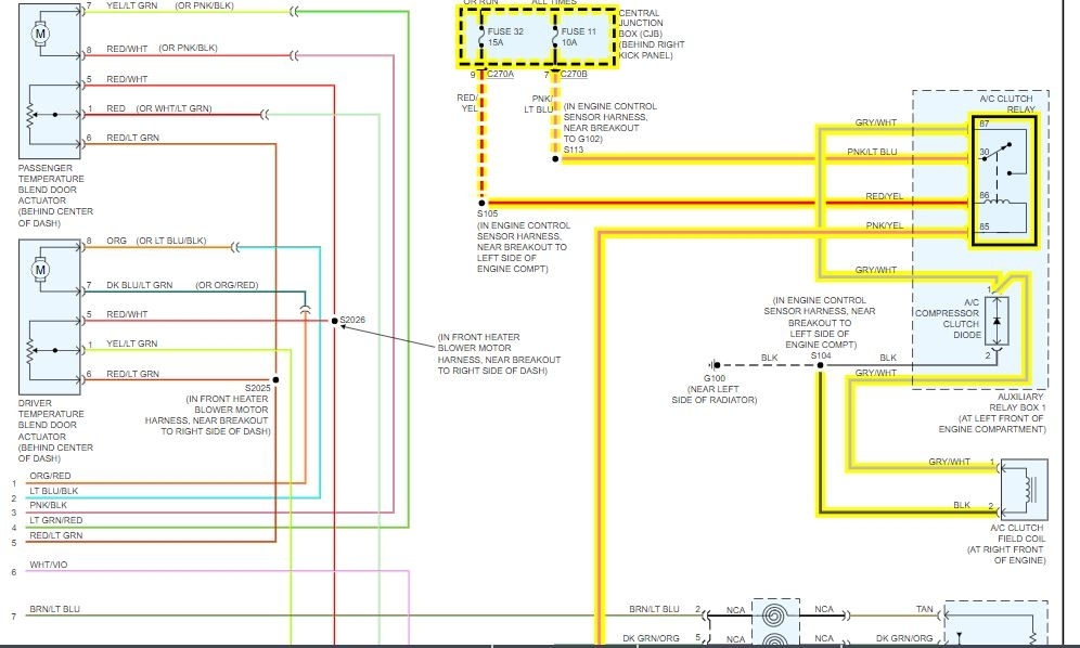

I attached a wiring diagram of the compressor circuit for you as well. If you have a test light or voltmeter, we can do some testing to find the fault.
