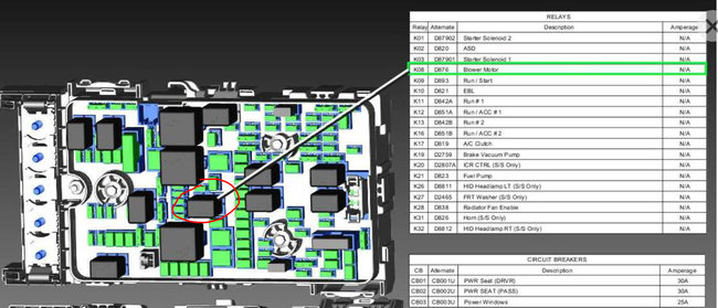

When you open a window, chances are you are just feeling air naturally flow through the system. The problem seems related to the blower motor. Since it does turn on at times, then it isn't a fuse issue. At this point, we need to determine if power is making it to the blower motor when it refuses to turn on.
First, locate the blower motor relay in the under hood power distribution box. See pic 1. See if there is another relay with the same part number and switch them to see if that makes a difference.

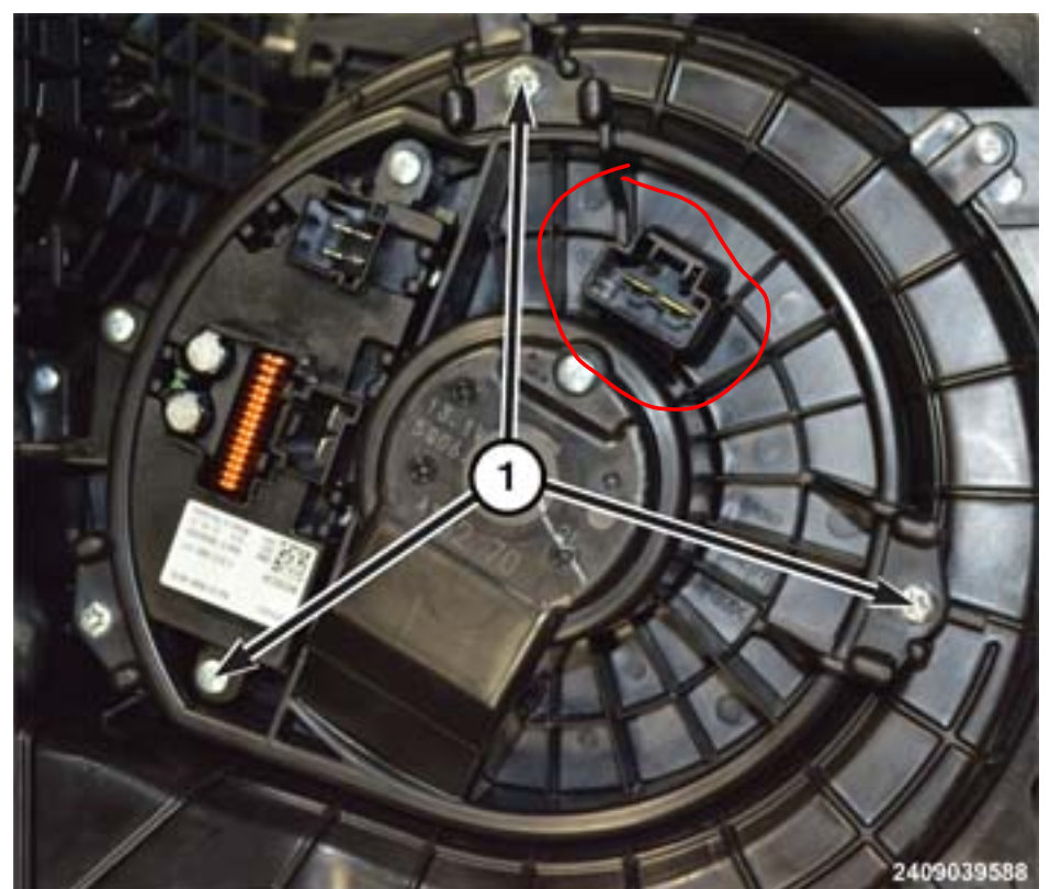

Next, on the bottom of the blower motor is a power module. You will need to disconnect the connector I have in pic 2 and check to see if there is power to the motor when you turn the blower motor on.
If there is power, suspect a bad blower motor. If there is no power, then I suspect the power
module may be bad.
