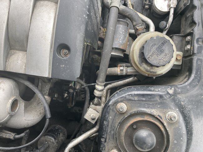

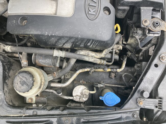

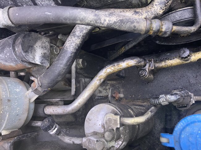

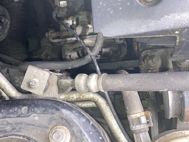

Here is what the passenger side of under the hood looks like. I don't know if this could help, I'm not too good/knowledgeable with cars.
Jul 1, 2023 at 12:42 PM
The idea that you notice it when you press and release the gas leads me to think it is related to a belt-driven accessory under the hood. It could even simply be the AC compressor.
If you are parked with the AC on, can you make it create that sound without driving? If you can, open the hood and have a helper gently press and release the throttle to see if you can hear it under the hood.
