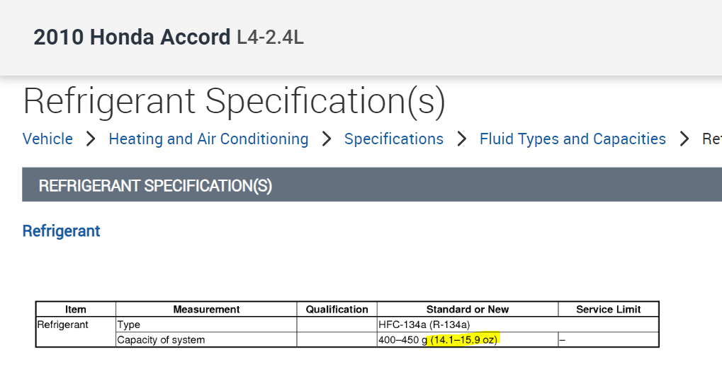

Hi, the car listed above is an LXP. The car is a 1 owner car. I bought it new, and it always has ice-cold air conditioning. It still is ice cold at times it just turns cool. The compressor engages I was only able to take low side readings it is approximately 30 lb or less. Gauge needle is steady I checked the condenser for blockage, and it is clean in front. My question is, can it be my expansion valve? Freon low? Are these cars known for a problem intermittently? I also noticed the compressor does not cycle on and off even when the air conditioning does not get as cold as it should. It has happened a few times and I must say it is when it is more humid out. From the low side readings, I am getting I suspect I am just a little bit low on freon. But will not add until I can get an answer about a possible expansion valve problem. If it was an expansion valve problem would I be running higher or low pressures? Blend door seem to be operating properly. Thanks any help is appreciated. Have a great day and hope you enjoyed the 4th. Neil
