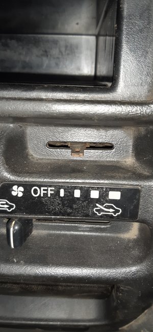

i cannot find fuse or relay for blower fan.

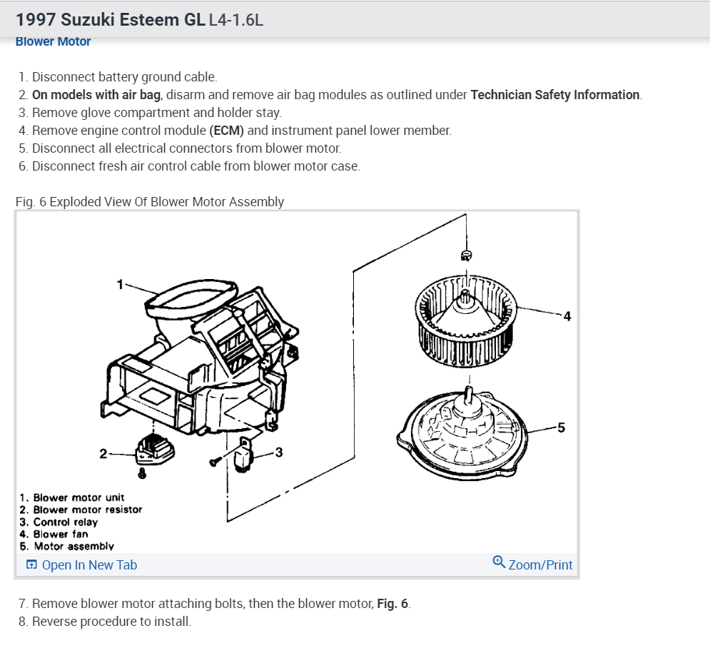

Here is the location of the blower fan relay with a guide to help test it:
Check out the diagrams (below). Please let us know if you need anything else to get the problem fixed.

I mean this fan. i don't have positive on this switch where is the relay or fuse location to check it? Thanks

I updated the post above to reflect the blower motor information please recheck.
